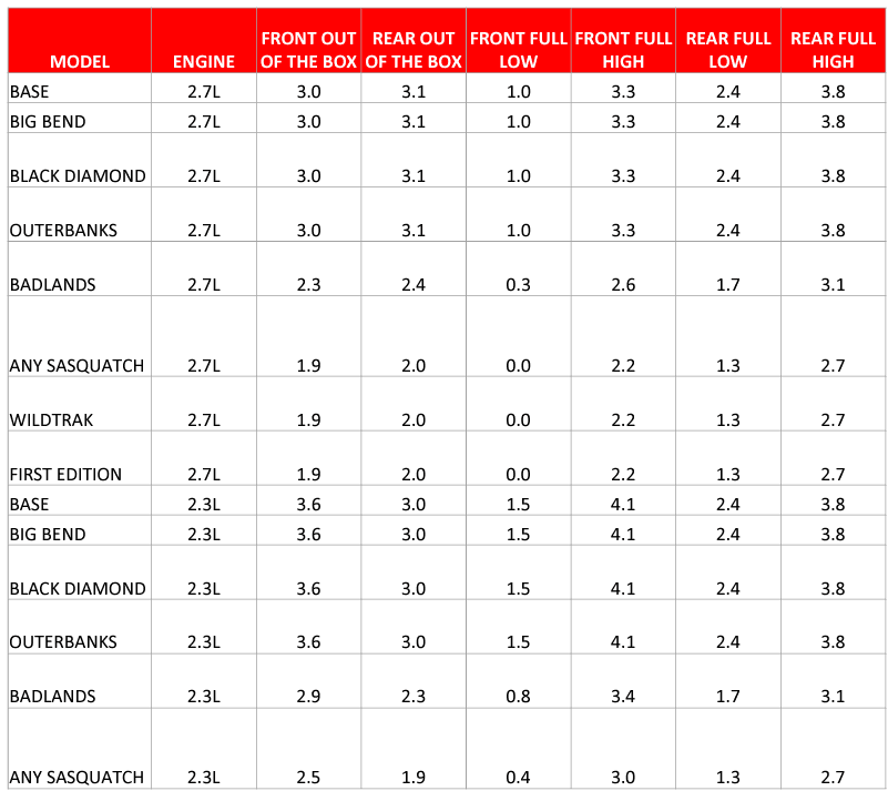

The stock UCA's are actually pretty good. On a friends rig we lowered the fronts and ended with 2.25" lift at the front of a 2-Door OBX and we lowered the rears almost all the way. Alignment was able to be brought in spec with the stock UCA's.
Ford Bronco Help adjusting Eibach coilovers 1706717464340
Thanks for the reference points to work off of! I’d rather be a little low than a little too high to save CV angles and replacing other components prematurely. So your guys help is appreciated!
