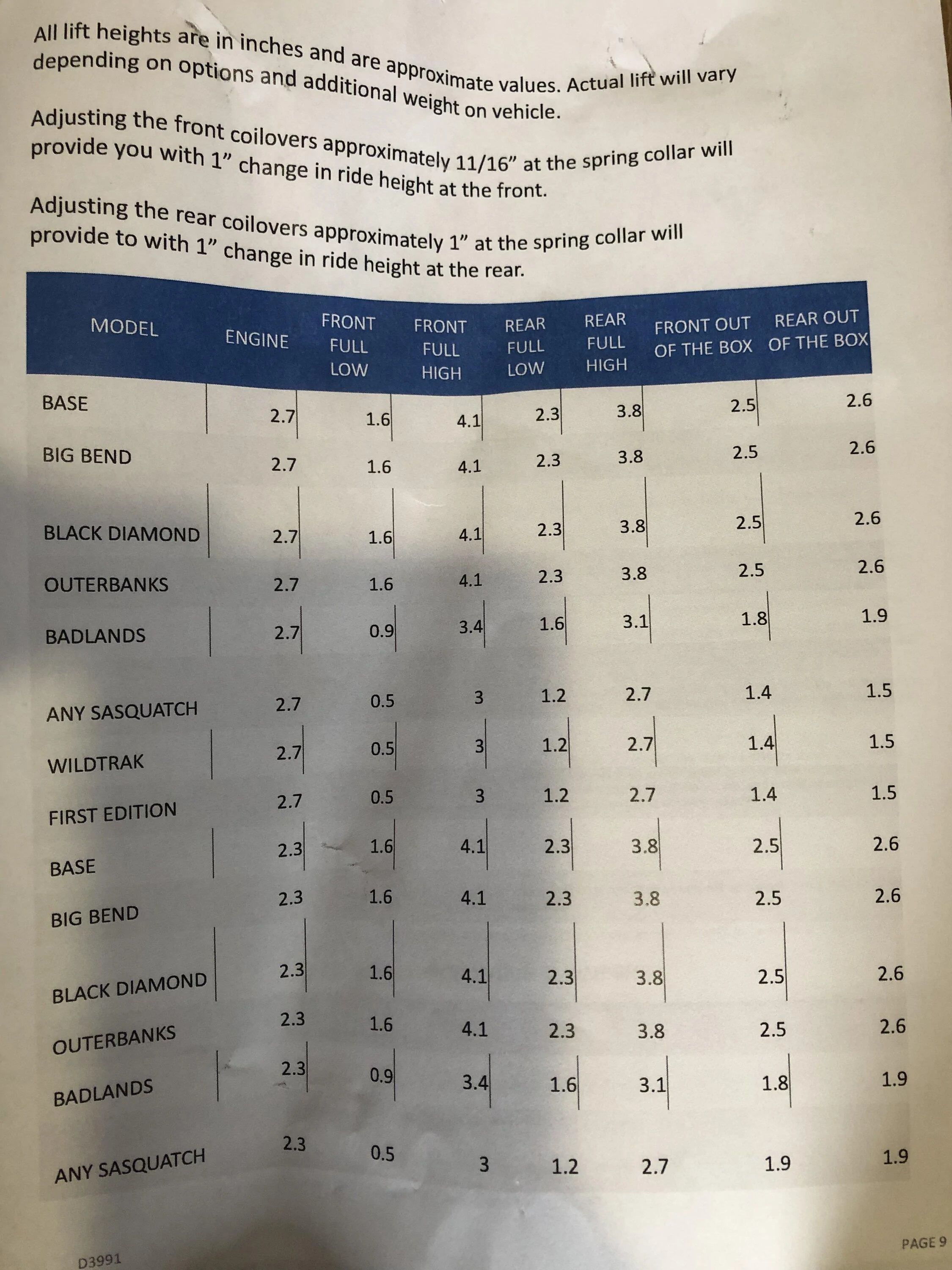

So if a guy only needs to level his Bronco due to adding a winch and bumper I imagine these will get the job done for the front. My question is can the back be installed without adding any additional lift. According to the manufacture it looks as if it is about 1.5" minimum lift to the back.

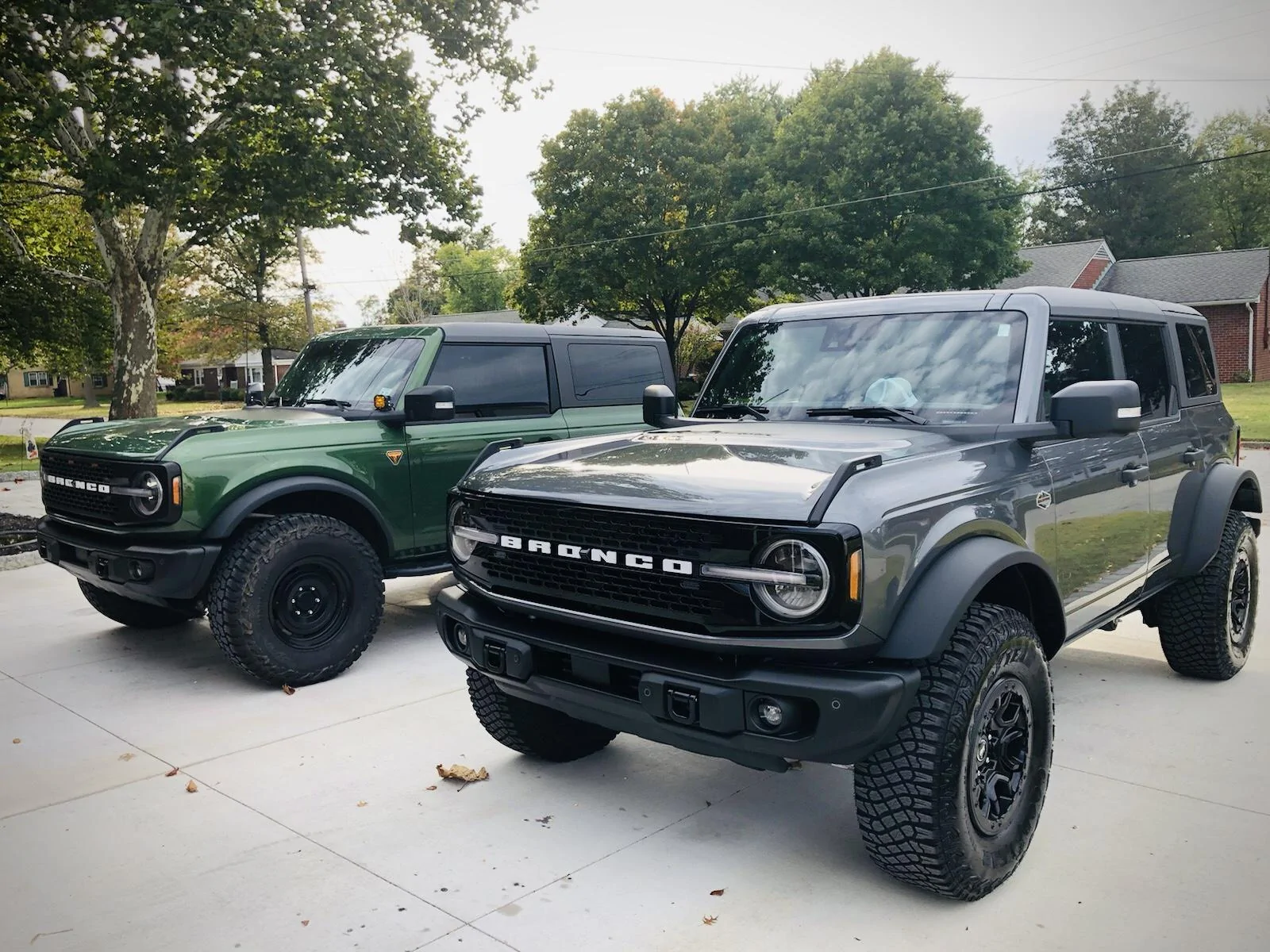

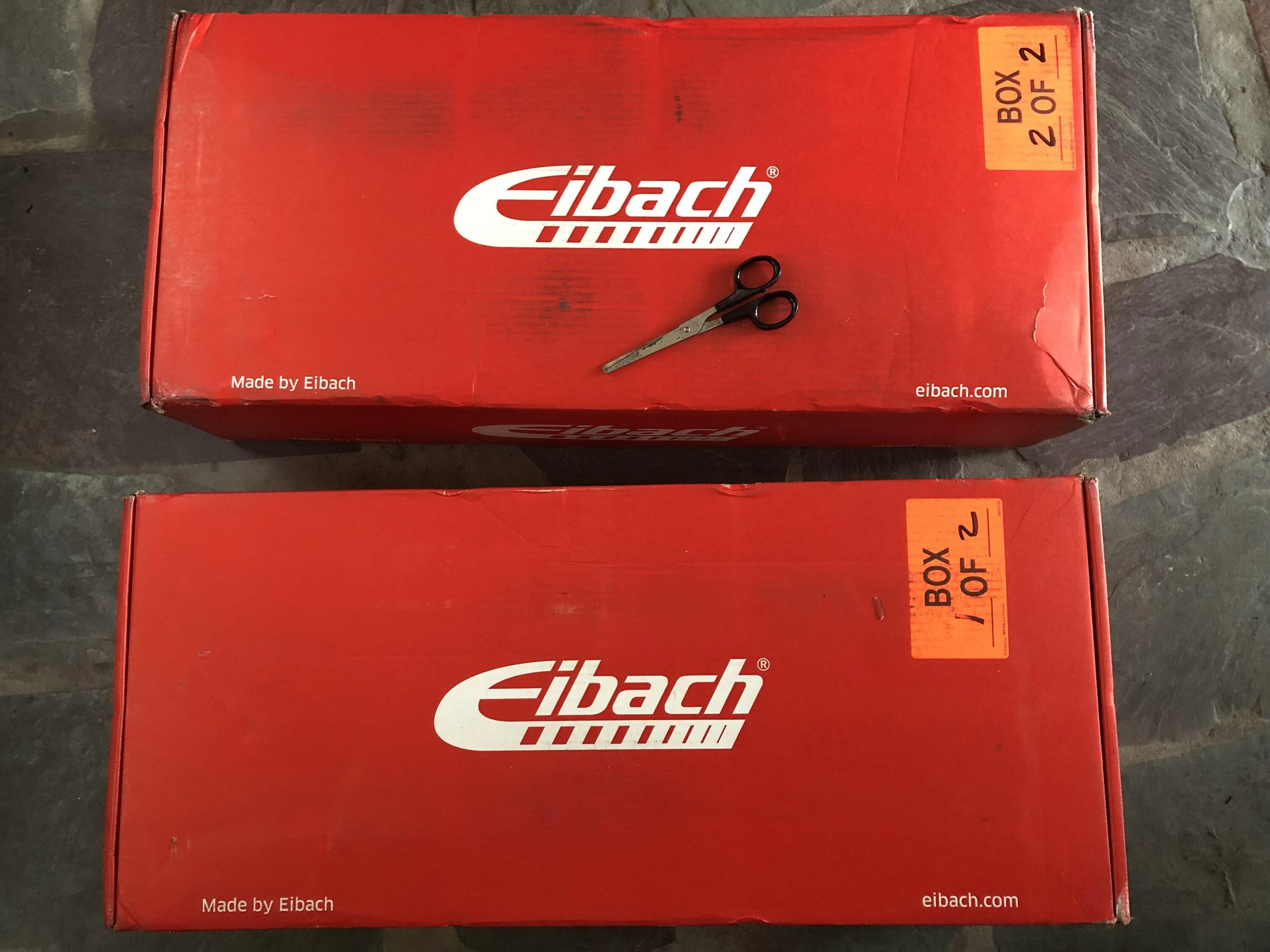

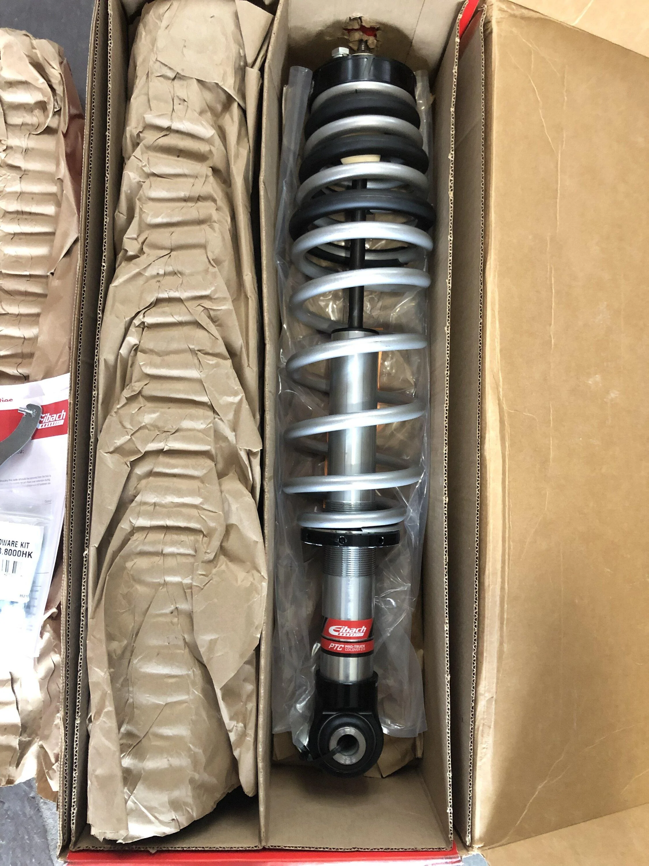

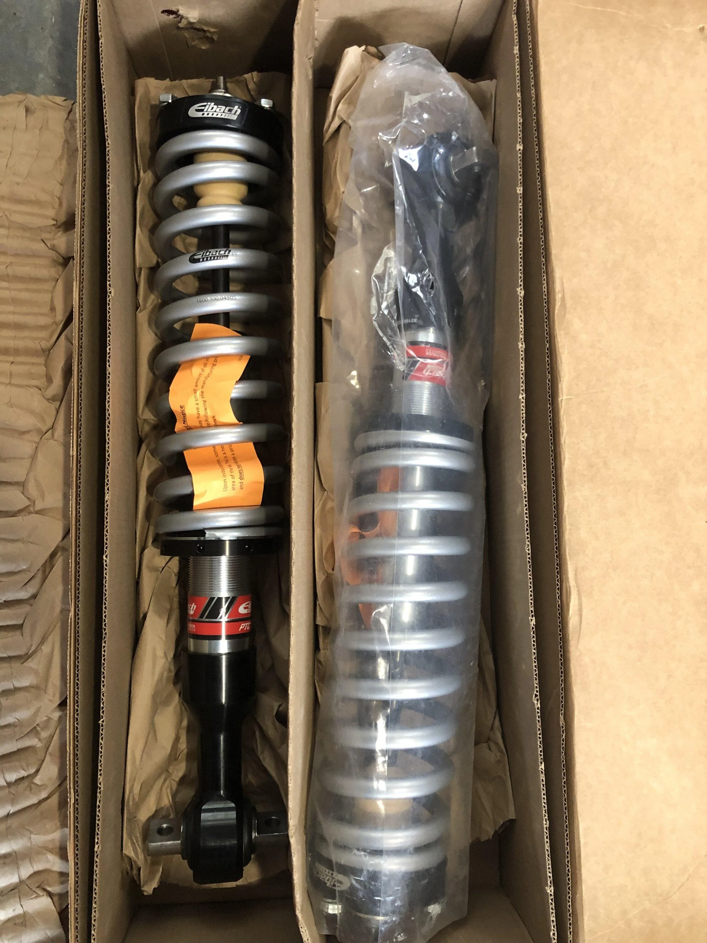

Will do! Let me if anybody wants measurements before I install them.
Itā€™s going to be a few weeks, Camburg is waiting on parts for the UCAs. I installed the ProCal tune on the 2.3l yesterday and updated my tire size. Iā€™m going to stick with the 35x12.50 MT A/T for a while. Crazy theyā€™re the same weight as the 37ā€ KO2s D Range.
I think these are going to fit the quality, function and price point for my goals perfect. I am concerned about sacrificing any OE road/ride quality, but these look real nice. Weā€™ll made. Solid. Iā€™ve used their products on track/street cars and have been happy. I expect the same here.
Iā€™m sitting on the NonSAS HOSS right now. No lift all OE. Next to the wife's Wildtrak HOSS 3.0 for comparison. Iā€™m going to try and get as many real world before and after measurements. Right now frame point to frame point she only sits 1/2ā€ higher. However her fender height is substantially more.

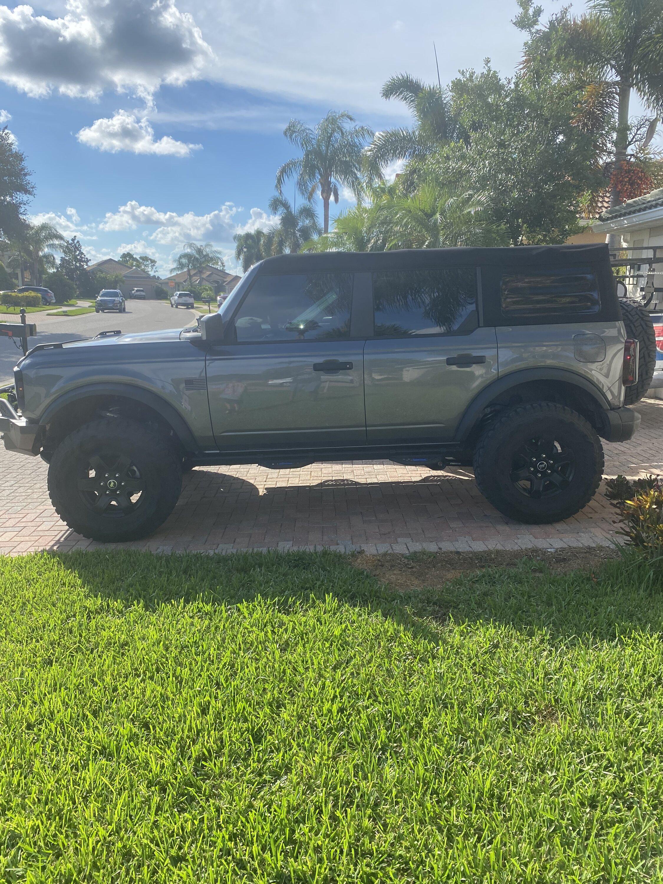

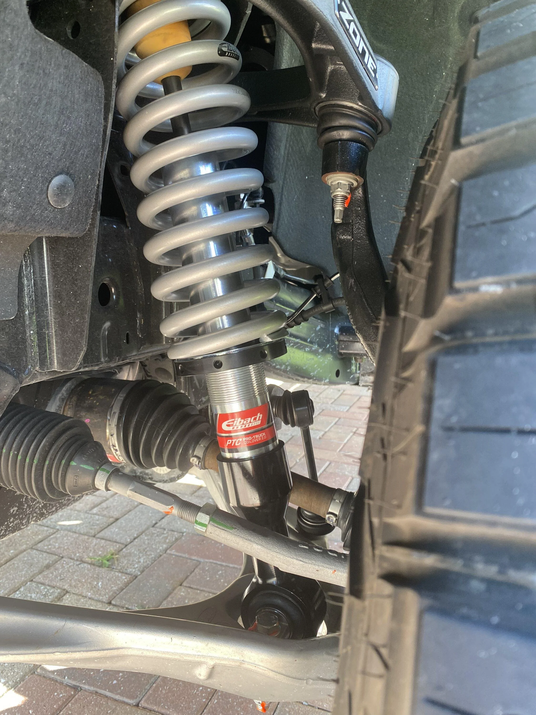

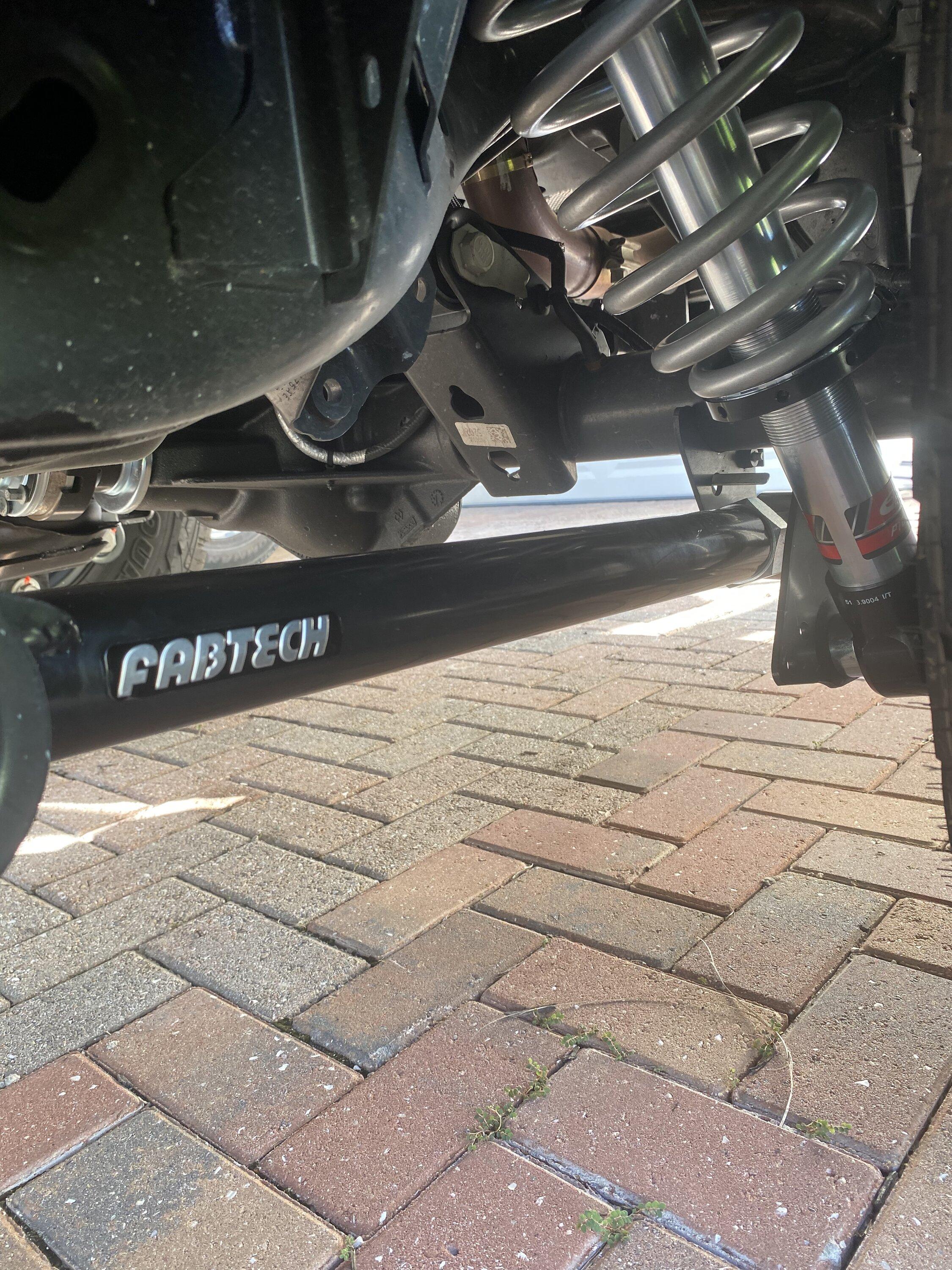

I love them and the ride quality is much better than factory. Also got 3ā€ of lift with them without sacrificing ride quality. Worth every penny

Did you need to change the UCAs to get a decent alignment?
can you post some photos when you get a chance. Thanks šŸ¤™

I did replace the UCA and rear lowers, also installed a aftermarket rear track bar

Looking forward too seeing the results. If you could please get a few pics of the stock coils next to the New ones, once you have them out, for static length comparison. Thanks!
