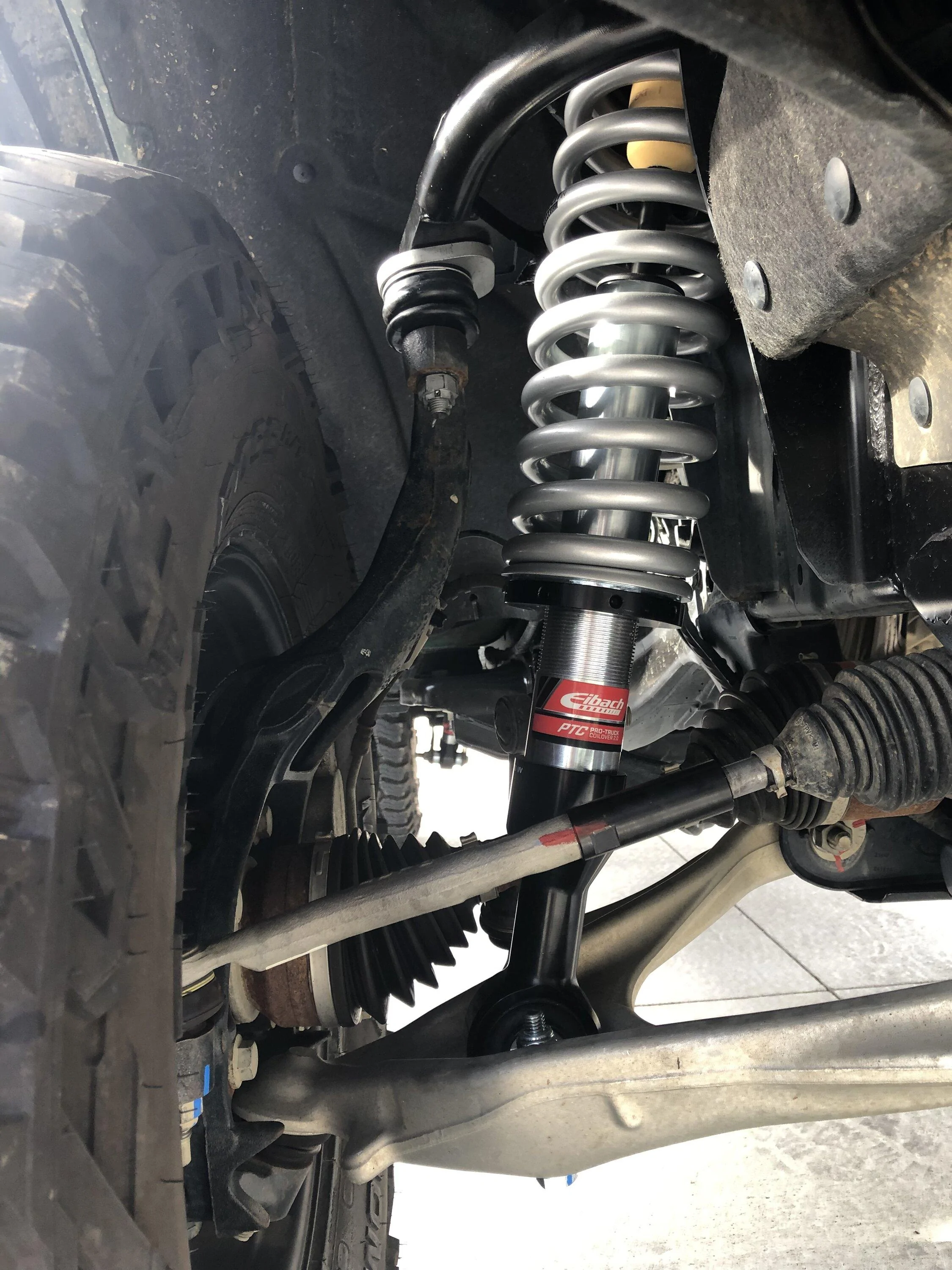

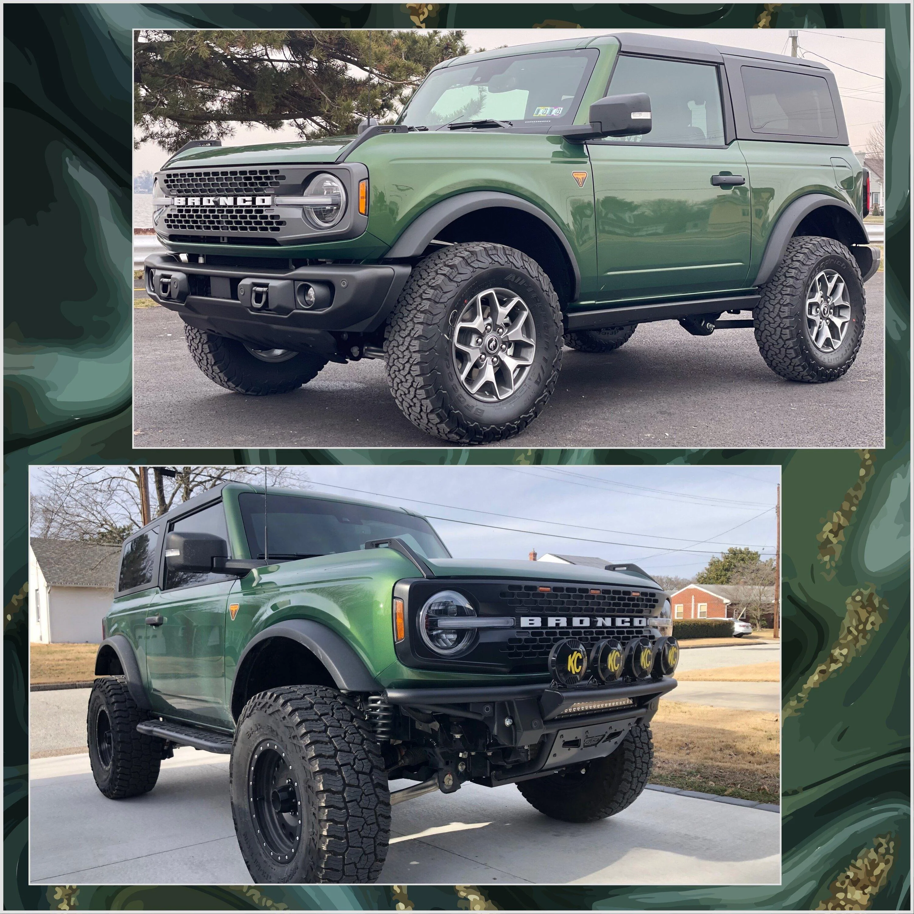

This is what I have done and I am extremely happy with the setup. I ended up going with the preset height of about 2" of lift from sasquatch height (2.25" front, 1.75" rear). Everything was still in alignment, but I definitely can't go higher or camber would be out.
The ride is great. Softer than stock, but in a good way. I'll be getting it off road in February to test it out to make sure my 37's still don't rub when stuffed. From what I've been able to test so far, it looks to clear.

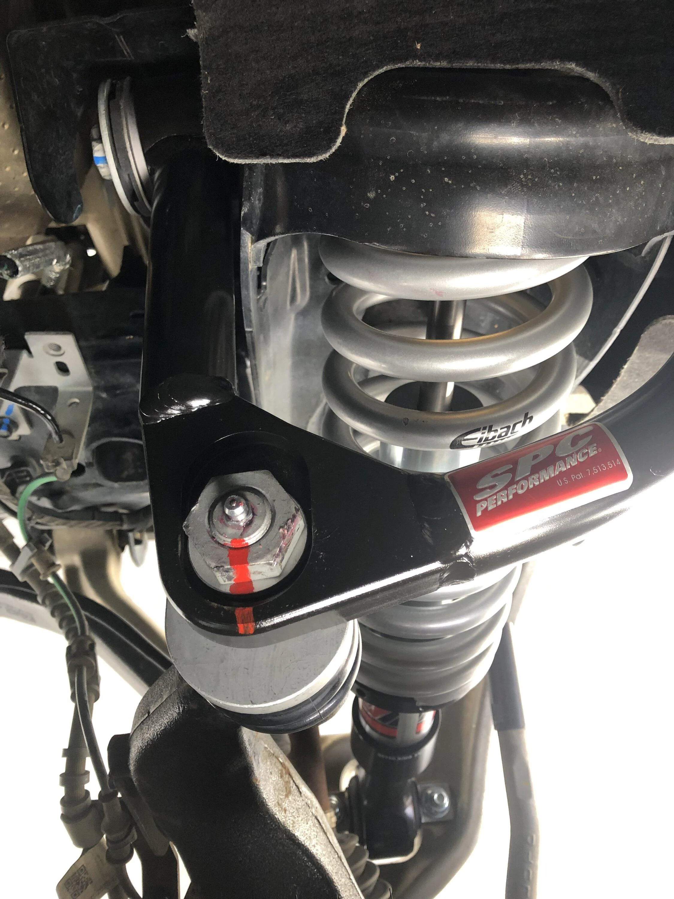

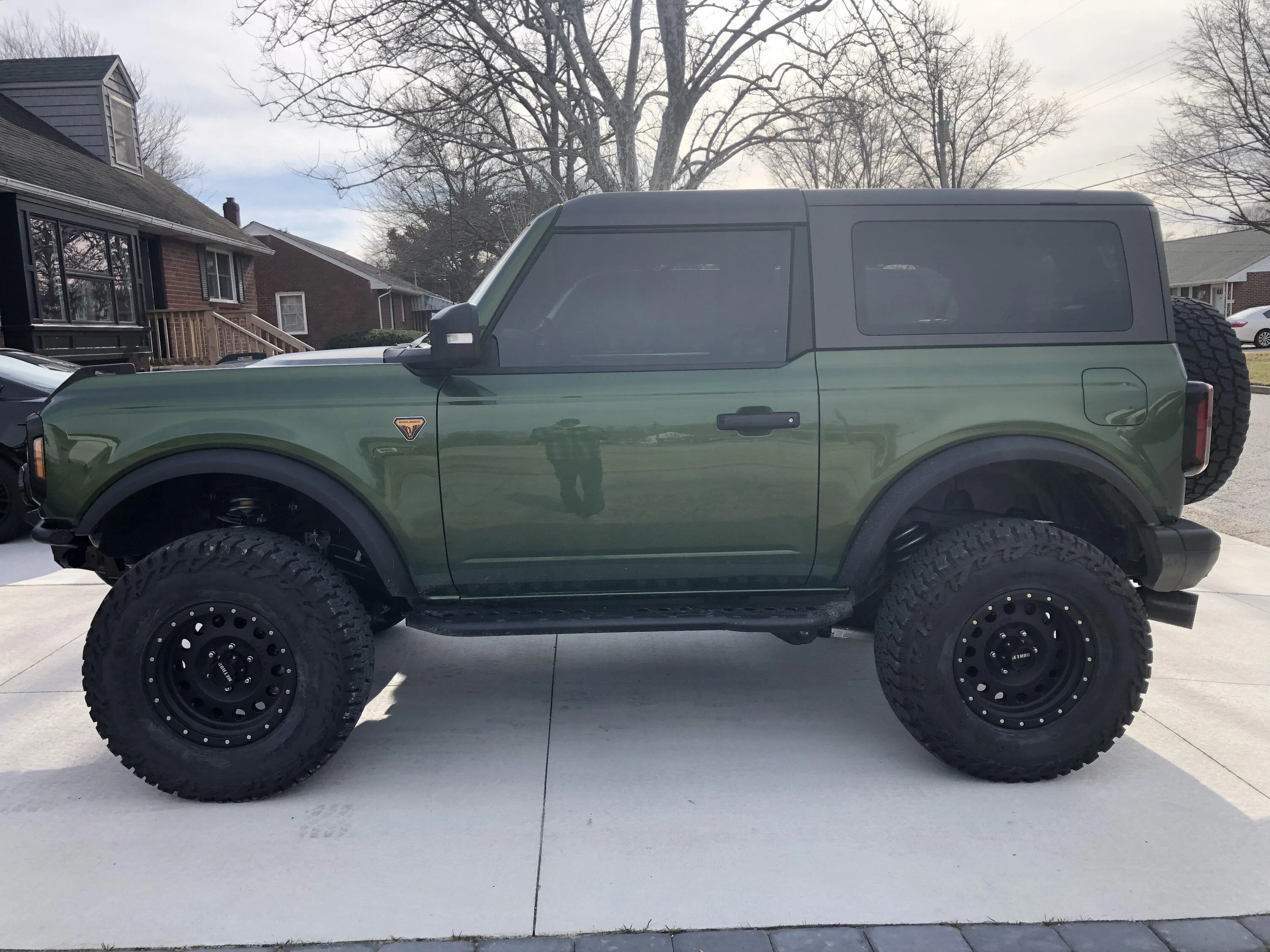

Took me a bit longer to get around to installing these then I would have liked, but it’s all wrapped up with supporting modification to max these out. WOW the results. Super happy.
Very nice set up! Its similar to what I have planned. I've already installed the Eibach 2.0 coilovers, but need to get UCA's and the BB bushings & tie rod reinforcements before I take it to the max lift. I've narrowed my choice of UCAs to Icon Delta Pro or SPC. Why did you choose SPC and how was the install? Are the instructions adequate?

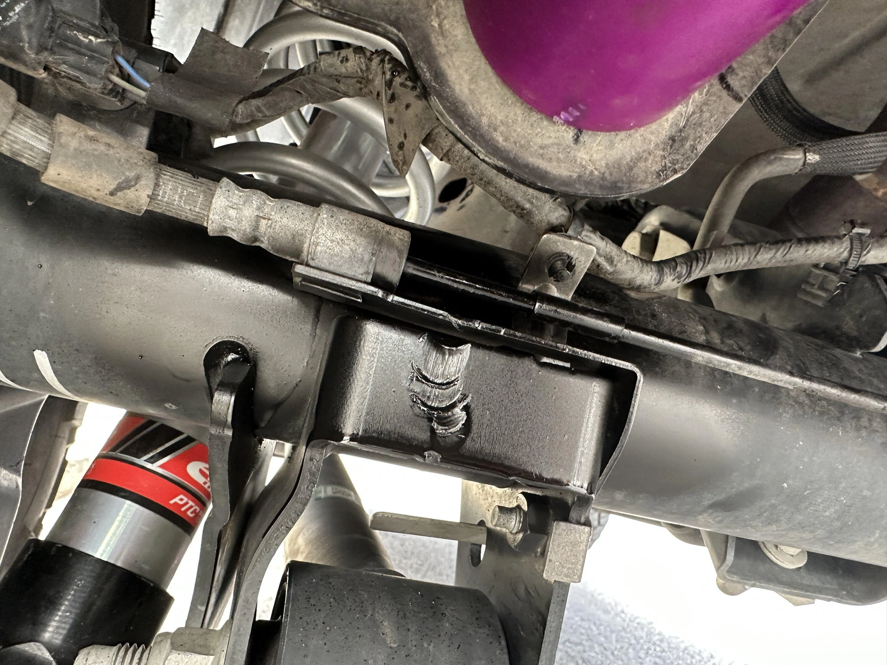

Had mine installed last week. Finally had an opportunity to actually give it a drive today. There’s a gnarly thump in the rear when I hit bump at speed that wasn’t present with the OEM coilovers. I have them set to the highest setting. Any thoughts?
Did you have supporting mods added? New UCAs, Lower Controls Arms, Upper Control Arms, Traction Bars, Relocation Brackets, Diff drop, Mid Travel A-Arms, Tie Rods? If not, the specs clearly state they are set from the factory to the max the OE geometry will handle, giving 1”+ over Sasquatch. OE+

Turns out the problem had nothing to do with the Eibach Coilovers. I put an adjustable rear track bar at the same time. One of the bolts was too long and slamming into the shock mount when the springs would compress. Cut a few threads off and the problem is solved.
I feel a little dumb now.

Eh, it was fixable and didn't appear to permanently F anything up so . . . no biggie? Lesson learned AND shared, right?
Yea, honestly no big deal and I’m glad it was an easy fix and nothing actually related to the actual coilovers.
