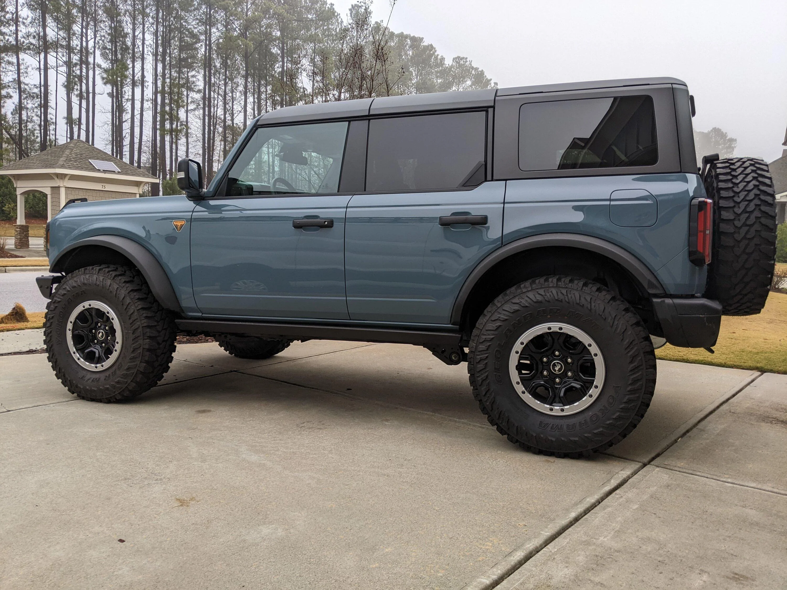

when I installed them, I didnā€™t change the collar position right away. out of the box they were sitting too low. I have a drawer, the factory slide out, made by Tuffy, in the rear, which when loaded with tools made my car sit low in the back. In order to get it level, I needed an additional lift in the back. About 3/4 of an inch. I know most people have to raise the front to level it, but my rear sagged due to the drawer weight.
I have now raised the collars to about 2 1/2 inches up on the adjusters. My bronco was a bit high in the front but I have since put an aftermarket bumper on it that has leveled it out - it weighed more. I only have a little bit of adjustment left on the collars, but Iā€™m not rubbing at all as it is. I have 37ā€™s mounted.
I did not remove the sway or replace the rear track bar, but I did notice loading and jacking of the rear end when moving between drive and reverse. It does load up and make the car rise. Itā€™s more pronounced when going in low for obvious reasons. In my opinion, the eibach shocks ride fairly soft anyway, so I prefer having the stability that the sway bar offers. I donā€™t think it compromises ride or travel for what I need it for. Iā€™d rather have it there to minimize some of the lean/roll the soft shocks allow.
With the lift, my track bar seems an appropriate length, maybe just a hair or so short, not enough to warrant changing it. But if I go any higher, Iā€™ll need to lengthen / upgrade that bar.
Although I have a little more lift available on the collars, in the front I am all the way at the end of the factory elliptical adjuster in terms of alignment. If I go any higher, I will probably need to change the A arm. There simply isnā€™t any more room to change the angle on the factory elliptical adjuster. When I put on the eibachs and lifted it, I was very far out of alignment in the front.
Overall, Iā€™m super happy with the shocks and the way it turned out. I am aligned correctly, it tracks well and rides well. Itā€™s not as beefy of a set up as my Jeep had - but that was a serious rock crawler. I donā€™t plan on offloading this in the rocks as much - itā€™s perfect for what I wanted.

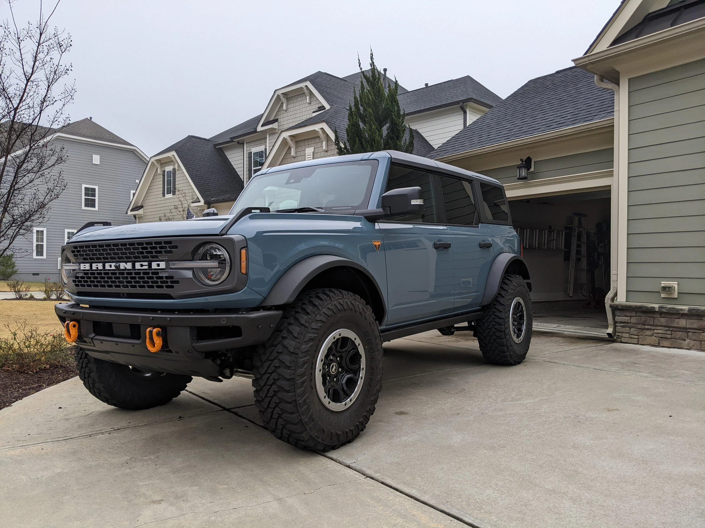

I installed the Eibach coil overs a week ago yesterday. Install was fairly simple using the drop the lower control arm method. The only thing I'd do different would be to install studs on the top hats instead of using bolts. Drove around a couple several days before alignment to see if they would settle but they didn't.
I have a 4dr Badlands V6 non sas. I wanted to stay under 2" lift so I backed down the perches 2 full turns on each shock. This worked out to 1 7/8" lift in the front and 1 3/4" lift in the rear from stock. Perfect for my use. My rake is now right at 1". I don't want it level as I pull a Taxa Cricket often so we'll see this weekend how it handles the trailer.
I'm extremely pleased with the ride. It's noticeably a softer ride than the Bilsteins, but handles/corners/stops just as well.
I think Eibach knows what they are doing!

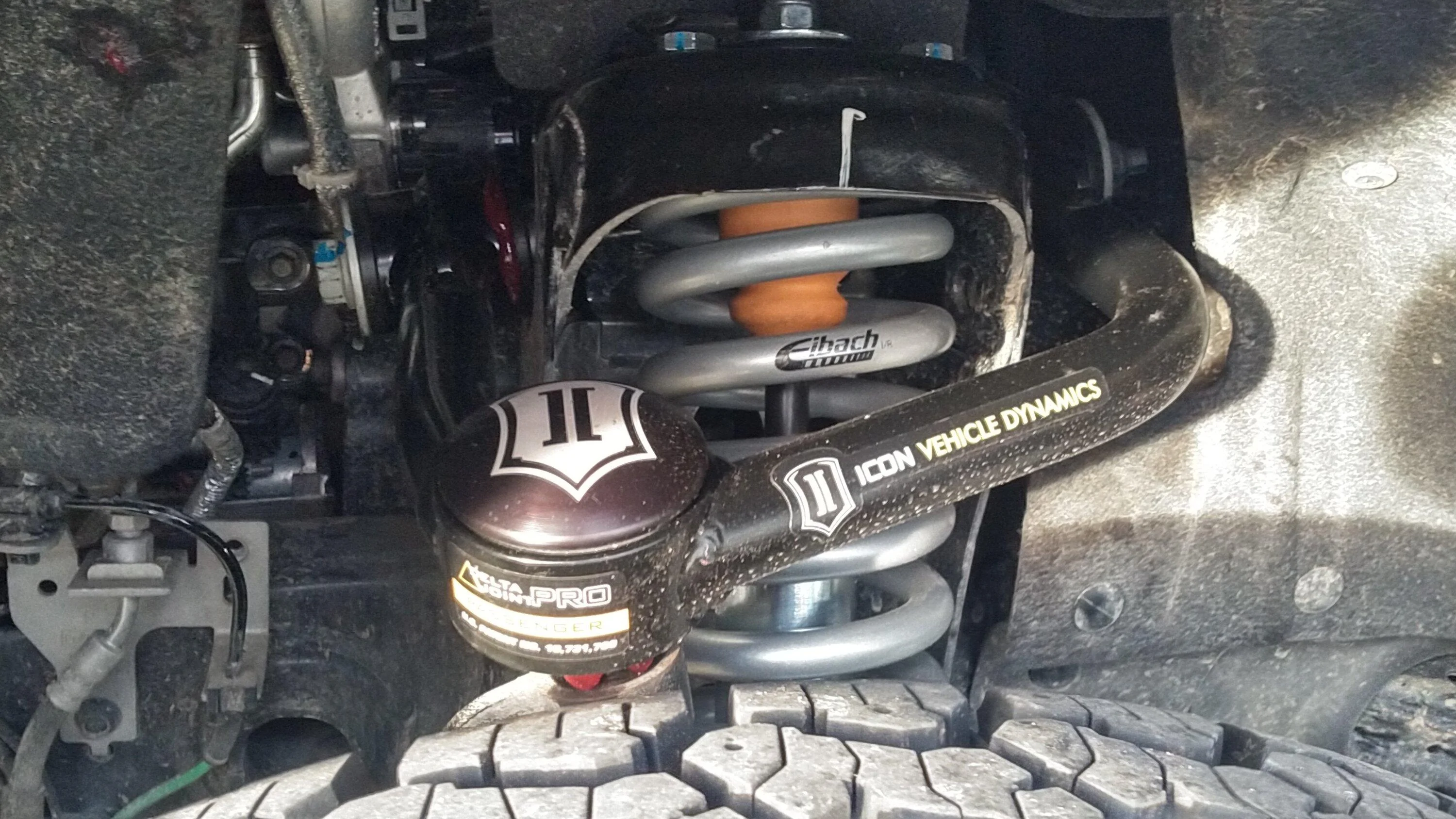

Finally got around to installing my Eibach coilovers! Also removed my rear sway bar while I was at it. Love the ride! As others have stated, it is a little softer ride than stock sasquatch, but in a good way.
Lifted it 2.25" in the front, 1.75" in the rear without any adjustment. I'm at the end of adjustment for camber now, so I'll have to go with new UCAs if I want to go any higher. Of course, I'm not planning on it until I go long travel anyways.
First corner took me a while, but then the rest was a breeze. Had no leverage to fully torque the LCA bolts and my torque wrench didn't go up to 350 lb ft for the rear strut lower bolts, so the plan was for the dealership to take care of torquing those bolts during the alignment. Of course, the dealership quicklane didn't have the necessary torque wrench either, so I ended up having them run the impact on it a few times. Could have just done that myself during install. :confused:
On another note, almost hit a snag because the rear strut lower nuts didn't have the anti-rotation tab on them. Didn't have a 30mm deep socket, but was luckily able to hold onto an adjustable wrench enough to make it work. WTF Ford?

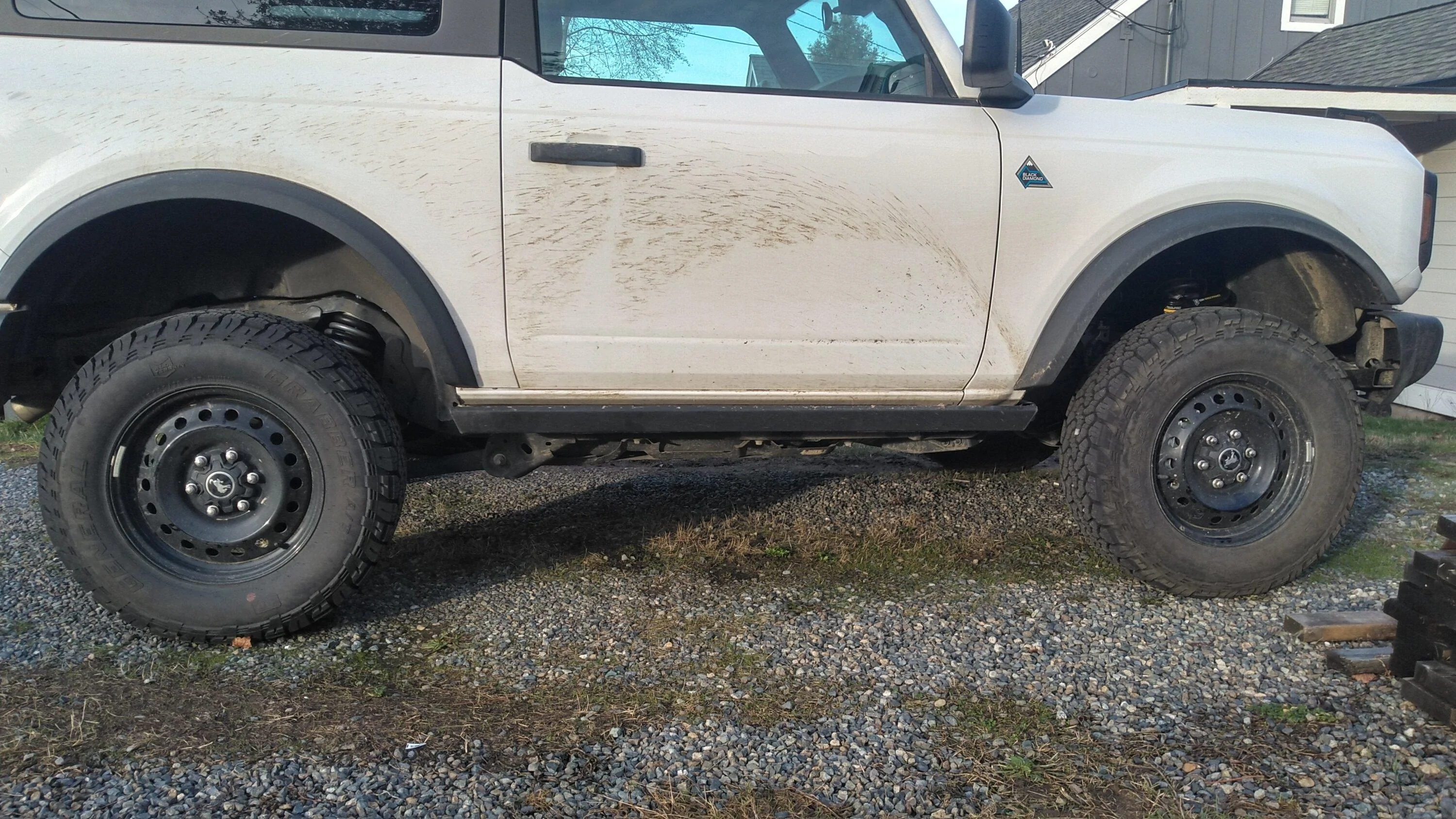

I didn't go for the SAS because with the other stuff I initially ordered (tow package, 2dr, MIC top, BD package, bumper), I figured it was going to take 3 years to get it all so I started deleting some stuff when my order was changed from a '21 to a '22. That plus I'm comfortable with the skid plates, sliders and gearing the BD package offers and befoer I put on the Eibachs, I didn't want 35" tires.
Pictures. Sorry, but you're right! but I should at least provided some pics too. I'll add some here unless I run into a tech thing. I don't have level side shots worth a damn and I don't have a great shot of the side post-lift, but I'll try to add more to this thread later. Let's just say I have a whole lot more wheel well showing now :) Thanks! C
