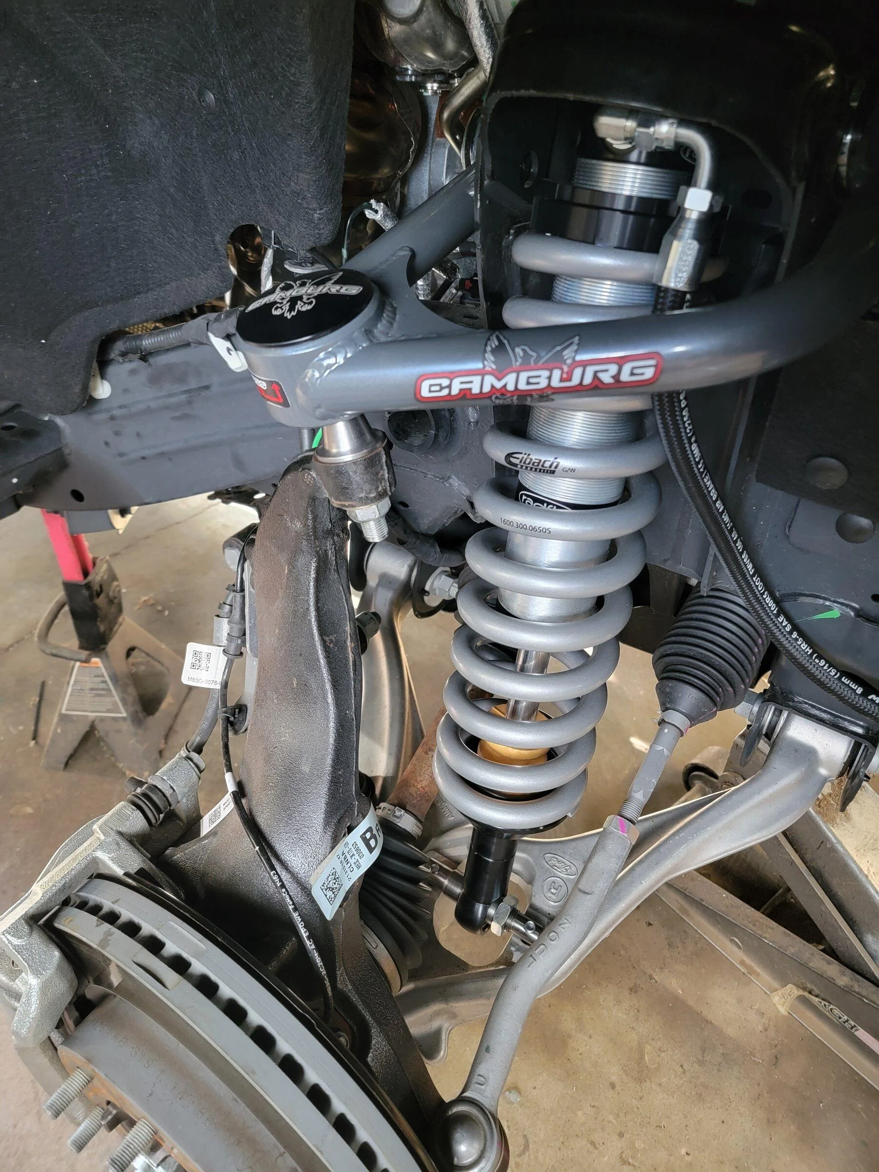

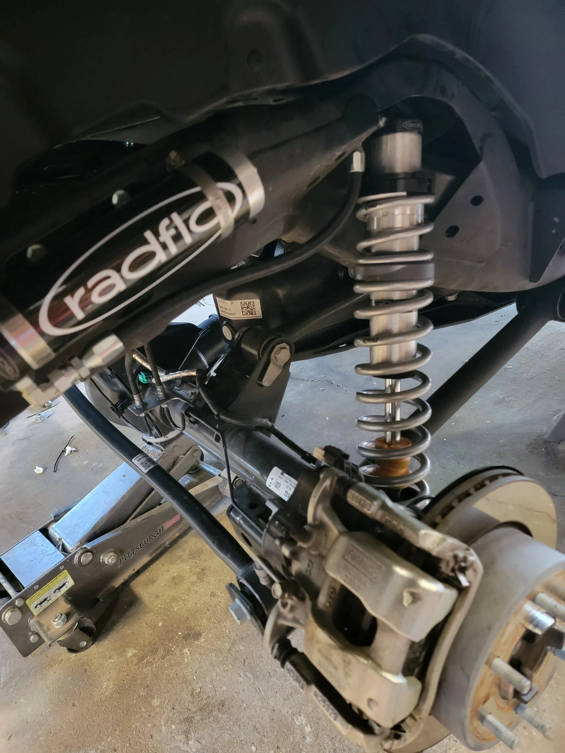

So last weekend I finally was able to get time to install the radflo extended length coilovers and camburg upper control arms. Also installed some foutz motorsports rear lower shock skids as well. Install was pretty straightforward, with the rear obviously being much easier. So after driving it, I am definitely pleased. So far haven't been able to get offroad yet, but onroad manners are much better. It seems to handle much better onroad. The valving is clearly a little stiffer. I live off a winding country road and the bilsteins felt a little soft and would have a little body roll when cornering. With these shocks it is greatly improved. I have yet to take it offroad to see how it works, but just driving on roads here in California is pretty close. Will probably get it up to the rubicon after memorial day and see how it does in the rocks. But overall would definitely recommend the radflo shocks. I do need to adjust the front up a little more to even it out but needed to give the wife her Bronco for monday. They are basically exactly the same as the fox in fit and finish and performance.

You said it felt stiffer than before... What trim/shock setup did you have previously?

I had the bilsteins before. Its a 2 door badlands with the Sasquatch. So whatever is stock. The rear radflos did have dual rate adjustmsi i could run them down a little to soften it if need be, but I like it much better the way it is.

did you get a chance to play with the adjusters? If so how did you feel a significant difference between soft/firm? may be a good way to play with the feel once the coils break in.

I haven't adjusted them yet. They are all set to stiff I guess. Honestly its my wifes daily driver so she drives it the most. I get to run around in it on the weekends though. I would like to get it out on some dirt back roads and see how it handles G outs and larger bumps at high speeds. I noticed the old suspension left stiff in the rear and liked to buck on bigger g outs.

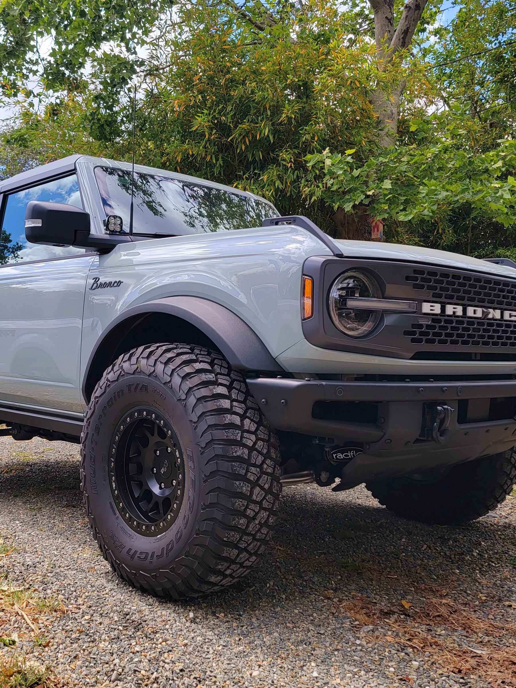

Looks great. What size are those KM3's?

37x12.50-17s The 37s make it look much better, the 35's were just a little to rollerskate looking. I do plan to actually wheel this thing also. So the added ground clearance is a huge plus.

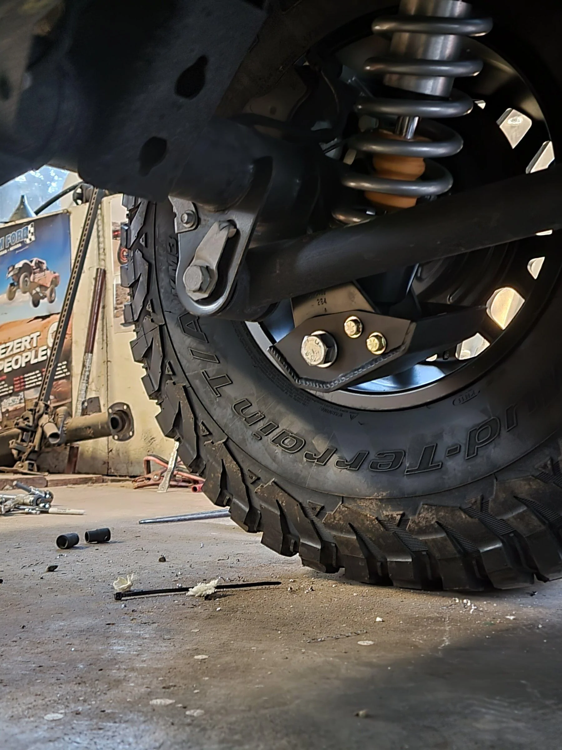

how much lift do you get out of the Radflows? I have the 4WP coilovers and got 1.5" in the rear and 2.5" up front and feel like I need another 0.5"-1" so my KM3s don't rub off road - same size, 37s.

I didn't really measure a before and after. But it looks like it raised the rear up a few inches. I need to adjust the front up a little. So basically you can adjust them up and down as needed. I am going to crank the front up a little. I don't have any rub issues currently but that may be just the offset combo of my wheels. Also haven't checked if there is rubbing offroad yet though.
