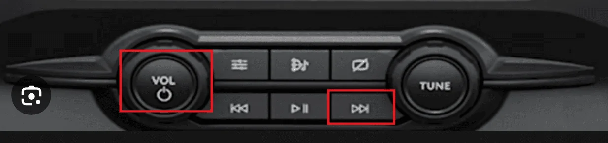

For the screen / radio
Yeah Sync is somewhat glitchy. I get a random black screen or phone fails to connect about once a month or so.
You can reboot Sync without shutting of the entire Bronco if you press Radio Power + Fast Forward for about 10 seconds.
