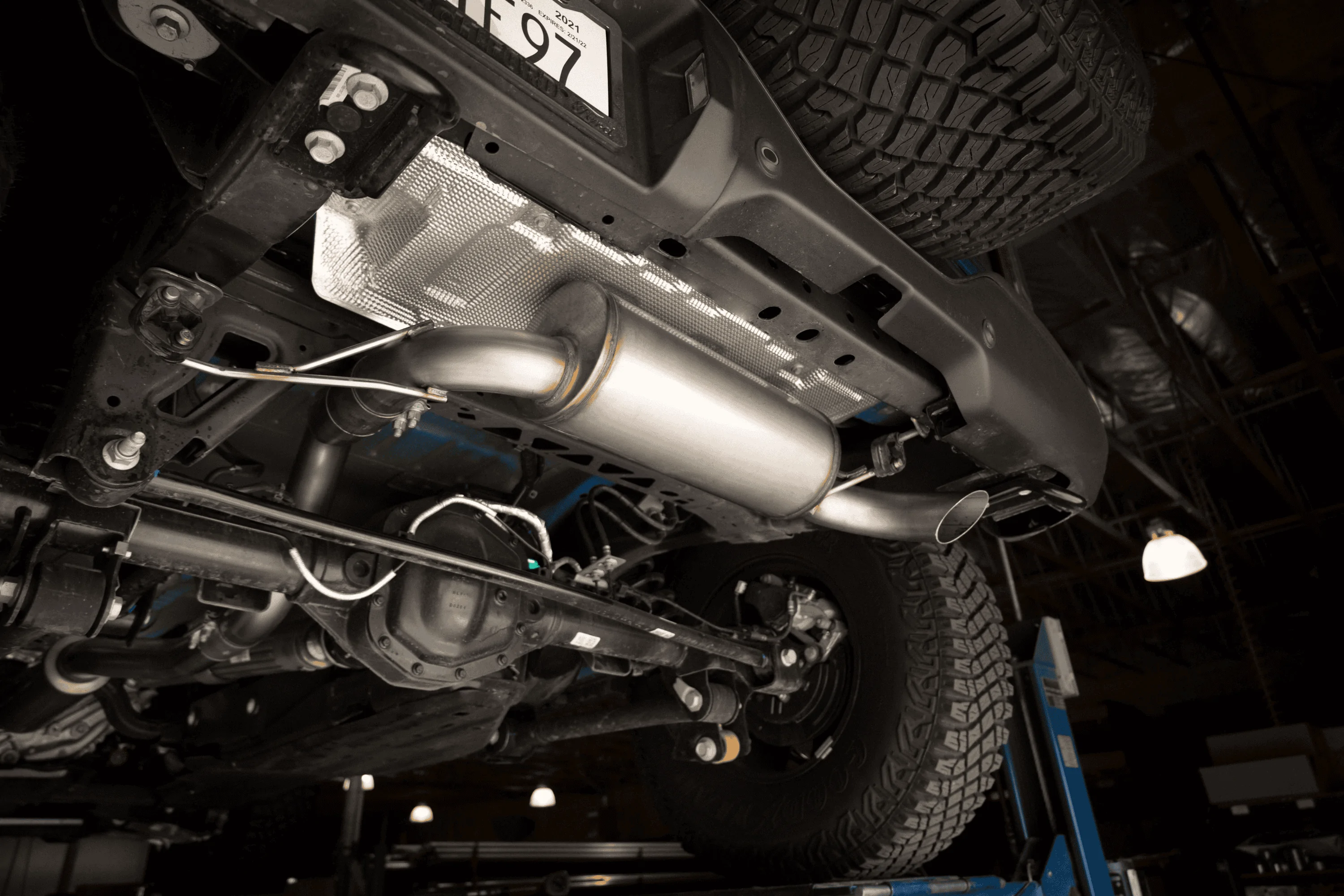

I've seen quite a few "dual exhausts" that used an electronic cutout to split between a straight pipe outlet or a muffled outlet.
For instance, on the Thermal exhaust below, you would cut the muffler off right around the rear hanger area, install the cutout there and have the straight pipe outlet on the left with the muffled exhaust on the right. It looks like dual exhaust, but only one side gets used at a time.

similar but different. He is referring to more of a cut-out vs a valved muffler. one is more performance based whereas that looks for sound based.
From what I understand, his post is about a dual exit system that diverts one side through a straight pipe to the rear, where as the other side is muffled. Varex is essentially the same tech, the valve is just on the muffler instead of upstream. A cutout would be a dump upstream. Furthermore, Porsche use a similar system to BMW where the valve and straight pipe is inside the muffler, and diverts the gasses through a more free path. Which is exactly how the Varex muffler works.

Varex describes there's as more of a sound vs performance benefit from what I read. I could be wrong as I'm not familiar with their tech but regardless a cut out with intended performance benefit would be better upstream regardless.
Edit: reread OP post again and it seems he does want the same as this system provides. Nevermind above. 😅
