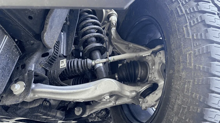

Nt sure if my link works but check the picture of the front suspension for the Ranger refresh and tell me the tie-rod doesn't contact the shock - and that left front wheel appears to be only half turned. Precisely my conclusions of why Bronco tie rods snap - overextension of rotational parts with no built-in or adjustable physical stop other than the contact of parts that should never come in contact.
