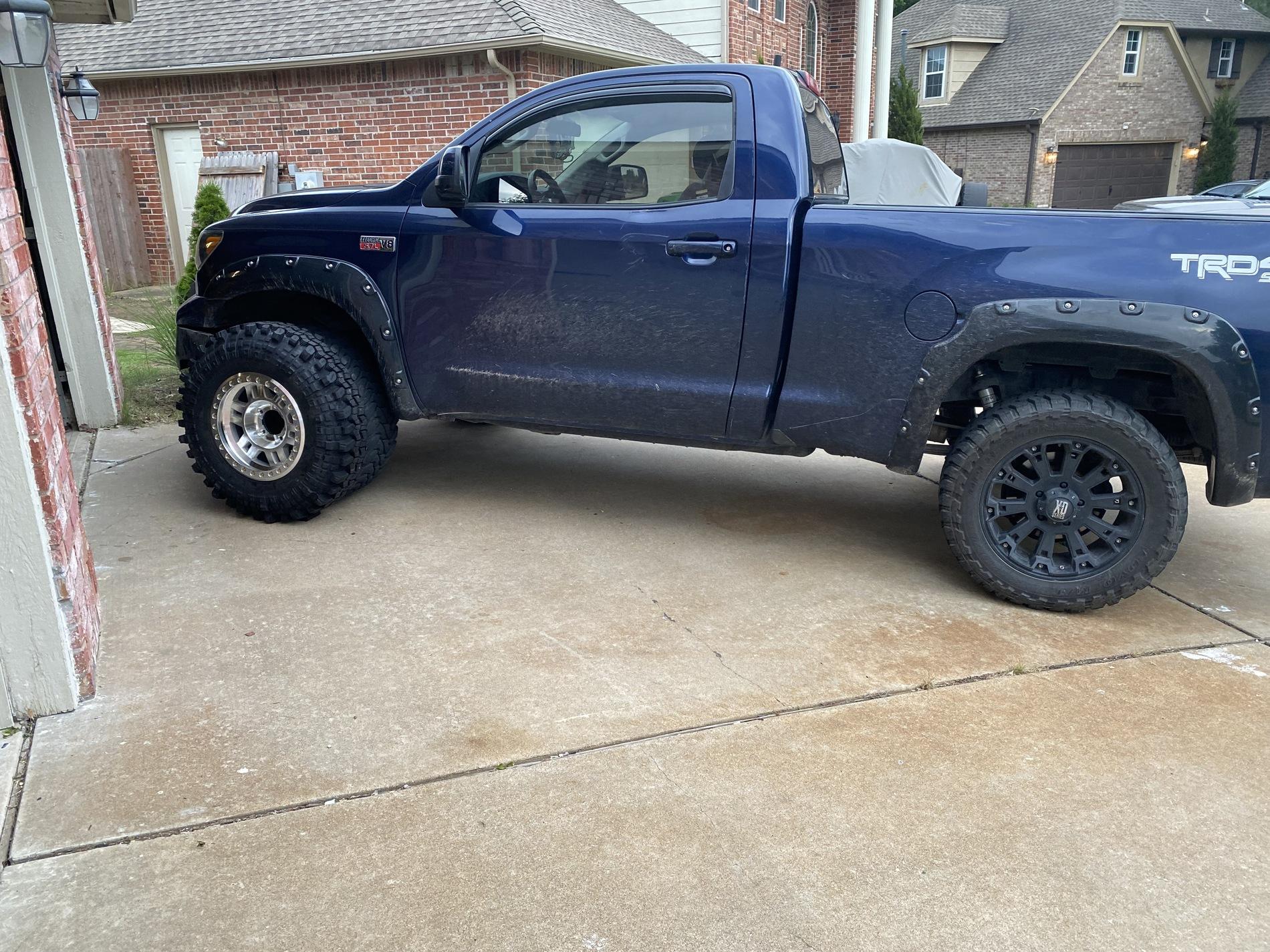

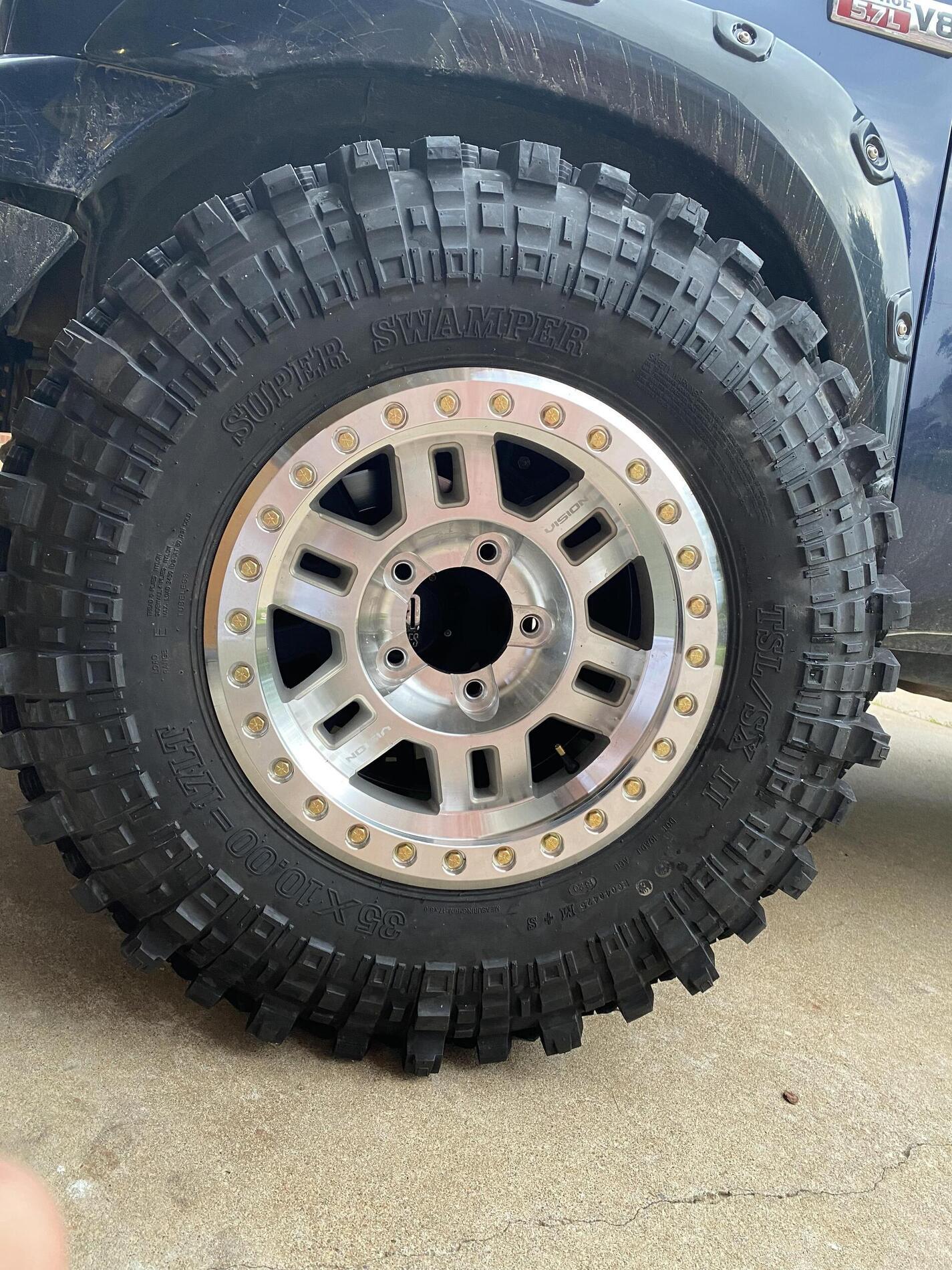

You could probably just do the basic 1" spacer lift front/rear. Price should be about $100 for parts and $400 for the labor to install if you don't do it yourself. Get an alignment after you lift it and install the new wheels and tires because it'll be all out of whack when you're done. I like BFG KO2's. They're AT tires but ride and look great. 35x12.5R20's are typically more aggressive M/T tires that cost more $$, so look for 315/60R20 tires.
I have 33's on 20's for my daily driving, but putting together a set of 17" beadlock 35's for when I go crawling.
