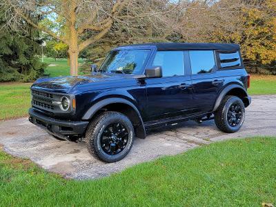

Got new wheels and tires from Custom Offset. I have an OBX that came with 255/70/R18's with 18 inch wheels. I replaced those with the same size tire and wheel but I purchased Firestone LE3's and 18 inch Icon Alloy Rebounds with no Offset. But now my Bronco sits lower, by about an inch. Forgive my ignorance on this matter as I don't know much, but I figured same sizes all the way around wouldn't be a problem.
Any and all help would be appreciated Thank You.

An inch lower would mean the diameter changed by 2 inches. There will be a variance between manufacturers for exact same size and tire type but not two inches. Street tread will be smaller diameter than off road. But the biggest difference is that you probably went with wider rims which squats the tires more than they might have been designed for.

So I checked the difference is in rim size. The stock OBX are 18x7.5 the ones I got are 18x9. Is there anything I can do to make up for that?

Are you sure it sits lower or just looks like it does? There must be a lot of wheel poke now with a wheel that's an inch and half wider and going from 55 offset to 0.

Yeah 0 offset and 1.5 wider rim and your wheel should stick out from under fender. That’s about 3 inches out.

Changing the width of the rim has no significant effect on the tire diameter, are you sure you bought the same exact size tire? There will be small variances in diameter depending on the brand/type of tire you bought but I doubt you would see a 2 inch change in diameter. You didn't happen to get 255/60r18? (this would reduce the outside diameter by approx. 2 inches)

I mean... yeah... you went from All-Terrain tires to All Season tires and a wider rim. All-Terrains generally have 1/8" thicker tread than All Seasons, and tires do sit a little lower with a wider rim, but none of that accounts for a 2" difference.
How are you measuring the 2" difference? None of it makes any sense if you got the same size tire.
Also measure the sidewall on your new tires. It should be just over 7 inches.

Measured the sidewall. 6.5 inches compared to 7 on the Bridgestones
Edit: I compared to another Bronco OBX at my dealership and it was definitely lower. I've got my measuring tape to bring with me tomorrow to measure and see what's up.

Alright well that means you lost an 0.5 inches of height and not a full inch... but I'ma ignoring that for a second.
What's the width of the tire? If it is 10 inches wide, then your new tires are actually 255/65R18 tire, not 255/70R18.
