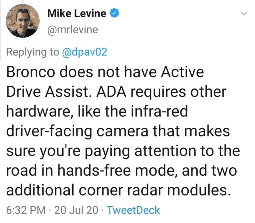

I believe ADA is where the lane centering tech comes in. From other reviews I've read, it will essentially self drive on a highway around curves and everything, in stop and go traffic, etc. Perhaps I should enjoy driving the Bronco myself since who knows what my next new vehicle in 10+ years (fingers crossed) will look like. Don't exactly love the idea of a camera looking at me while I drive to make sure I'm paying attention... so many 1984 implications.

Just to clarify, ADA is the hands free driving currently only offered on F-150 and Mach-E. The extra sensors are solely for that.
The Stop & Go and Lane Centering still only use the camera in the windshield and the radar in the lower grille. To say the technology isn’t current would be a mistake. I cannot say for certain it will be coming but it is capable the setting is just disabled at the moment. Future software updates hopefully will address this.
Lane centering requires sensors in each corner of the front bumper to watch the lane markers so I understand why that would be a challenge with the bronco bumpers, removable end caps, etc. But I think stop and go just needs the camera and center radar module which bronco has. I mean, bronco has the emergency braking feature so it should be the same thing. So why they wouldn't implement not is beyond me
