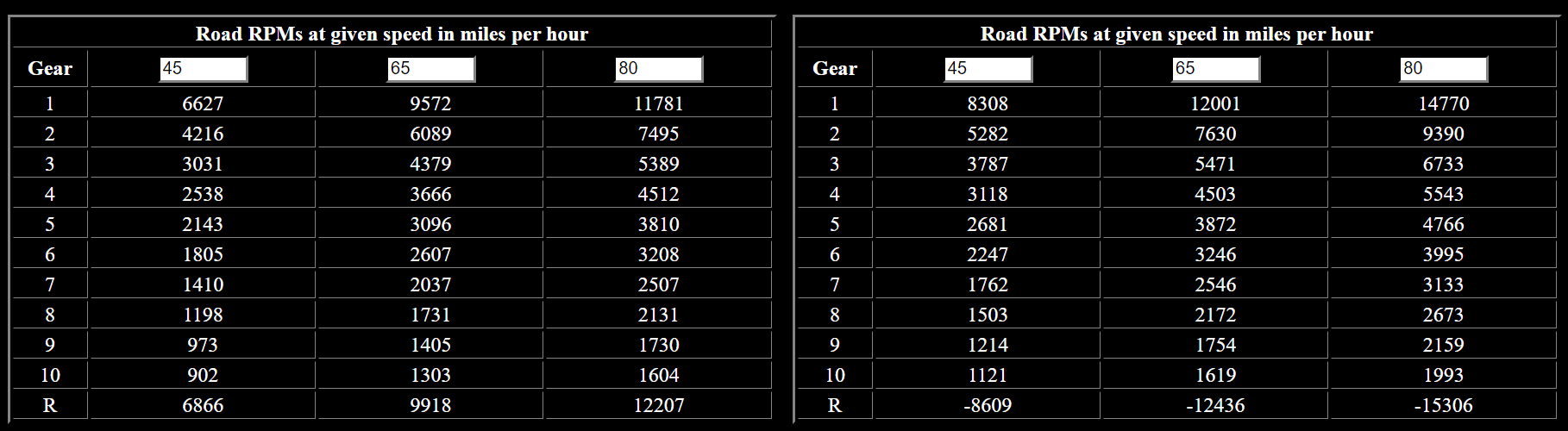

But a little extra engine power doesn't fix gearing (AKA RPM at MPH). The auto trans is way out of its programmed range/ mechanical ratio and will behave strangely, not hit 10th frequently and gear hunt, increasing transmission temperature and wear, and just flat out be annoying to drive.

^ This approximately is you now.

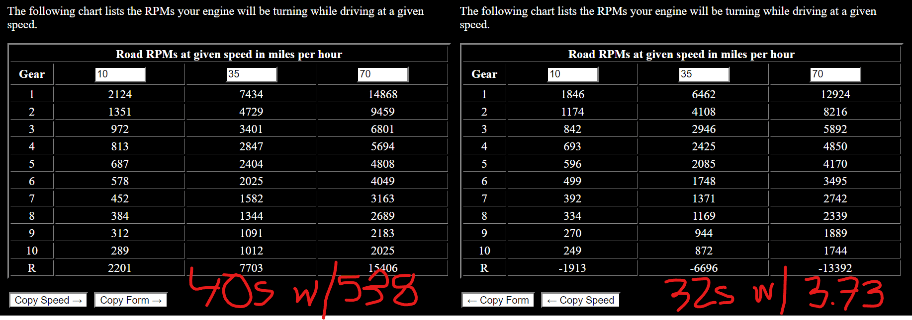

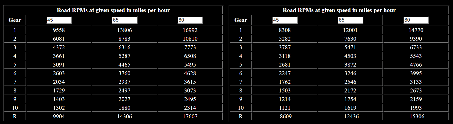

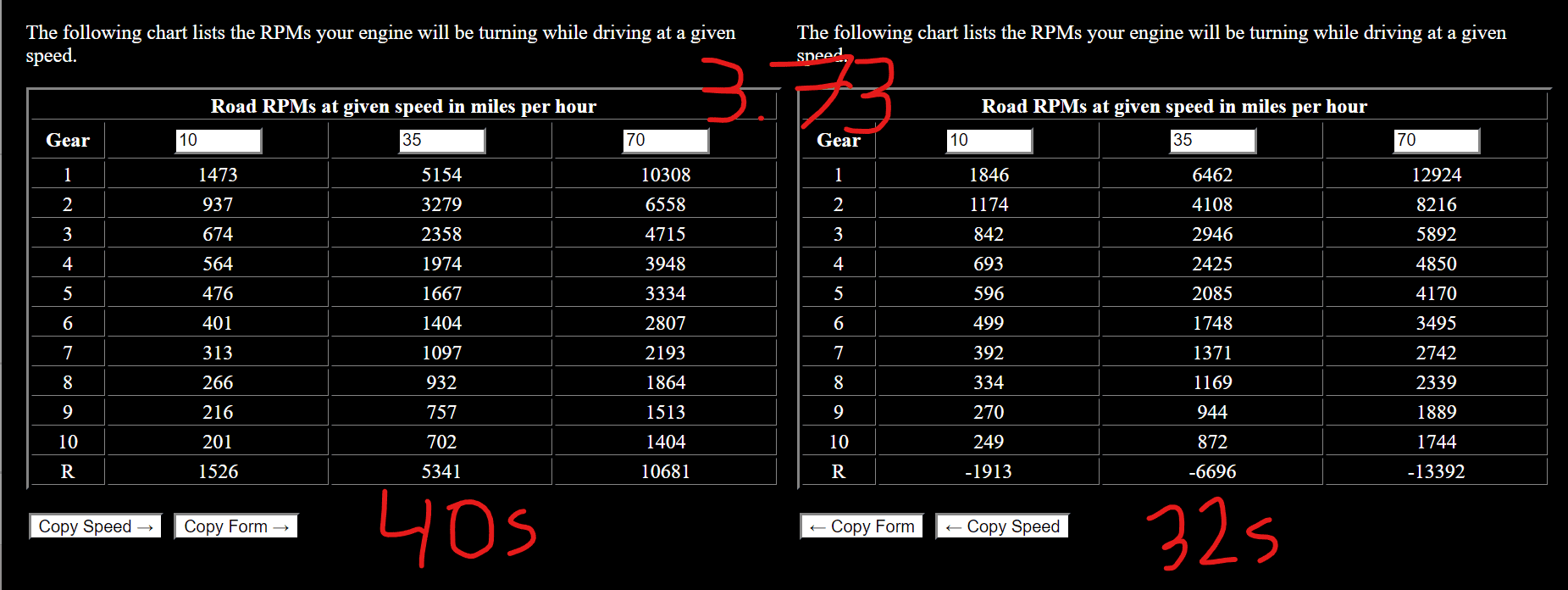

The 40s are much, much, much harder to turn than the stock OBX wheels and tires. So losing 300+ RPM at highway is a big issue. If you go WOT to pass on the highway you will probably need 5th or 6th versus 8th. The gearing hunting is going to be terrible.

^ This is what you need to do.
Dana Ultimate Spicer M210 with 5.38s and a Hoss 3.0 rack minimum.
