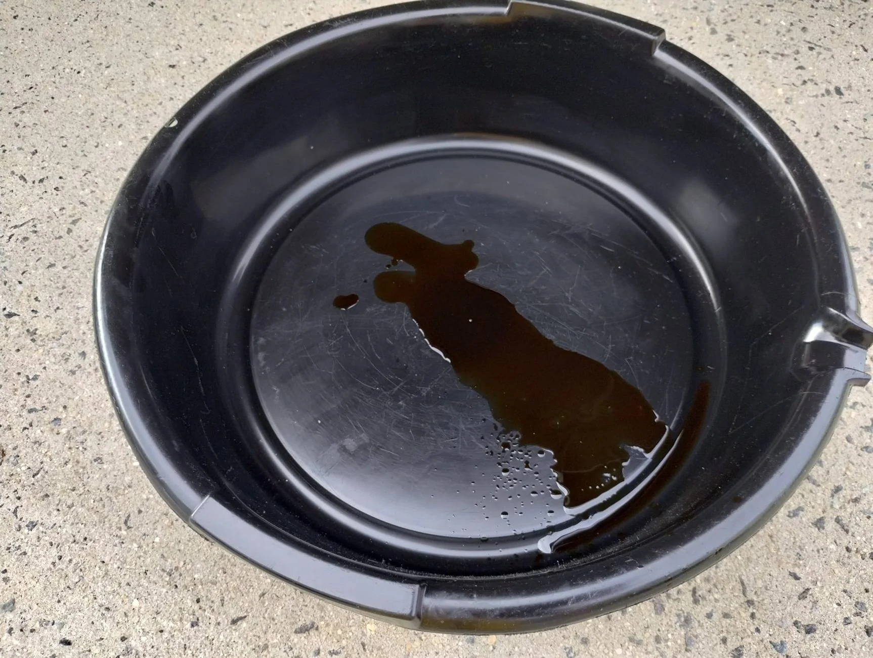

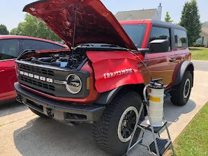

Extractor, not one drop spilled and can all be done from the top (2.7L experience).
Ford Bronco Oil Change Tips & Tricks IMG_1637
This is how much leftover oil dripped after I removed the drain plug... (3k miles oil change, full synthetic Pennzoil Platinum)
