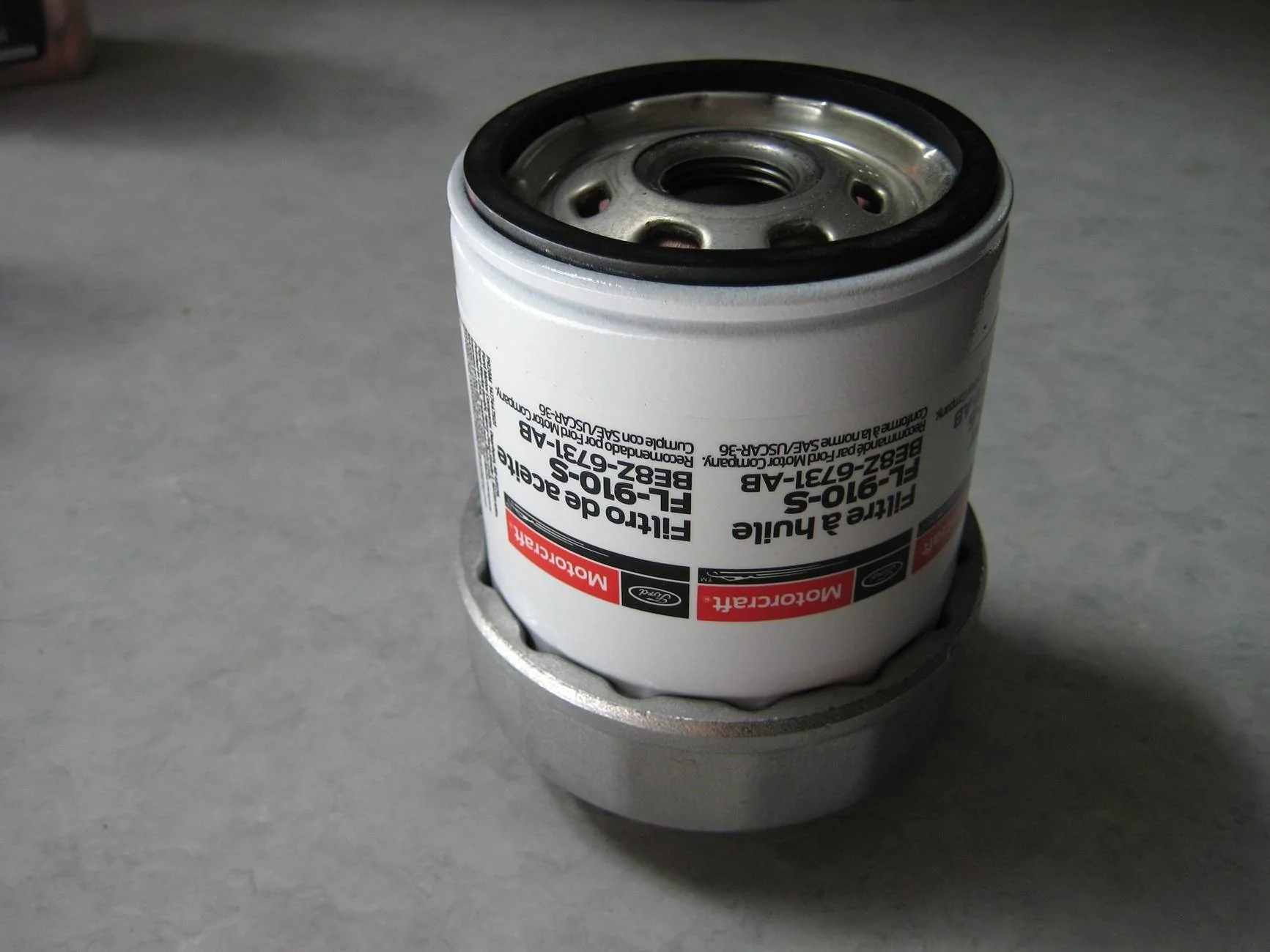

Cap wrench + a series of extensions or a single super long extension. Highly recommend a more solid chrome vanadium version over the stamped steel.
But echoing Squatch, make sure the filter tool is fully seated before cranking the old filter loose. I stripped my last filter + steel cap wrench, and it turned into a 3 hour oil change... fun times lol.

The Lisle's are 1/3 the price, but also 1/3 the quality. The Motive tool is a pleasure to use.
I've got both and can't see spending on a pretty tool vs one that works just fine.

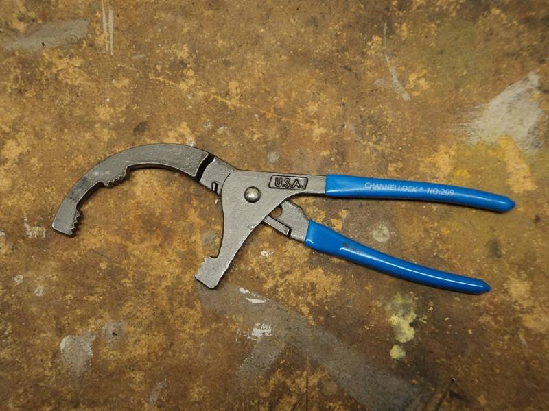

Does anyone have a good tool to remove the oil filter on a 2.3L Bronco? The oil filter that is behind the tire. I can reach to remove it but I usually make a mess and scratch up my arm. Is there an extension tool that is perfect for this? Thanks!
Channellock #209 wrench.

Gonna give this one a try as well....looks pretty stout, can't beat the price.
Sizing up my first oil change soon, that filter looks to be a PITA, especially compared to my Maverick, which is super easy. Same filter tho, which is nice.
Thanks for the link!
