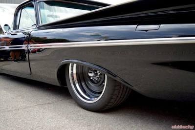

Goal is to find some (preferably two-piece) steelies (ie, Forgeline OE2 below) and run full chrome wheel cover 80% of the time and exposed for trails and/or change of looks.
If anyone if familiar with a OE2- esque wheel out there let me know. Forgeline is a bit out of budget. The fifteen 52 are close, but are one piece :(

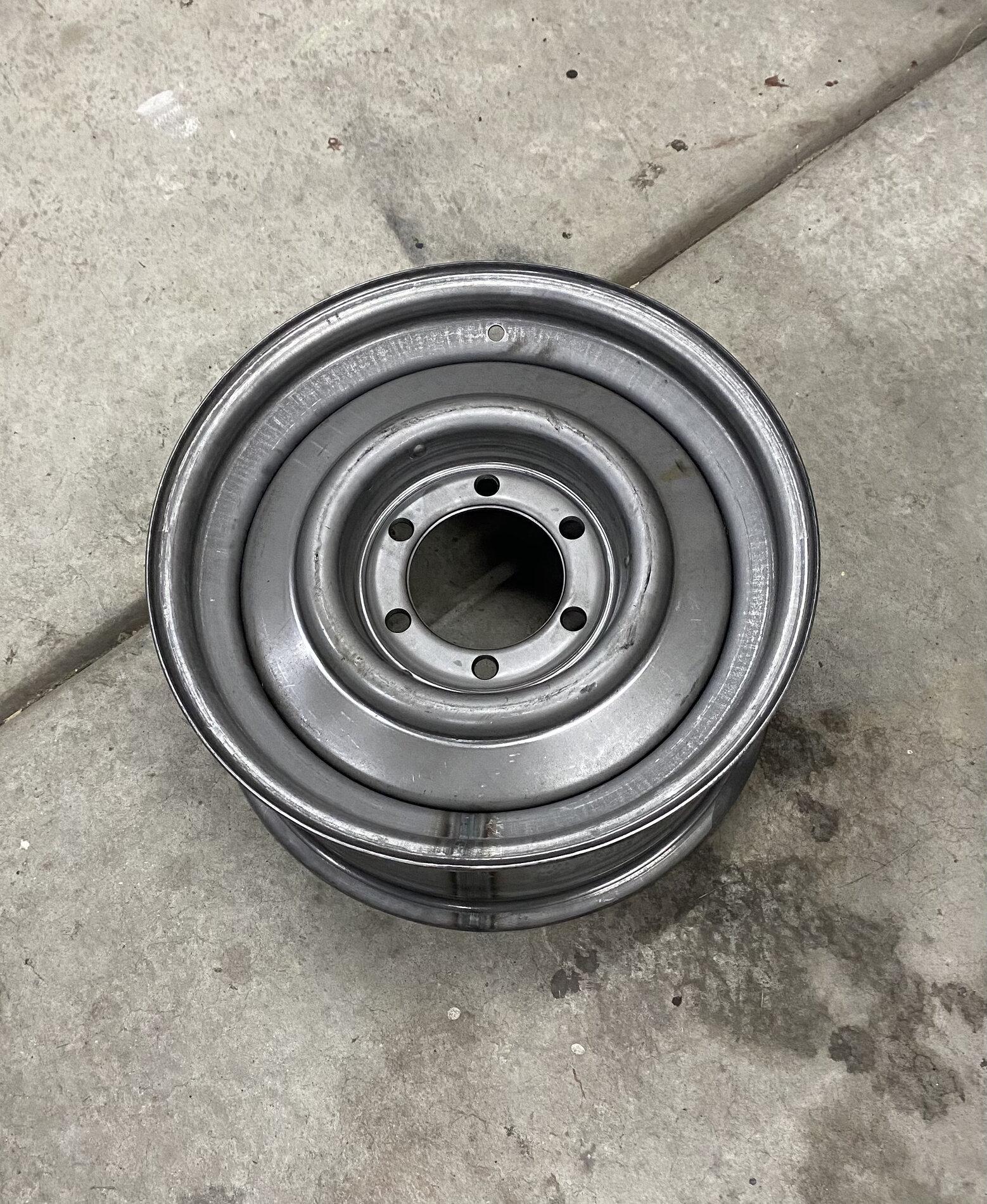

I had US wheels send me out a custom 30mm offset 16x7” smoothie to test fit to see if it will clear the calipers. I will let you know what I find out. Going to test fit it today.

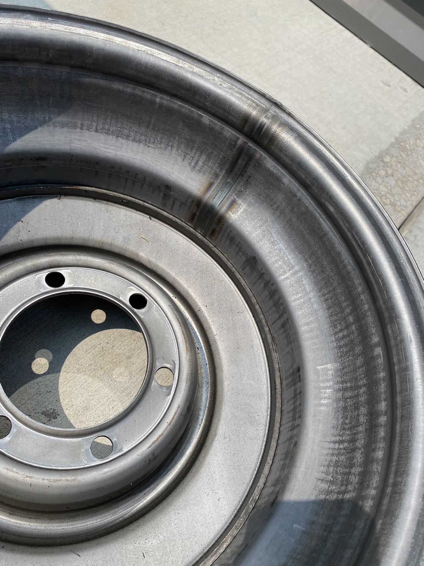

Ok so here is what I found. The 16” wheel with a 30mm offset will not clear the calipers. The way the rim steps down it is to narrow. If the wheel was set at a 0 offset it would clear the caliper. Because the wheel flares out and gets larger at about 0 offset.

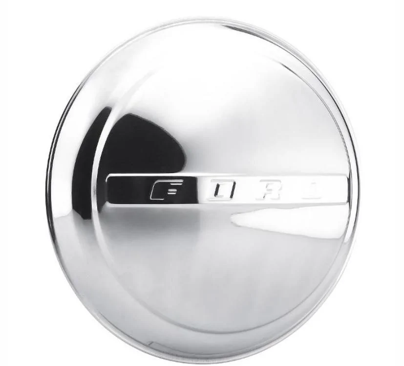

and yes I was thinking baby moon caps or these Ford caps.
