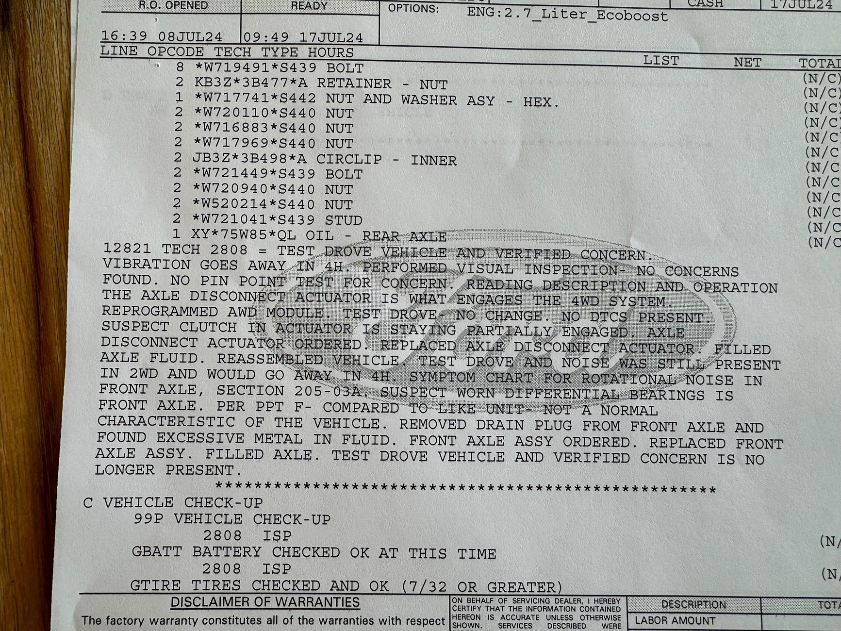

Thankfully the dealership I've been dealing with hasn't been giving me any trouble and are willing to figure out this issue (for now).
That being said they first stated the noise was coming from the FAD not disengaging properly so they replaced it. However the vibration/noise was still present after that replacment and they then decided to replace the front diff because they found metal particles in the fluid. The noise was still present after that swap too. So now they're claiming it's the transfer case as they've also found metal shavings in the ATF. It's currently in the shop having a complete tear down of the transfer case.
I don't have much faith this will solve the problem either. I'm about ready to trade it in.
