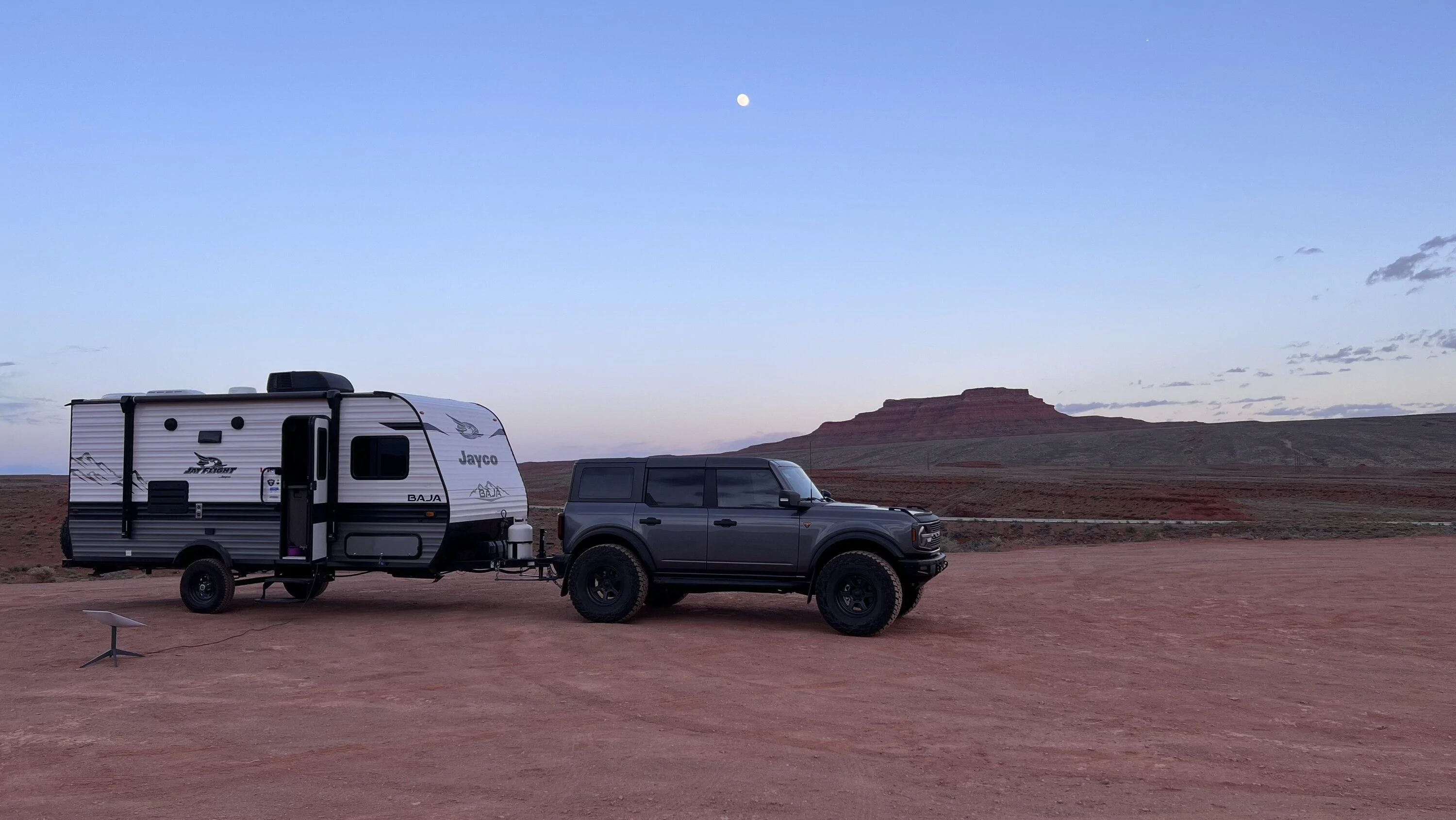

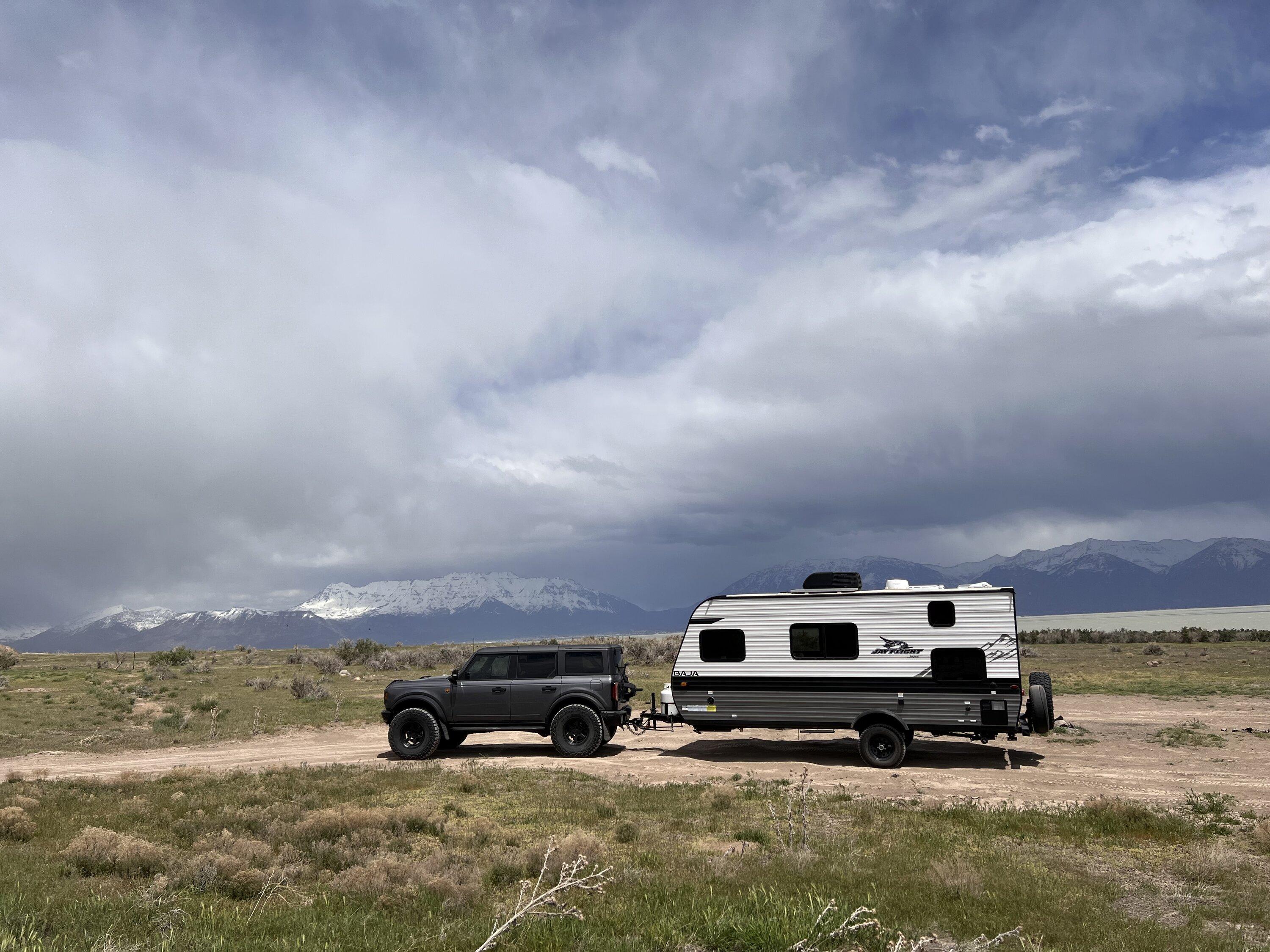

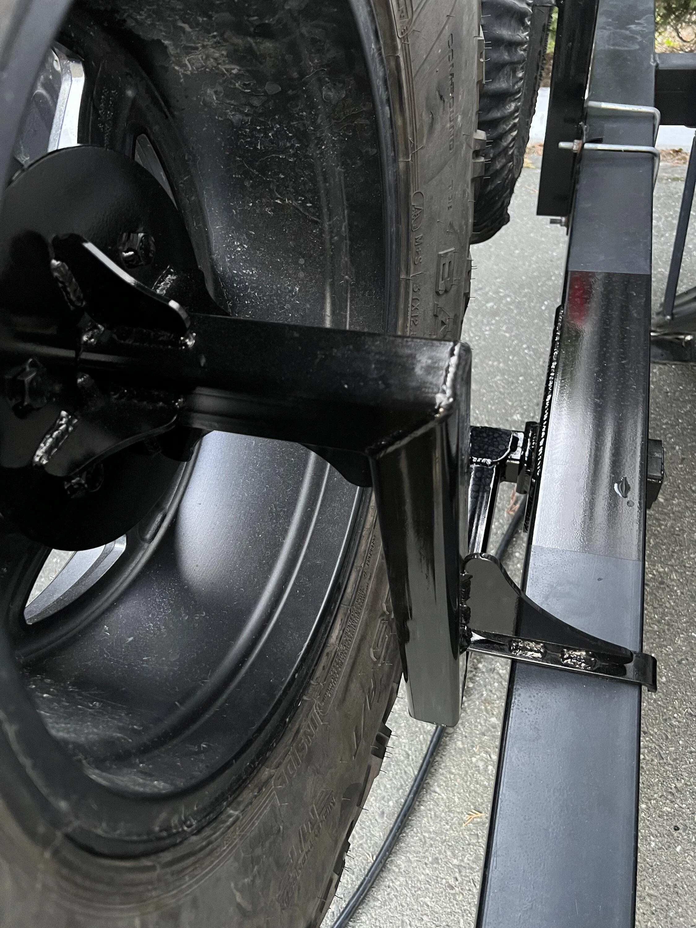

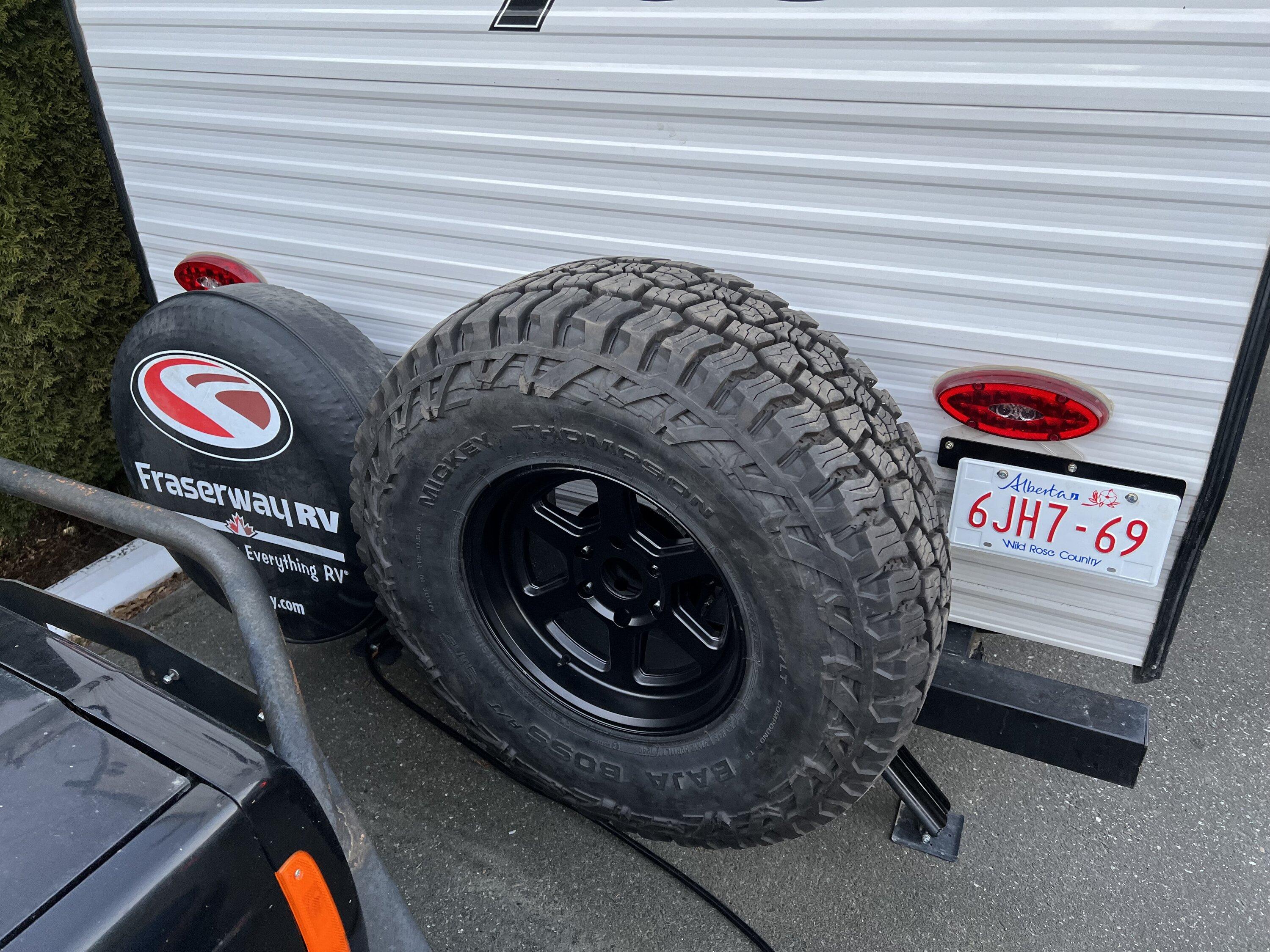

This looks great! My wife and I have been looking at this same trailer the past few weeks. We even rented and older version this past weekend to give it a try. I'm interested in a closer view of how you are connected. We were just using a typical ball mount and it looked as if the trailer was inverted towards the back of the Bronco (not level like yours looks). I hadn't thought about a weight distribution hitch. Did you have to do anything special to clear the back tire? Actually looks like you might have taken it off.
Thanks! This wasn't a planned setup, it just fell into place. So yes I'm running a weight distribution hitch with 600lb spring bars, the lightest ones I could find for my Curt hitch. It works really well even with the freshwater tank full. The back tire I have a custom hitch and tire mount for the back of the trailer. When we disconnect from the trailer I just move the spare back to the bronc.
If you zoom in you can better see the setup here:

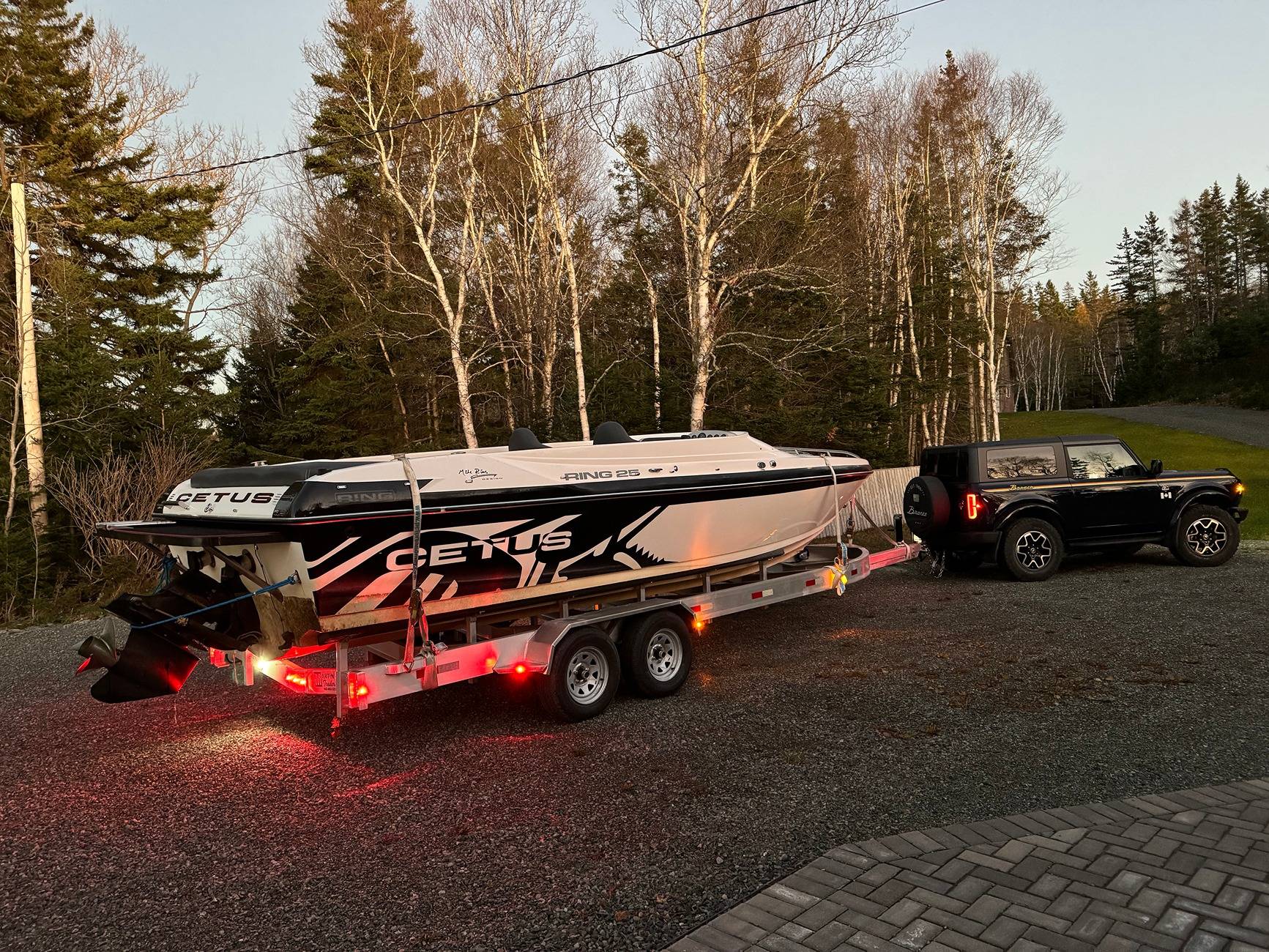

Towed my boat (RING 25) home from the marina today. No issues. Makes the 2 dr look small for sure! Light for the size 2,800lb and trailer 1,200. My 2021 Outer Banks has 127,000 km on it already. Roush gear is good, performance tune (Ford Performance) a must. JCG
