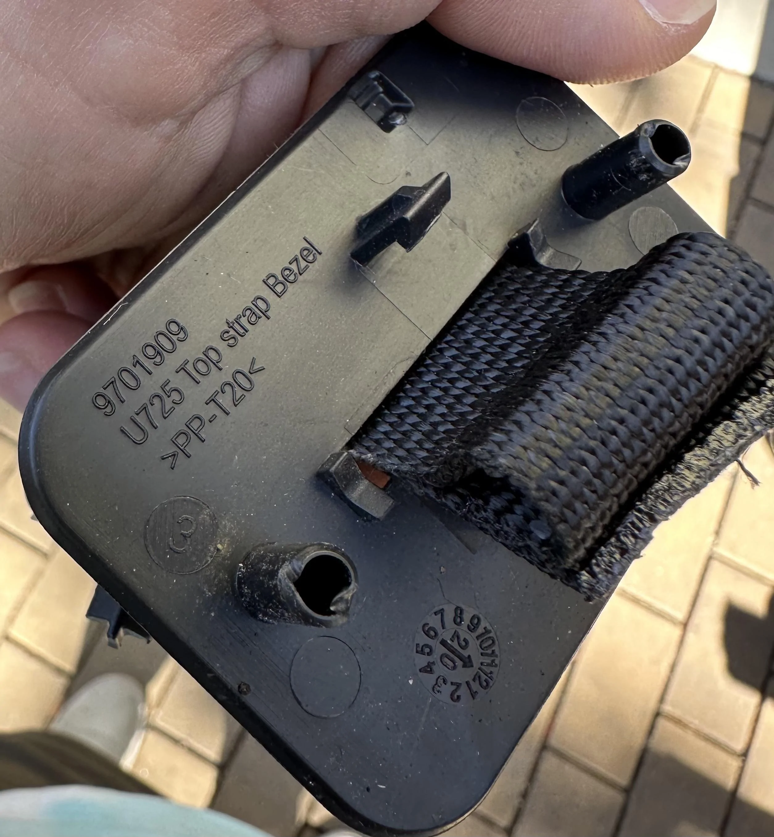

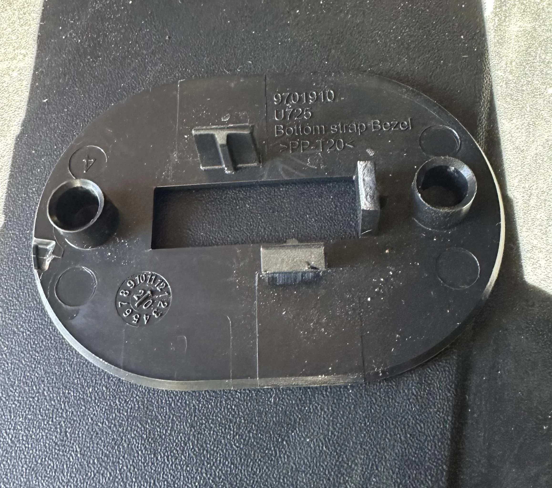

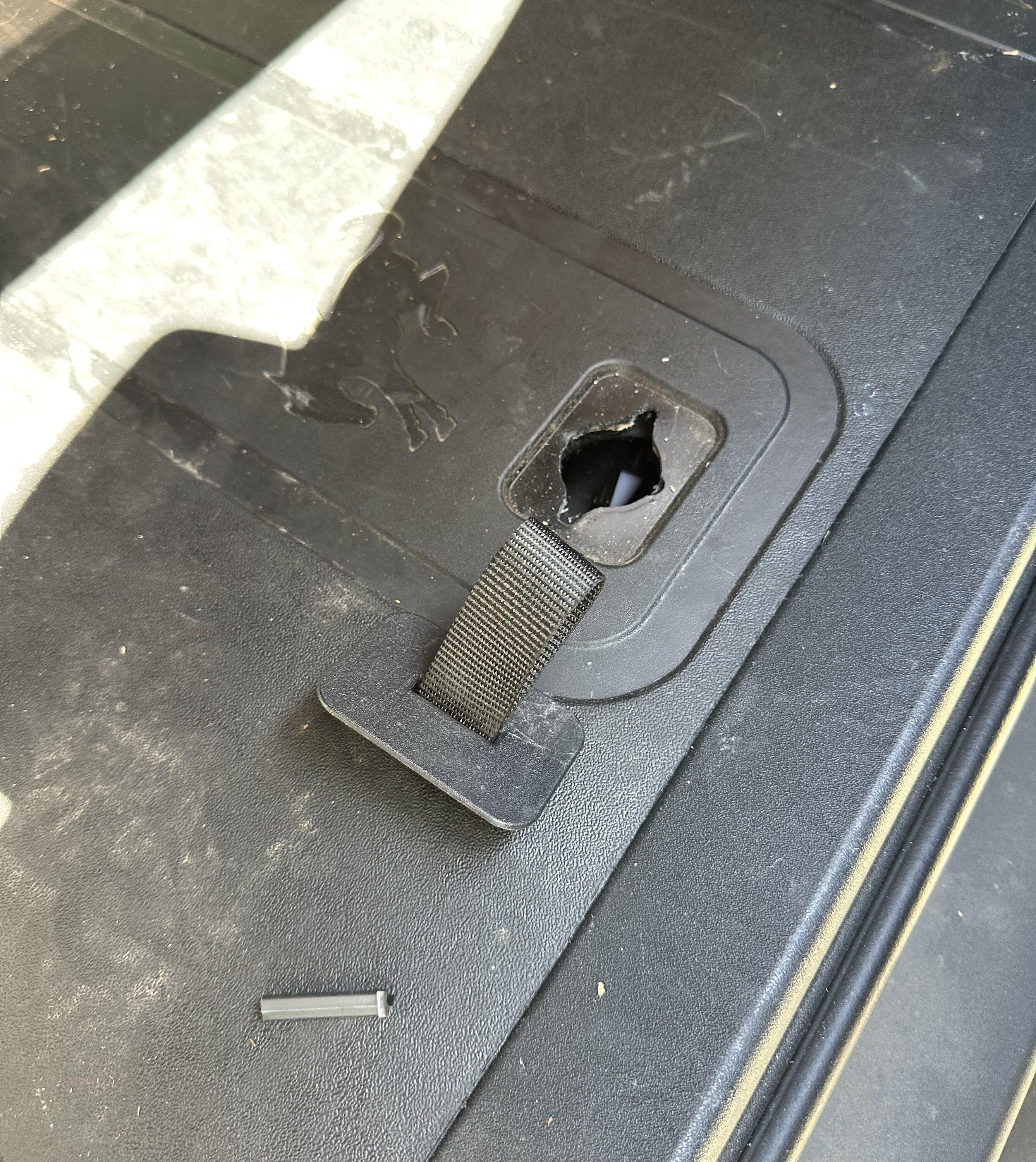

Looking for a replacement part number for the plastic pieces that secure the vinyl strap to the trunk bed flap that lifts up for storage + access to the scissor jack. I lifted mine yesterday, and it snapped apart without any resistance. Wondering if I somehow broke it on my last trip or if the recent heat just weakened the plastic tab enough that it snapped off. Does not look very strong or rigid now that itā€™s apart šŸ˜…

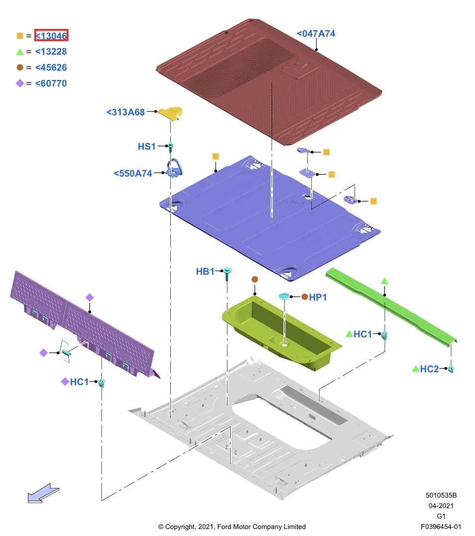

Canā€™t get it separately unfortunately. Comes as the whole thing. Everything with the yellow square in this picture. Part number is M2DZ-7813046-B

Hard to say. Iā€™d try anything to fix it though especially considering the price of that whole part. Looks like north of $500 šŸ˜±

I doubt gorilla glue will cut it. Iā€™d be better off hacking up some other sort of dowel or something and stapling it to the strap, but itā€™s still a pretty poor design to begin with.
$500 for a fiberglass floorā€¦ might as well go with Goose or AAL for that price and never worry about it again šŸ˜…

Mine broke a while back because I set a cooler there. I just have a hole there now and itā€™s been fine.

I used super glue to hold the pieces together after my dog stepped on it while I was trying to get under there. It's stronger now than before it broke.
Don't worry about the clips that broke. Super glue the plastic guides on each side that slide onto each other.
The clips didnā€™t break. The only thing that broke is the little handle that connects to the strap itself. So Iā€™ll probably try adding a wooden dowel and gorilla glueing the strap to it.
The dowel on mine must've snapped and I didn't notice.
The spot where it's sown to itself is thick enough to hold it in on mine. Maybe they made the slot skinnier on 23's?

Piss poor design. My clips broke, but I glued the two larger pieces together. Guess Iā€™ll sit back and wait for the strap clip to snap off next.

Metal plate on the back, drill a hole on 4 corners through the top plastic and bottom metal and pop rivet that sucker
