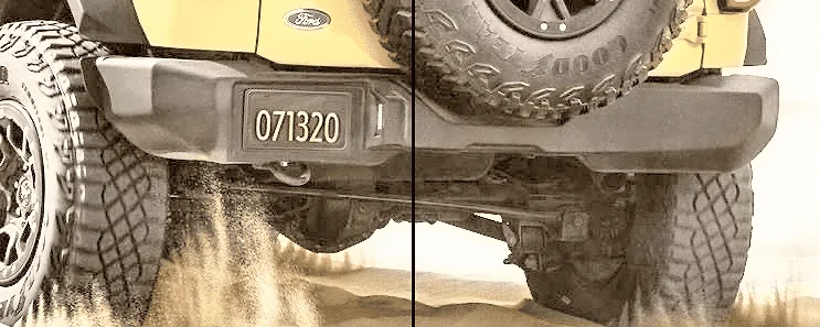

I sure hope that Panhard Bar gets closer to horizontal with the body installed. As it looks here I would want to buy a drop kit for it.

One 3/8 Grade 8 bolt has a single shear strength of 9930 lbs at a minimum. I honestly see no problem with the mounting of the recovery points shown. I get the feeling anybody who regularly gets themselves into situations that stresses these to their limits has either significantly modified the vehicle enough already that using aftermarket stuff anyways or they're doing stuff they really shouldn't anyways.

Iā€™m no engineer but I find it super hard to believe that 2 3/8ā€ bolts (There May be 4) would snap off before whatever line towing it would snap

So I am looking at that rear frame member and the the receiver. Ford said Class II receiver, and it looks similarly constructed compared to the four bolt 2ā€ Jeep Class II receiver that was on my JK. I recently swapped mine out for a heavier Class III four bolt. The primary difference being front and rear plates are welded around the receiver tube, whereas like my OEM JK, this Ford one only the front plate appears to be welded around the tube.
I guess Ranger has 3500lbs without the heavy duty hitch which is bolted approximately where the tow hooks are bolted here?
