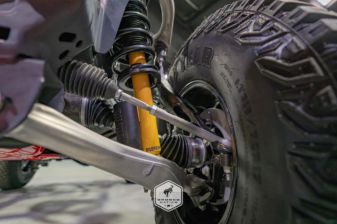

It’s what I do not see that really upsets me. Big tough Bronco, no grease fittings on the ball joints or steering linkage. Why is this!? Can Ford not afford to do this? Or do they want their trucks to wear out before their time. I know what the front end of a “Super Duty” looks like at 150,000 miles and it is not pretty or inexpensive to repair. Thanks Ford for keeping up the great work by giving us less than the best available once again.

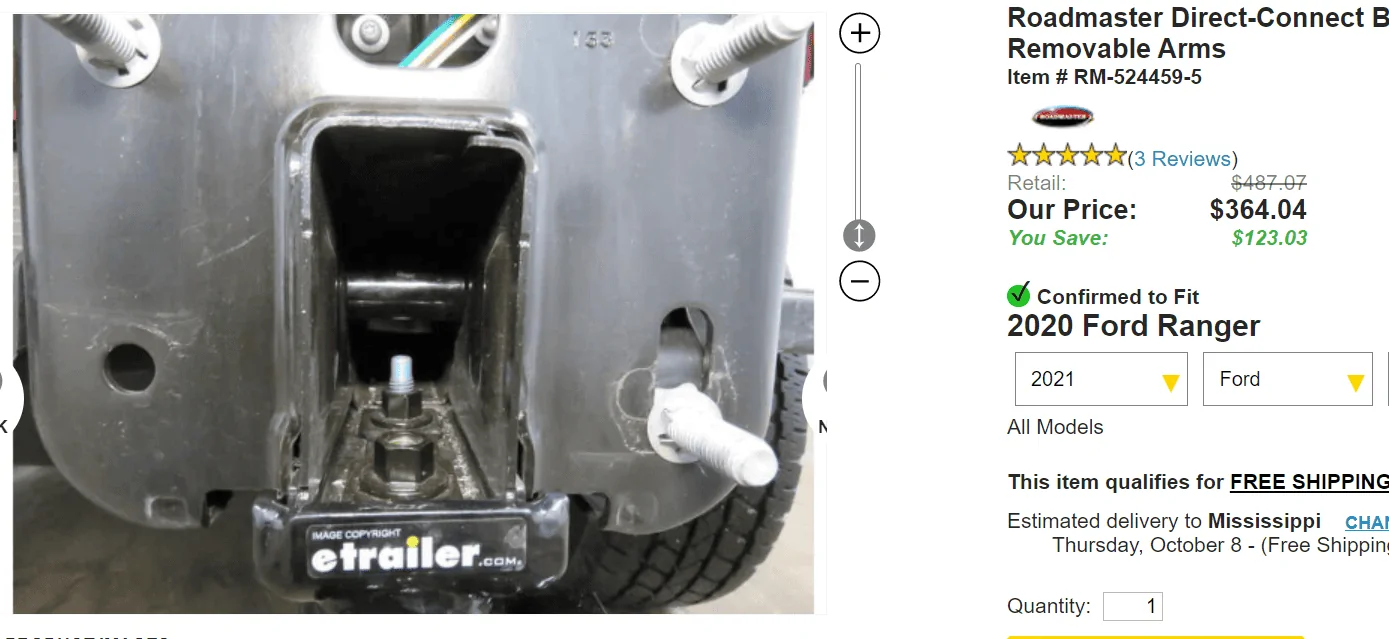

you guys need to chill out on the tow points. You really think those wouldn’t be strong enough? ?
and the frame “hoop”. Seriously NBD. There is likely virtually very little driveshaft displacement at that point. Not worried about lifting.
and CV angles? Said already but cmon use your noggin. The thing has no body or powertrain in it!
Yeah, I'm not wrong...

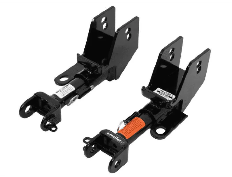

The Ranger has this as the tow connect and it does not use this plate for flat towing.
This is the same plate-to-frame as on the Bronco.

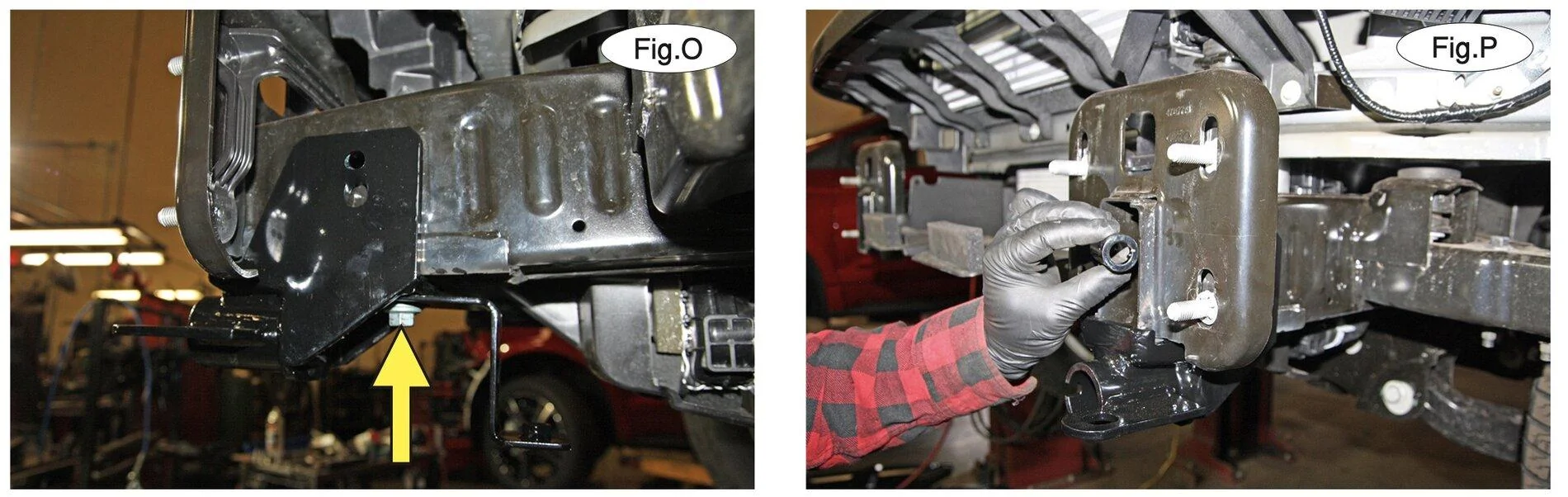

I concur. From the instructions on that kit they use the tow loop bolts on the bottom of the frame and a through bolt through the frame with a beefy spacer to eliminate crushing the frame. So three bolts directly attached to the frame.
Not just ford...the whole industry has gone that way for many years now. I'm not sure why, but I suspect politics are involved. Good news is aftermarket parts are unaffected!

What in the shit is up with the CV angle? That can't be production angles. Even the outer tie rod is angry.
View attachment 43575 View attachment 43575
Coming from a lifted IFS Jeep Grand Cherokee thats the first thing I noticed as well. I understand that the vehicle is unweighted at this point, but I wonder how much lift is possible before those angles get too much. Im sure that RCV will have something coming out though for these though.
I understand that, doesn’t make it right and shouldn’t have to put aftermarket parts on just to be able to maintain chassi.
It's just the way the industry is now...better question are ball joints replaceable? or do you gotta buy the A arm? that's becoming commonplace now as well...and sucks!
EDIT: upper appears replaceable...lower does not. AAAARGH! On the plus side I do not see an IWE in this pic!
