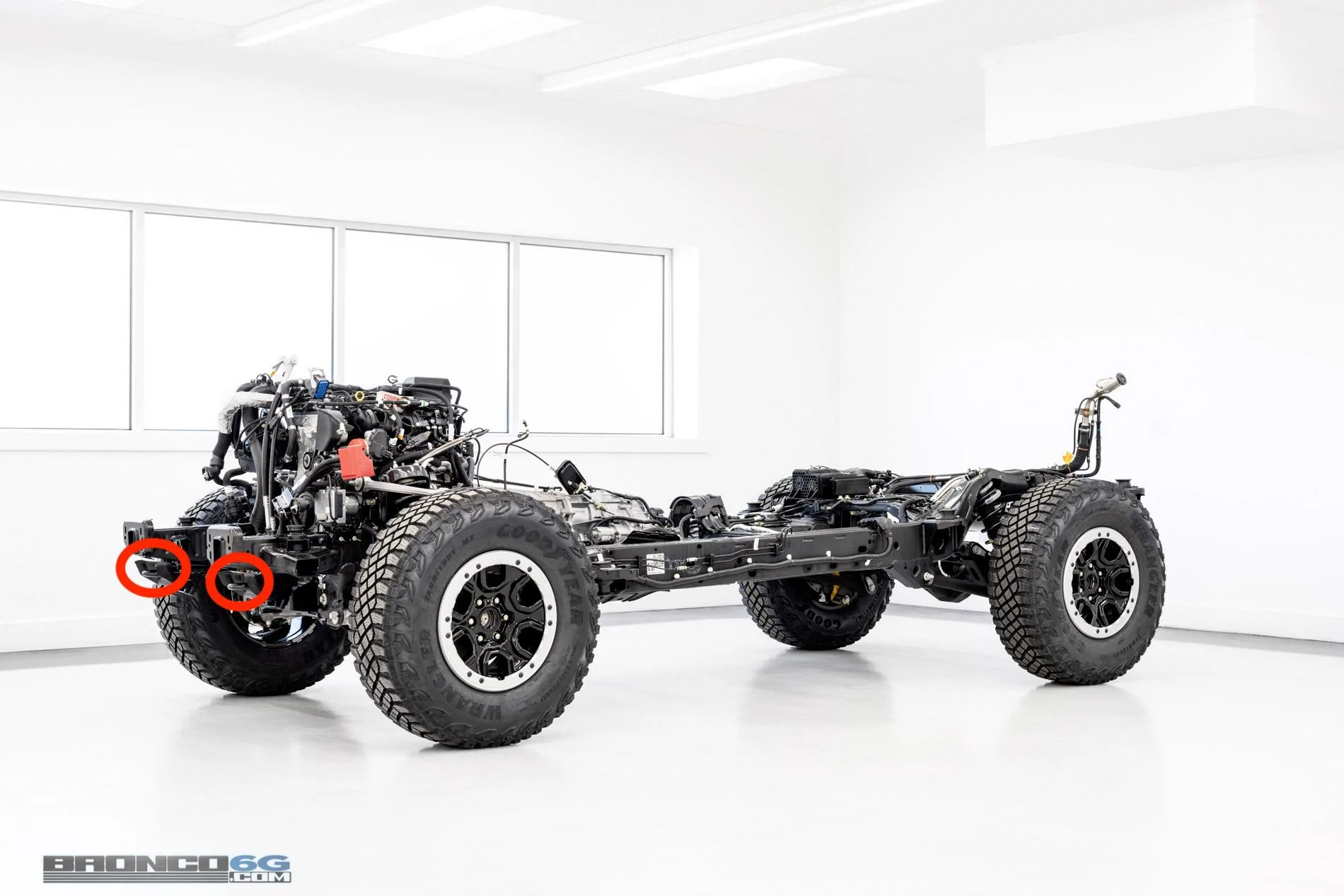

I'm not happy about the tow points. Doesn't look strong enough to tow the vehicle 4-down using that attachment point. Tow hook points should have the bolt sheer not the thread strip for failure. We shall see, but this will need some modification as it is now before I'm comfortable towing this around.
Ford stated the tow hooks would support the entire vehicles weight, that would be much more than the rolling resistance from flat towing. But like you I will be taking a close look at that before I hook it up.
Thats good info. What is the context (do you have a link)? From what I can tell these seem to be what Ford calls tow hooks - mounted to the frame with 2 M8 or M10 bolts:
Ford Bronco Pics: Bronco Frame, Chassis and Suspension tow_hooks_front_bronco_parts_02-
Ford Bronco Pics: Bronco Frame, Chassis and Suspension tow_hooks_rear_001_bronco_parts_03-

Thats good info. What is the context (do you have a link)? From what I can tell these seem to be what Ford calls tow hooks - mounted to the frame with 2 M8 bolts:
It was in a Video interview with Ford rep I was watching. In any case this is not what the HD bumper has, it has the D ring and pin. Removing the pin and D ring allows the BlueOX off road adapter to replace it. I will have to actually measure the mount stud to be sure the adapter will fit, BlueOx does make two different sizes of adapters, 3/4" & 1" pins. Looks like the stock bumper will need a base plate kit and I don't think after market has caught up with that yet.

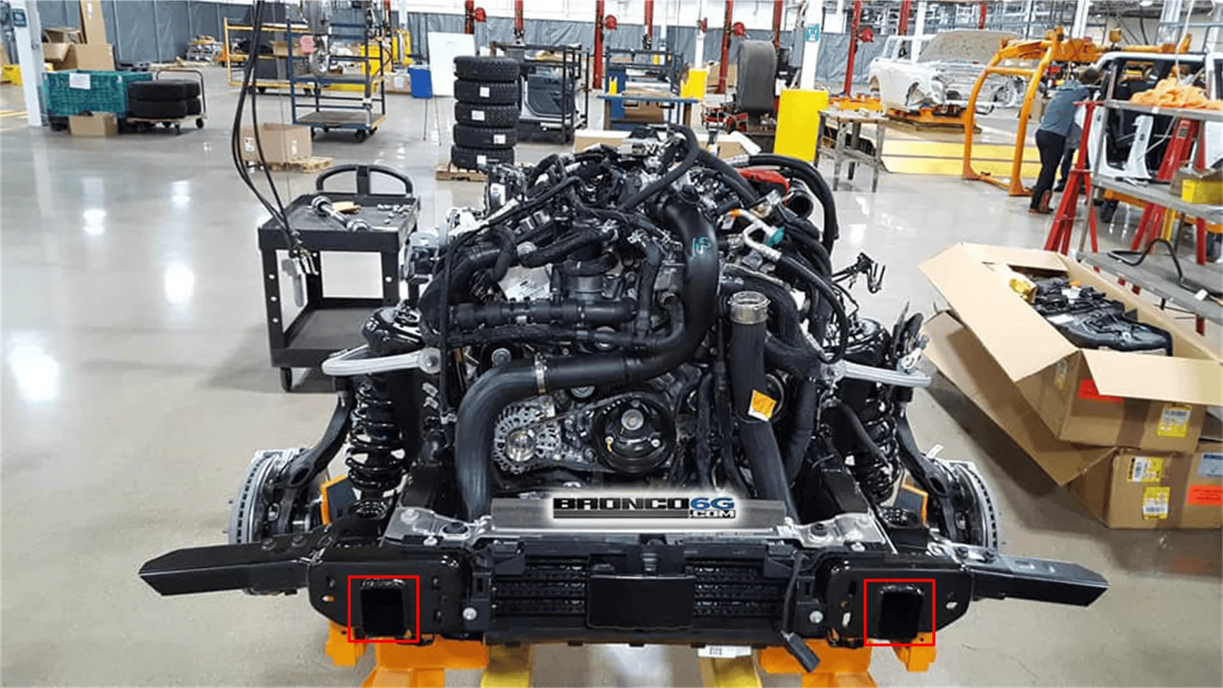

Here is a head on shot of the front box frame openings for tow adapters to your hearts delight.
Ford Bronco Pics: Bronco Frame, Chassis and Suspension Front Frame Openings
Ford Bronco Pics: Bronco Frame, Chassis and Suspension 2021 Ford Broncon Engine chassis-1
Imagine the vehicle is stuck in mud, and you need to winch out using that attachment point. That'd be the true test of that attachment point.
Rolling resistance is one thing, but fatigue and acceleration/deceleration are a different matter. I'm not familiar with any flat towing attachment point that does not bolt into a frame rail or through a crossmember somewhere.
