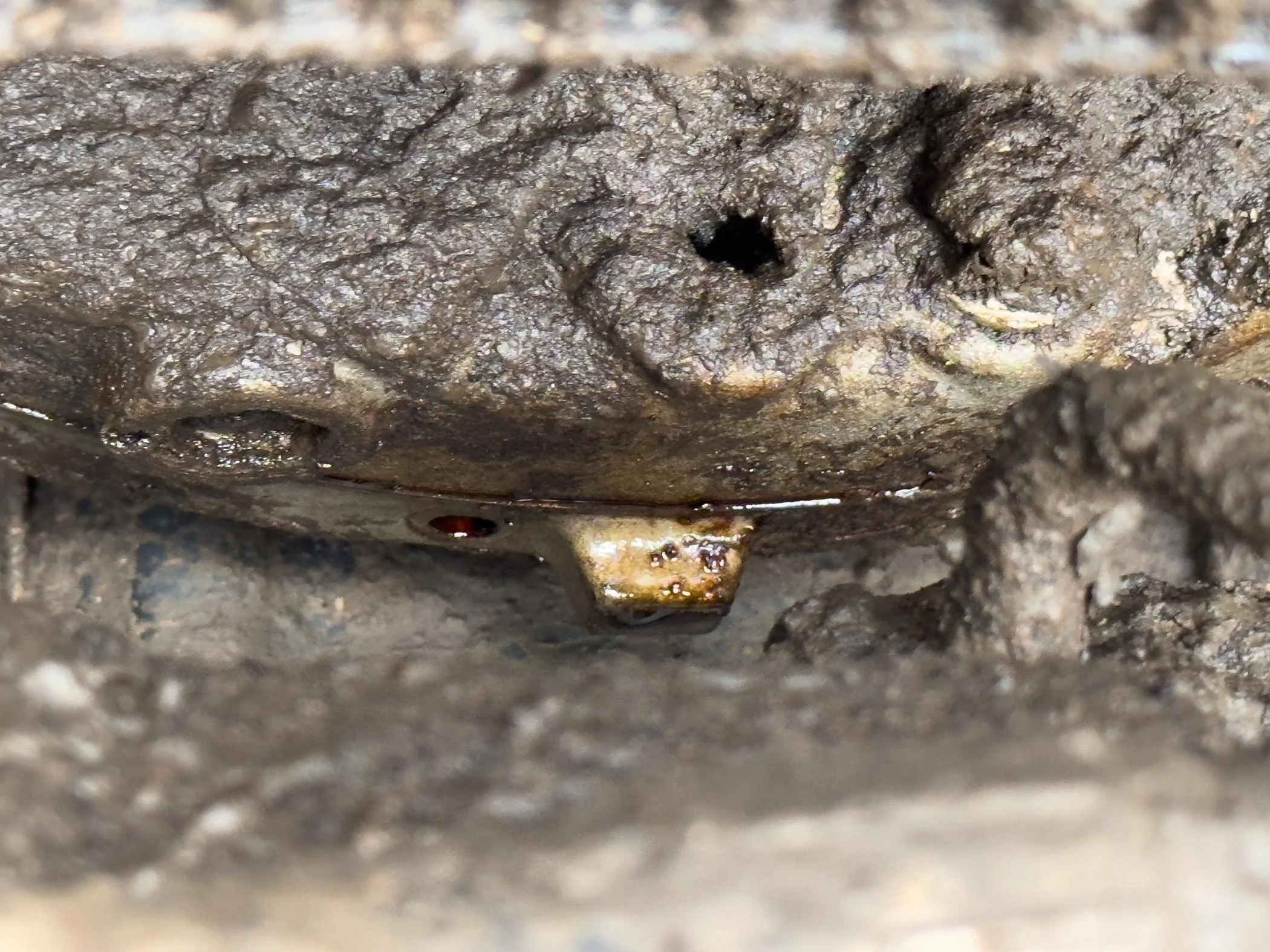

Please HELP! Oil leak!

If the dealers near you are busy I recommend just make an appointment- even if it is further out. At least you will have an appointment. In the mean time, clean up the underneath and see if you can detect where the oil is coming from. I could not see from the pictures, sometimes a sloppy oil change will leave oil splattered underneath that will make droplets. Also check the oil drain plug. Look for the basics first. The more you can do to isolate what is going on, the easier it will be for your dealer to confirm and fixt it.

That most definitely did not start yesterday and looks like it has been leaking for months.

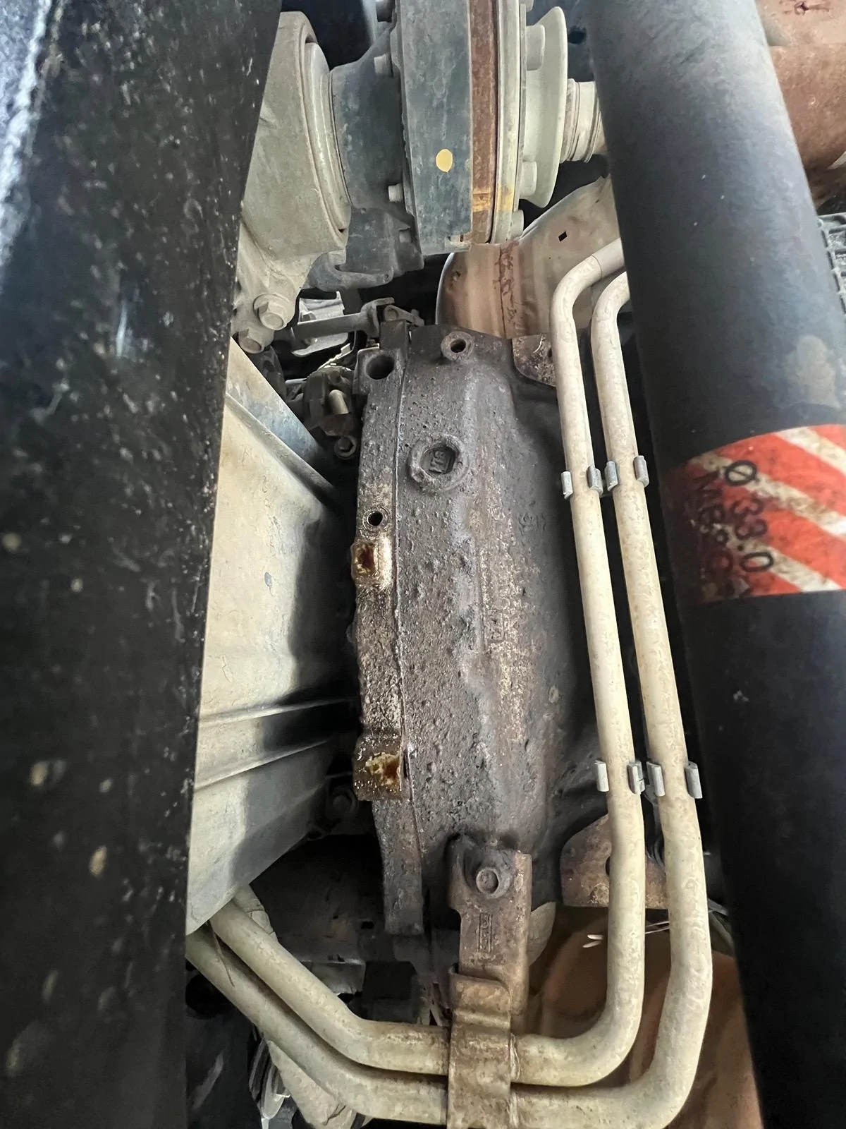

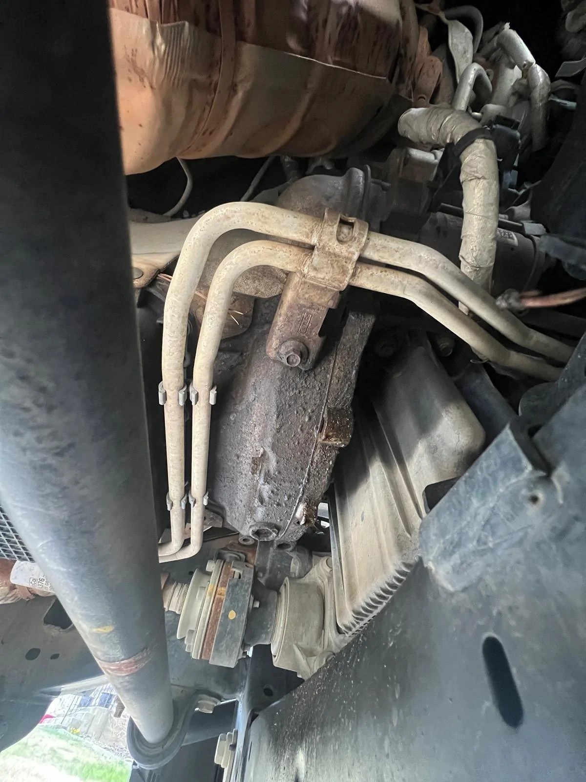

Ugh…I have the same leak. Noticed some drips in the driveway the last few weeks. Looked underneath today.
You seem to caught yours early on, after the dealer fixed my repair I had to go back after 2,000 miles for the same issue. So keep an eye on it. If you take it in for warranty repair and get denied, go to another dealer because that's what I also had to do. They try to deny me because of my Ford performance tuner and my lift kit and 37s. Most time service advisors pretend that they're ASE technicians

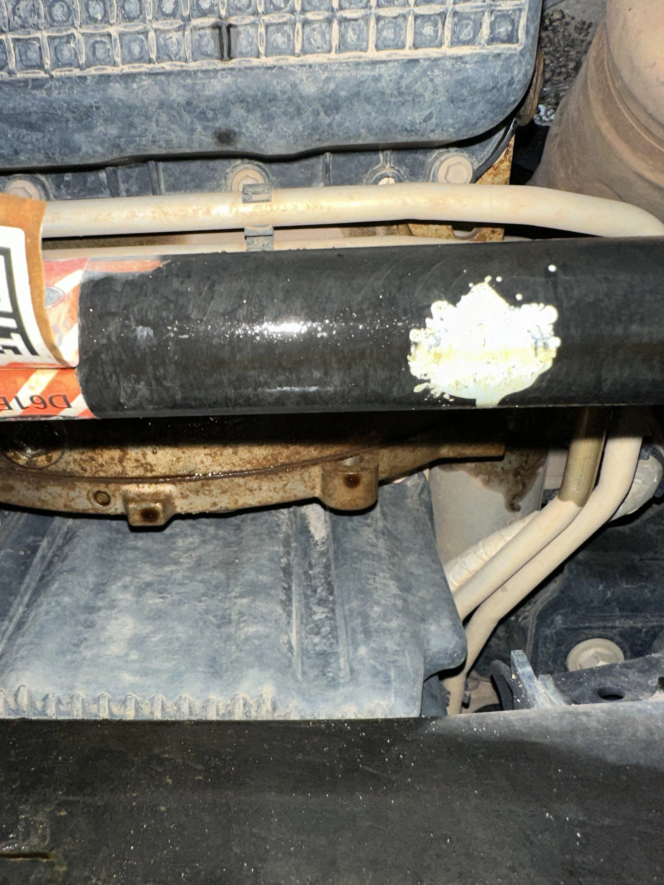

36,600 miles. Went to perform an oil change and discovered what looks to be a rear main seal leak :( yes, I know it’s muddy under there.
