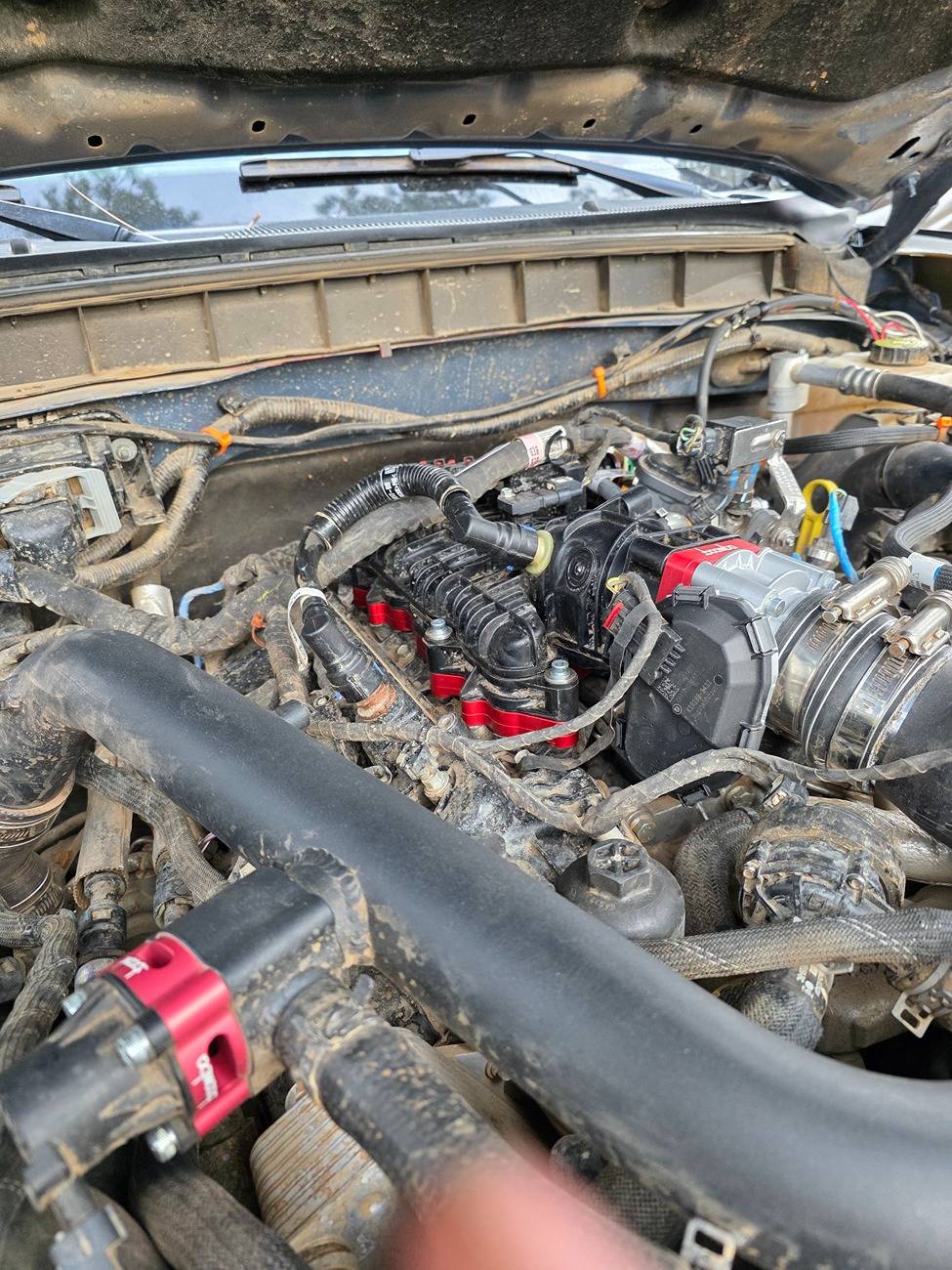

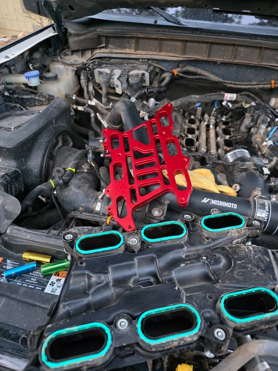

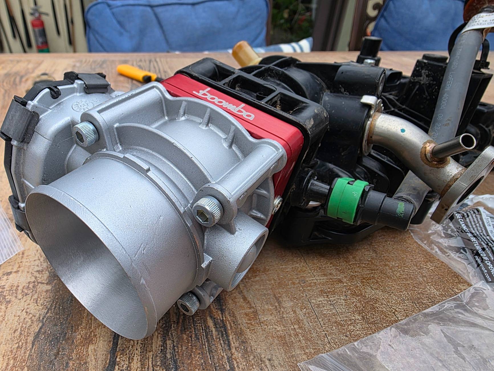

After all the typical add on's (CAI, Charge Pipes, Fast Intentions cat back, Pro Cal Tune) I did add a Boomba manifold spacer, bigger GPE throttle body and a throttle body spacer on all at once. It woke up the throttle response to another level. Claims +17HP on just the spacers.
I should be about +100HP all together.

Nice..... but that looks like a V6. The 2.3L is what's being discussed in this section/thread.

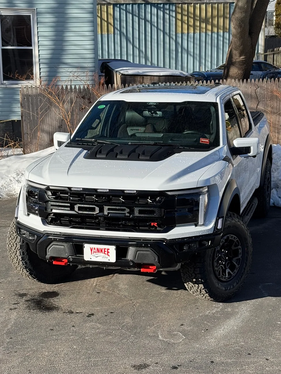

Thought I’d revisit this thread, her 2021 Base 2 door 7 speed is STILL in its factory stock configuration. It’s her second vehicle so not a daily driver but STILL looking at a few upgrades. The power thing is no longer a big issue since her new rig just just arrived :bandit:
….the quiet stock exhaust note just has to go, not looking for anything loud just something to let you hear the rpm’s and know your shift points a bit better.
…still running factory shocks and would like to upgrade to some Bilstein‘s but NOT wanting to lift it (I’ve been a loyal Bilstein shock buyer for almost 30 years and installed 20 sets or so on personal and family trucks).
her new wheels…
Ford Bronco Power add mods? Header, tune, Shocks, what else? IMG_5043
