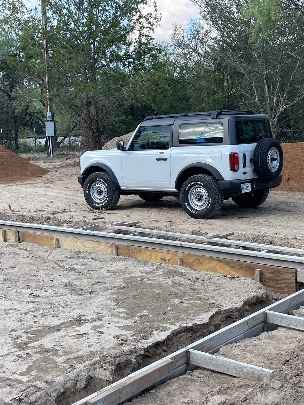

Header ? Tune ? What else ?
thanks

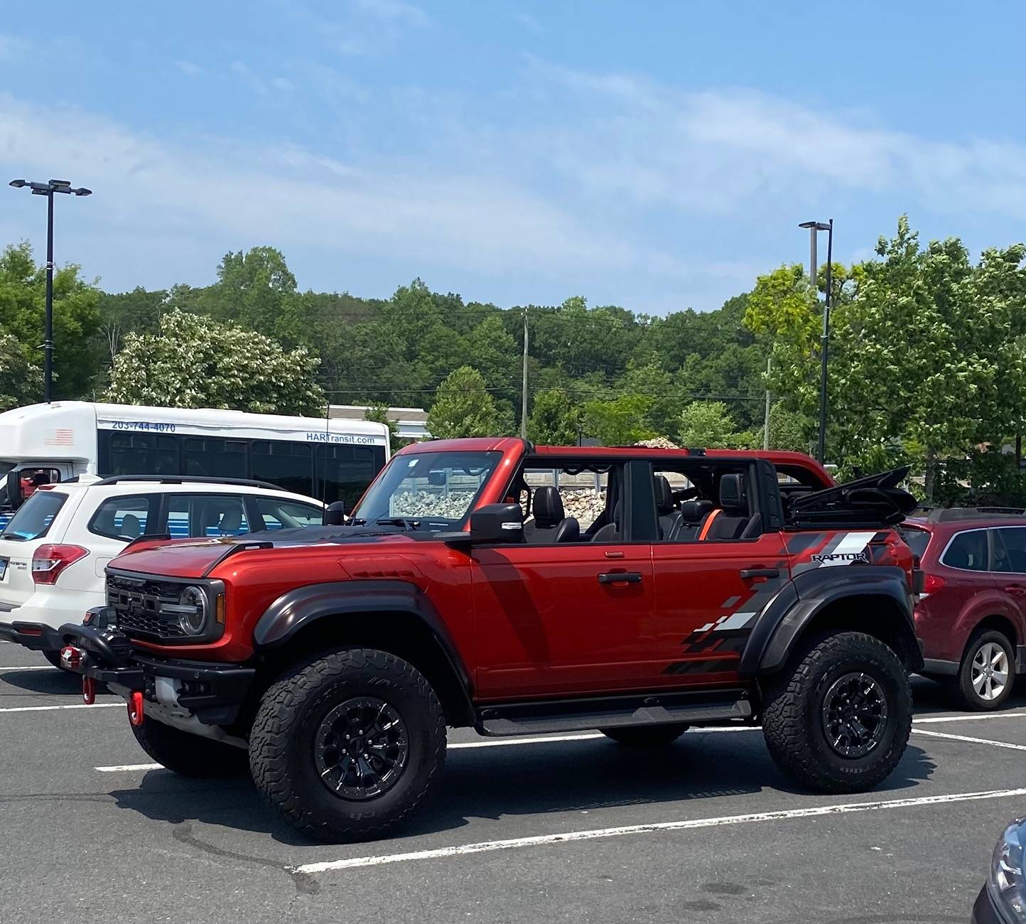

Obviously…
I was seriously considering trading this OBX for a Raptor, but I changed my mind. I'm afraid it will make me a nice person instantly, and I'll start waving at people. I don't want to be nice. There are plenty of nice people out there, they don't want me in their ranks.

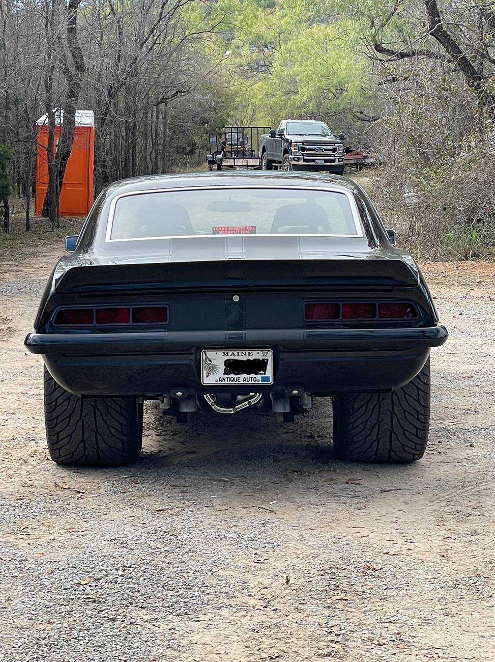

thanks but probably not the case here…
My wife’s driving style is wide open, rowin’ thru those 6 gears. You should see her driving my hot rod :wink:
