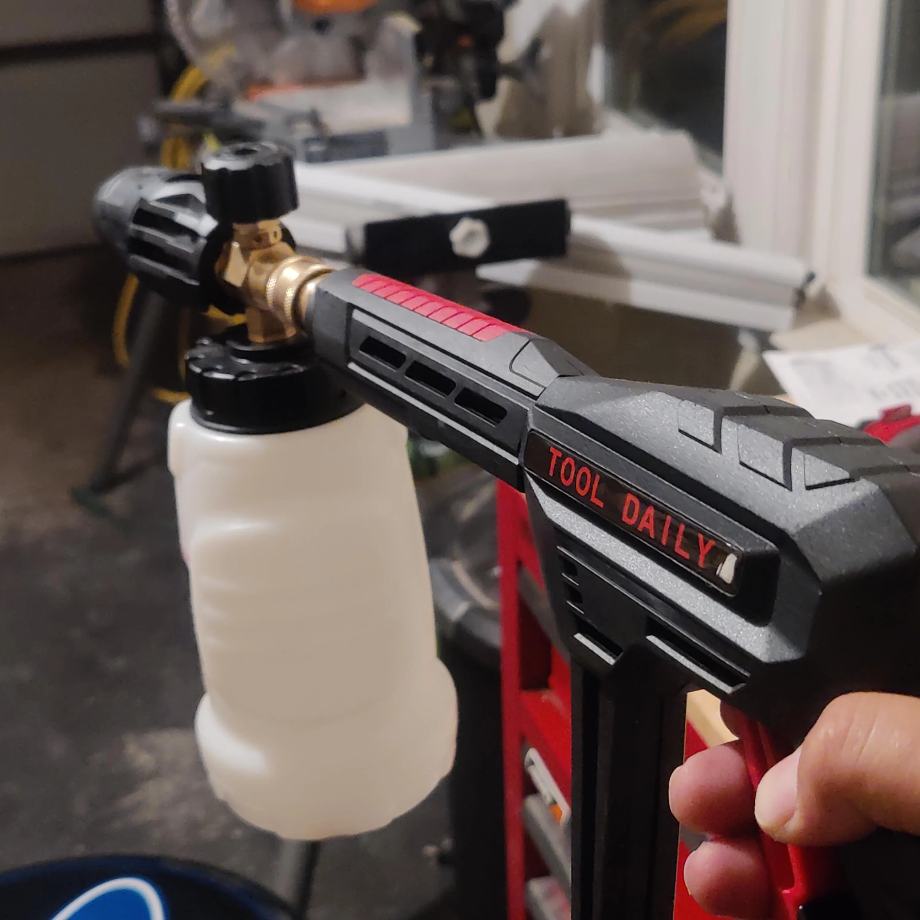

Ive got a cheap electric $90 ryobi pressure washer and dirt cheap foam cannon from amazon.
Works great.

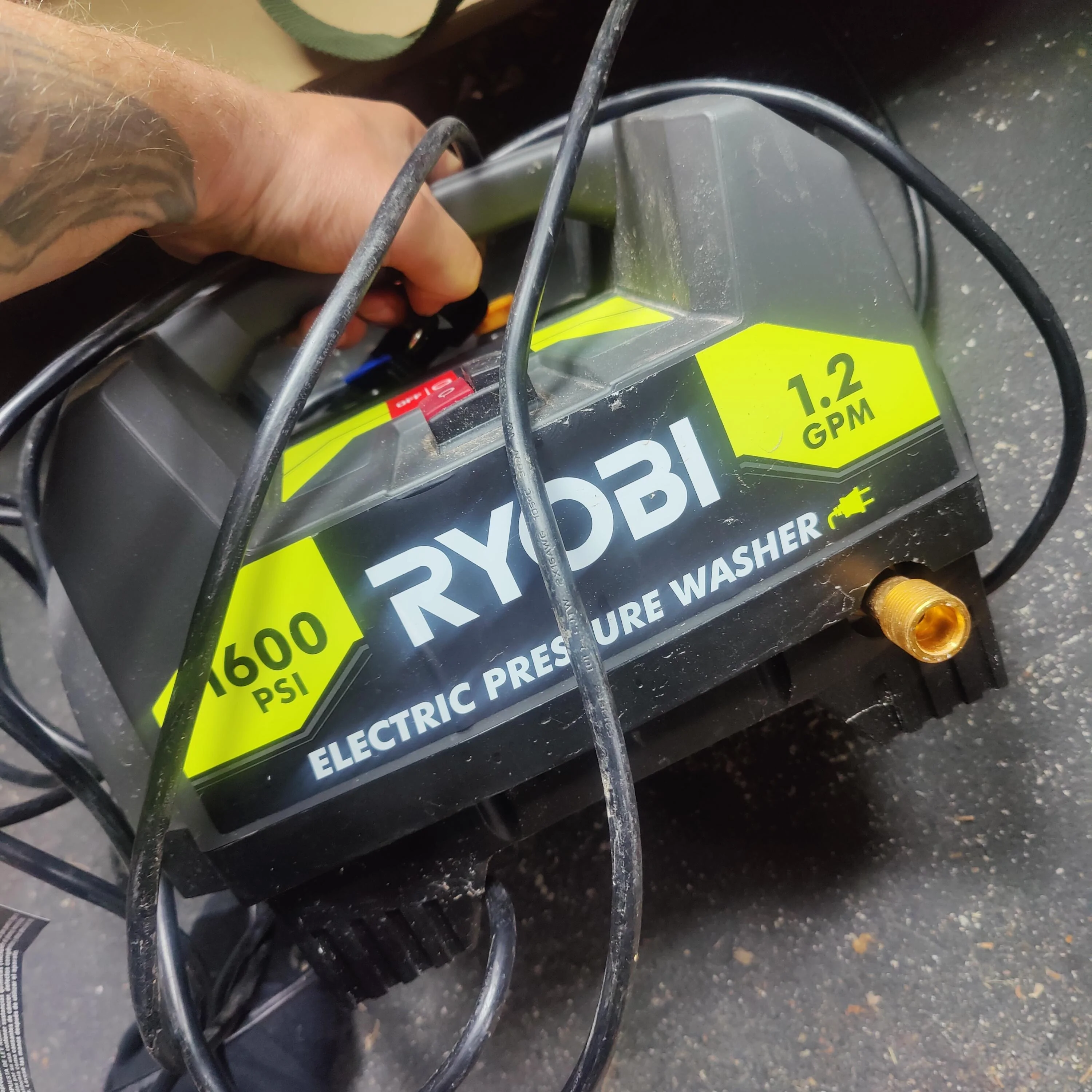

With my electric PW, when everything is on (water and switch), and I’ve already bled all the air before cutting it on, mine will cycle on and off when not pulling the trigger, it’s a bad valve, it normally cuts off when it reaches pressure, but the valve is leaking pressure back into your hose, causing it to cycle on and off.

Are you using an extension cord or is it plugged directly to an outlet?
The sound is similar to when my pancake compressor for trim carpentry is not getting enough amperage.

direct to plug in the wall

Does it run when you pull the trigger? I mean it sounds like it kept trying to build up the pressure in the system as the waters that are leaking out of the connector.

Your pressure side hose fittings are leaking. The unit is losing pressure so it is short cycling to keep the pressure in the hose constant. Stop the leaks and the unit will stop short cycling.

I have that same one and that is definetly seized up, return it. Mine has been great for 2 years now. remembr to turn on water let it push out all the air then turn on the switch.
