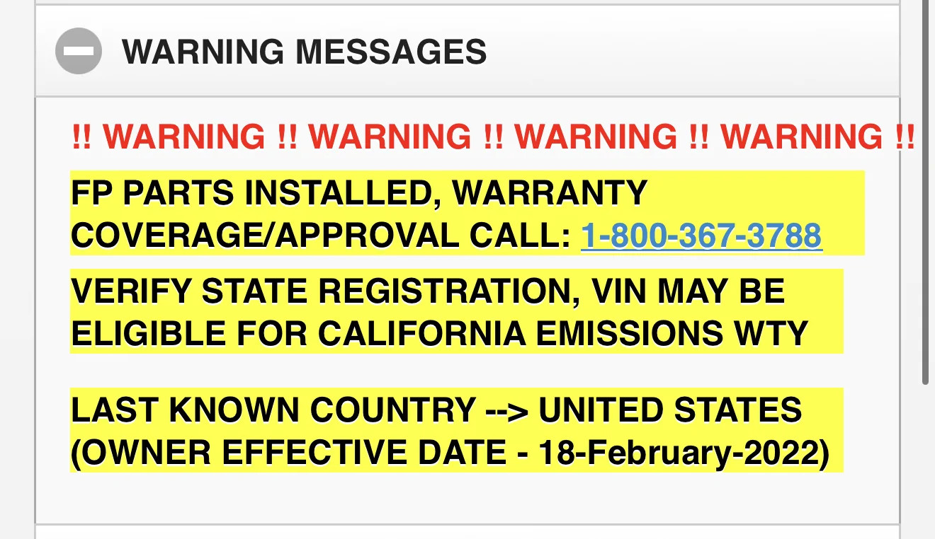

The 3/36 is for the vehicles warranty, not the device. If something fails after it’s been installed, warranty coverage and approval is supposed to come from Ford Performance instead of Ford.
Which is why there’s a big warning to all dealerships that Ford performance parts have been installed once the tune is loaded into a vehicle.
They could certainly deny it if they wanted to (although unlikely) without the correct paperwork.
This is what dealerships see every time they pull up the vehicle’s information:

Magnuson-moss act is for aftermarket replacement parts. For example: if I wanted to buy a Autozone air filter instead of Ford’s air filter, they cannot deny the warranty because of that.
It’s not for performance parts that change/modify OEM parameters.
