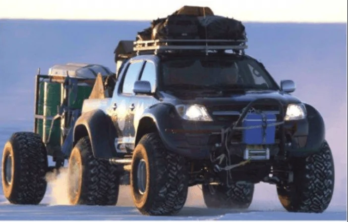

Agree but depends on the snow and if you are trying to float or get to the ground. In Iceland they run massive 44" tires to float. Tractor tires aka cookie cutters are for getting to the ground and thus better for snow in most cases. Iceland and antartica are special situations.
I am running the standard 38-40psi sasquatch tires depending on temp, bronco is staying planted going to the ski hill which is 16mile of curvy road with variable condidtions. 22psi is going to cost some gas mileage and not gain anything for this situation.

That’s a heck of a rig 😳. In those places you’re probably not reaching pavement lol.
