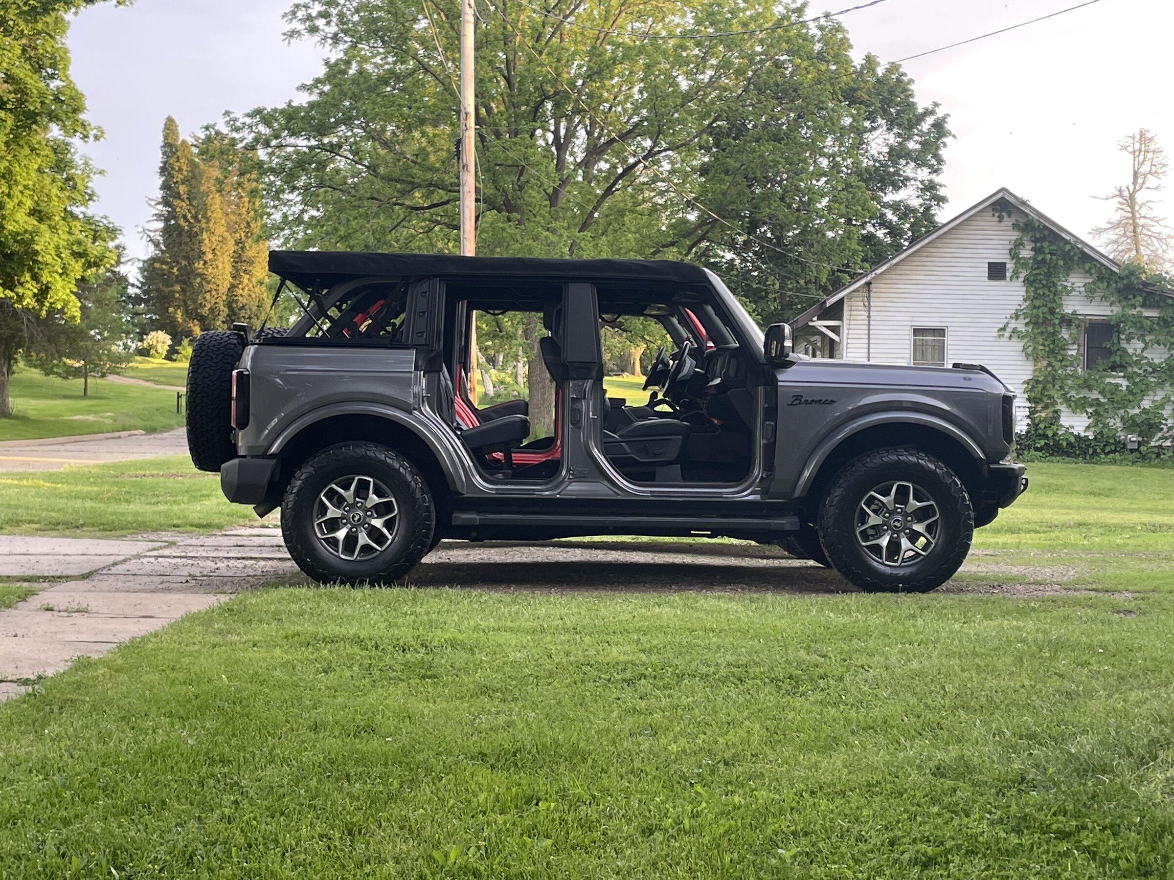

The Sasquatch has a 1.1” lift over your base. Does not get the crash bars. The badlands wheels and tires and somewhat easy to come by and have what they call 33’s 32.8” actually but fit with no lift or anything else needed and look good. But to answer your question 2” is fine, crash bars out for 35’s

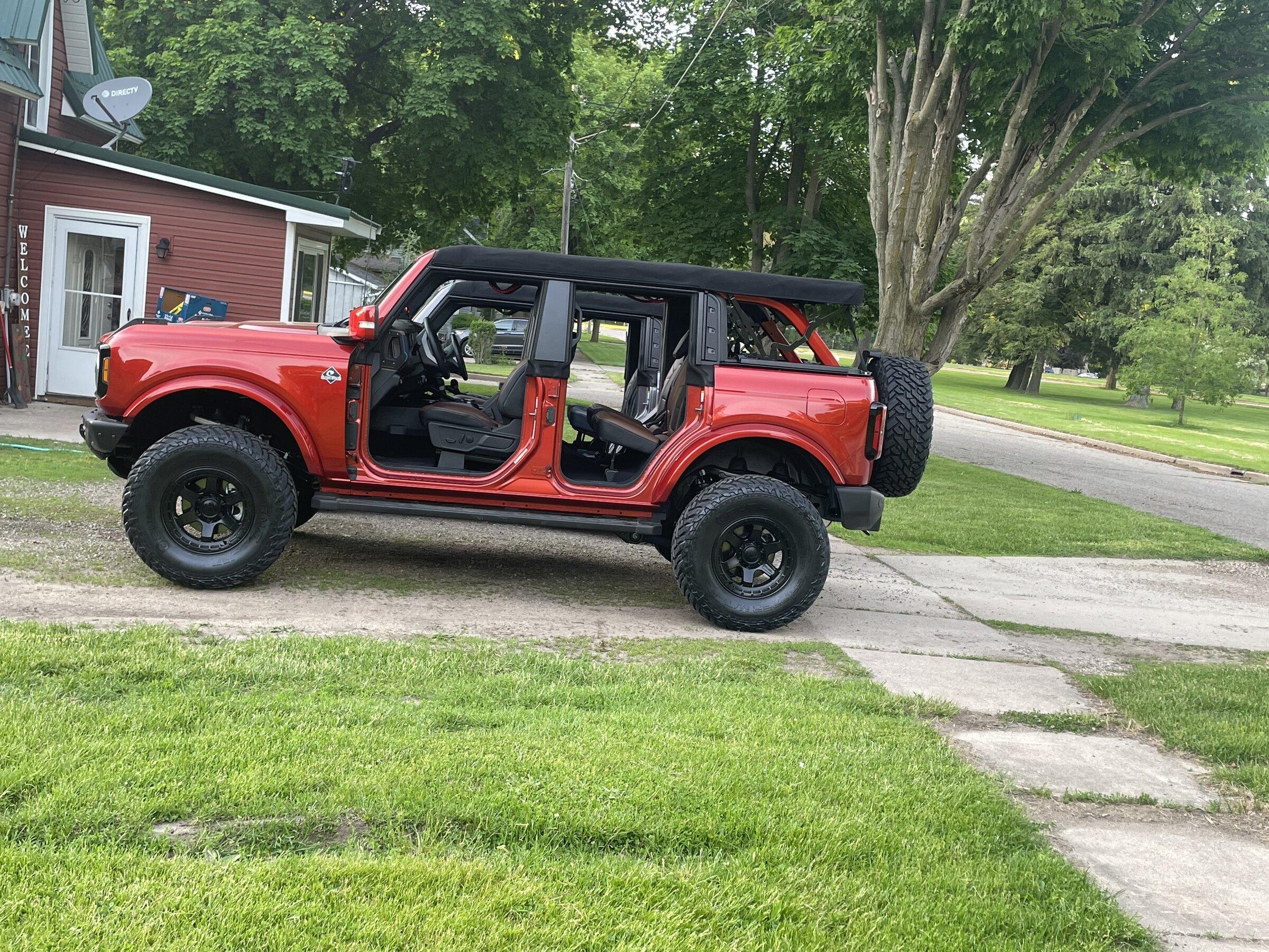

Thank you! You see the hint of red thru my bronco well that’s my wife’s as and the other person mentioned 3.5” lift, labor, alignment, wheels and tires were about what the sas package would be. But good luck finding a sas equipped bronco for msrp anywhere near me let alone an outer banks or higher trim.
. Any way here’s what throwing all that on looks like.
