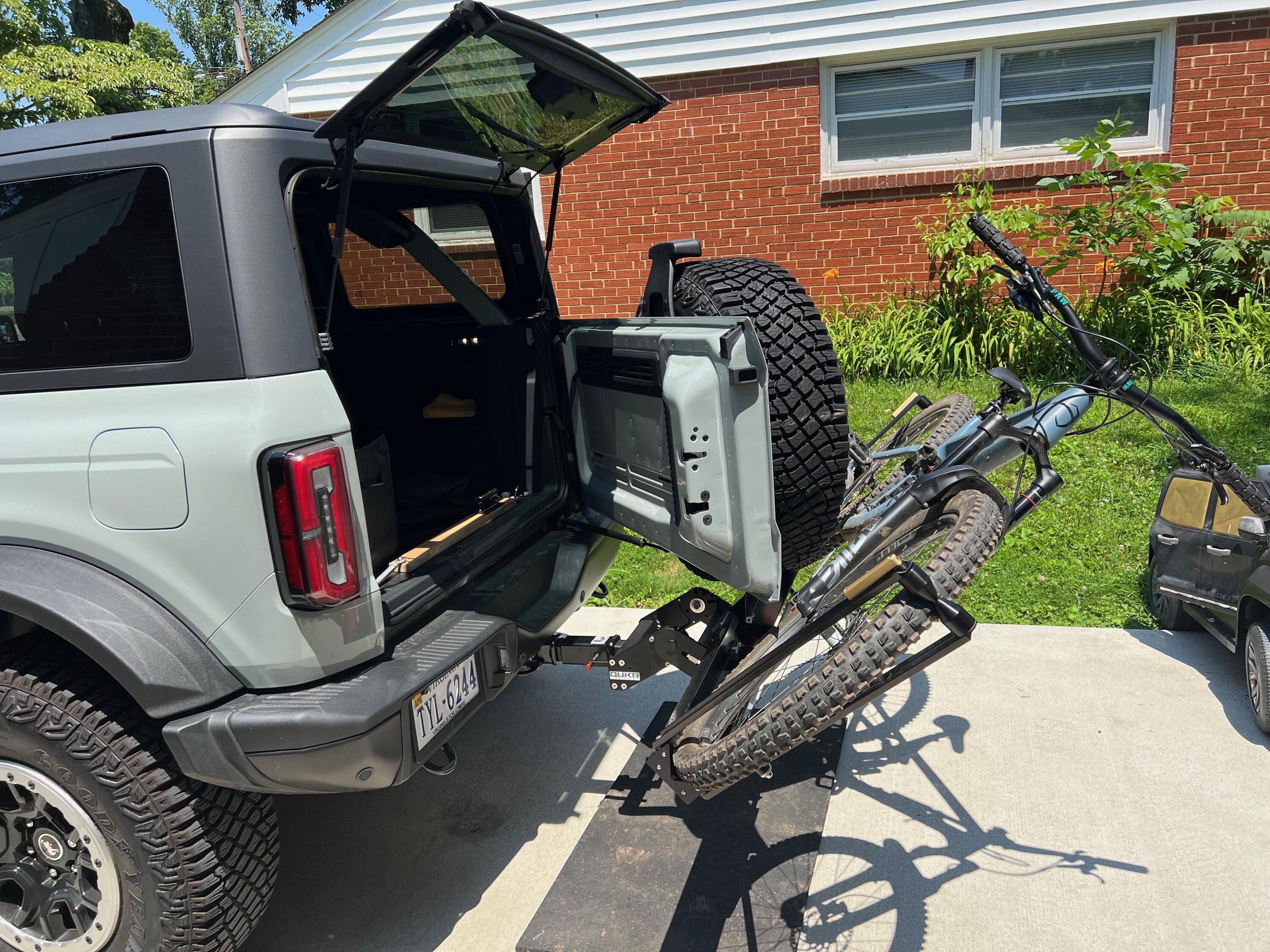

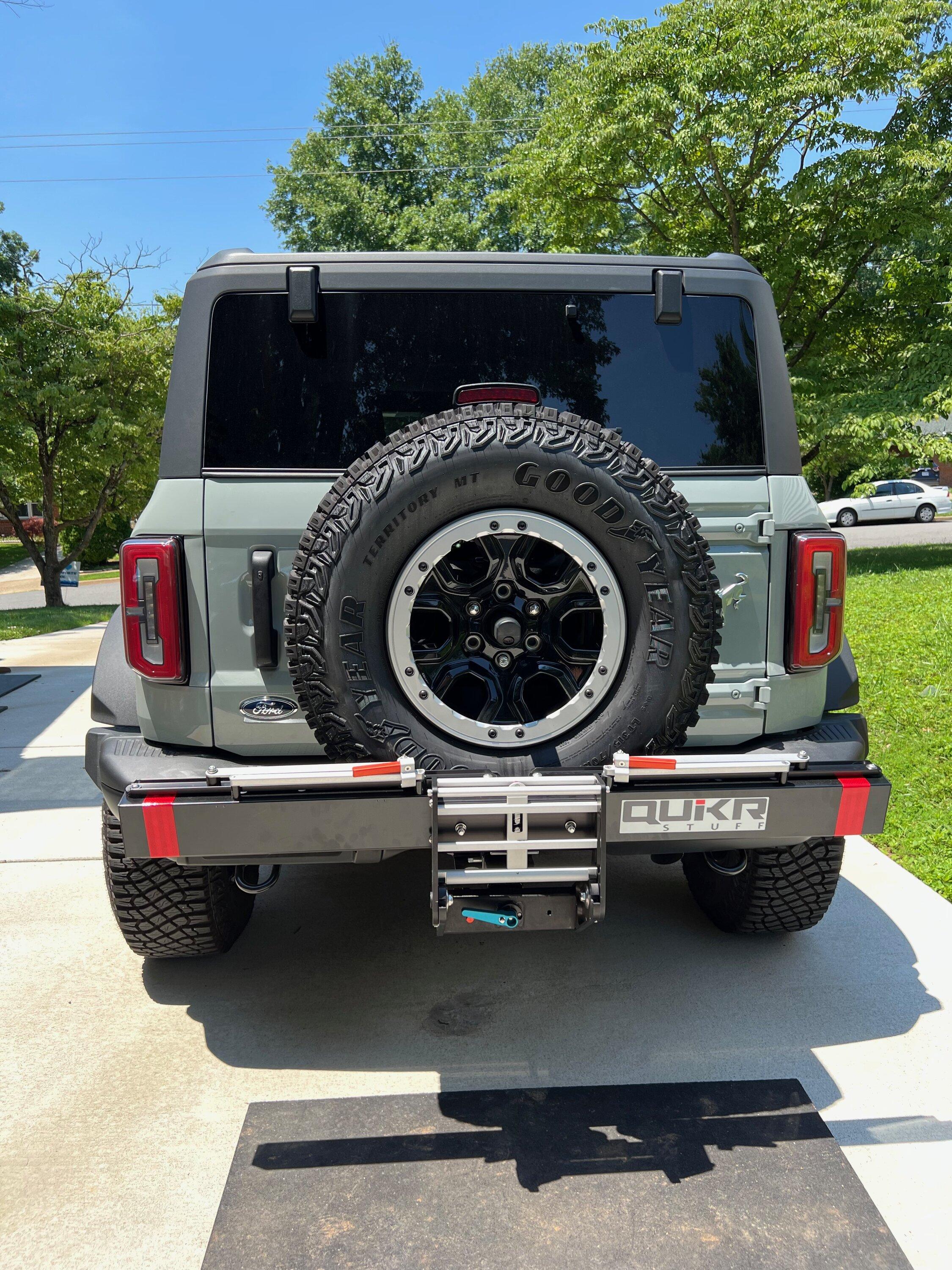

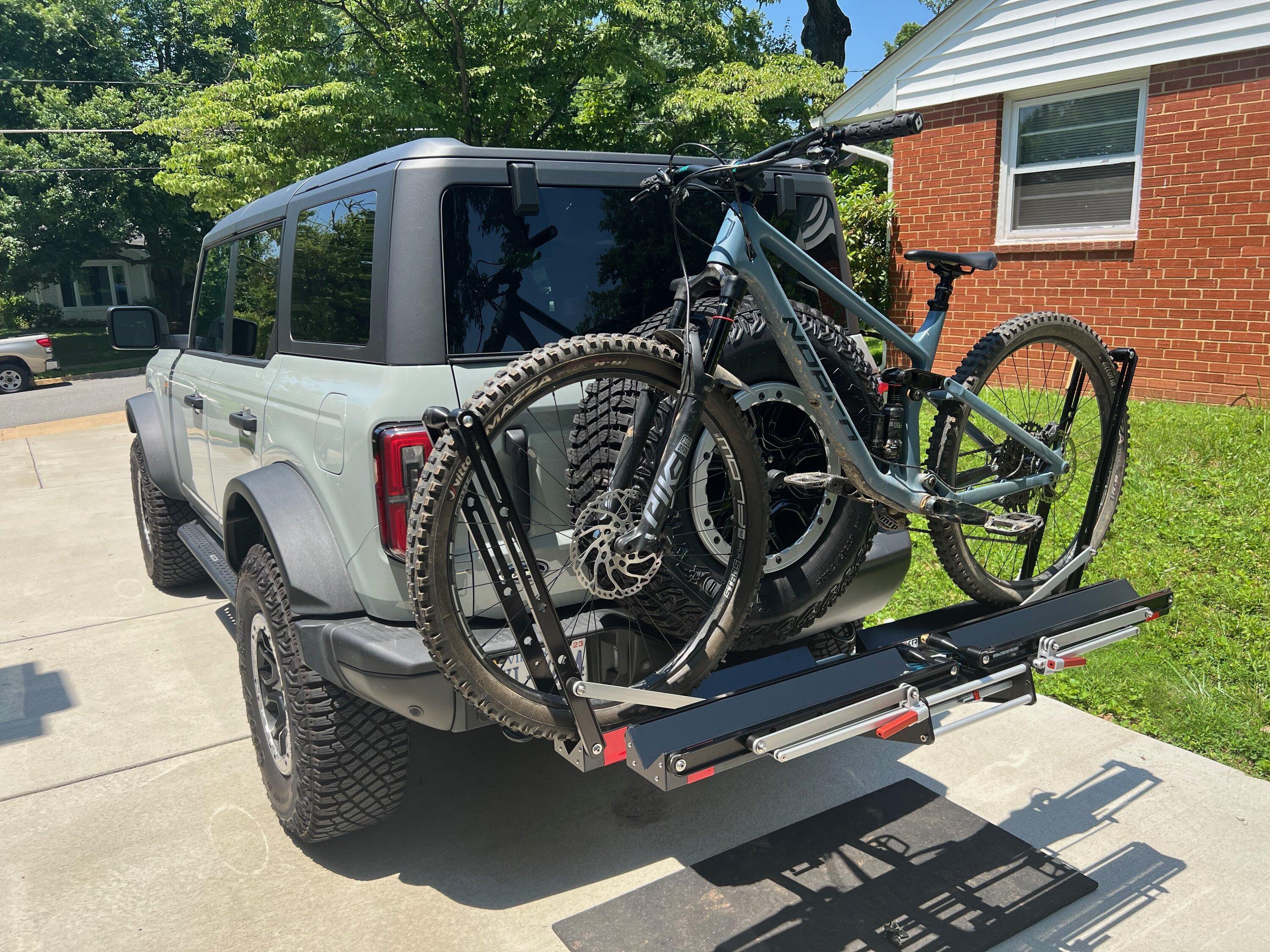

I haven't seen anyone post about the Quik Rack Mach 2 (Quikr Stuff) yet. After waiting about 6 months for it, I finally got mine a few weeks ago. For those who don't know, the Quik Rack is designed by the original designer of the 1Up rack - he took the 1up design and improved just about everything about it. I never planned on continually leaving this rack installed on the Bronco, so the Quik Rack's super modular and no-tools install were some of the biggest selling points.

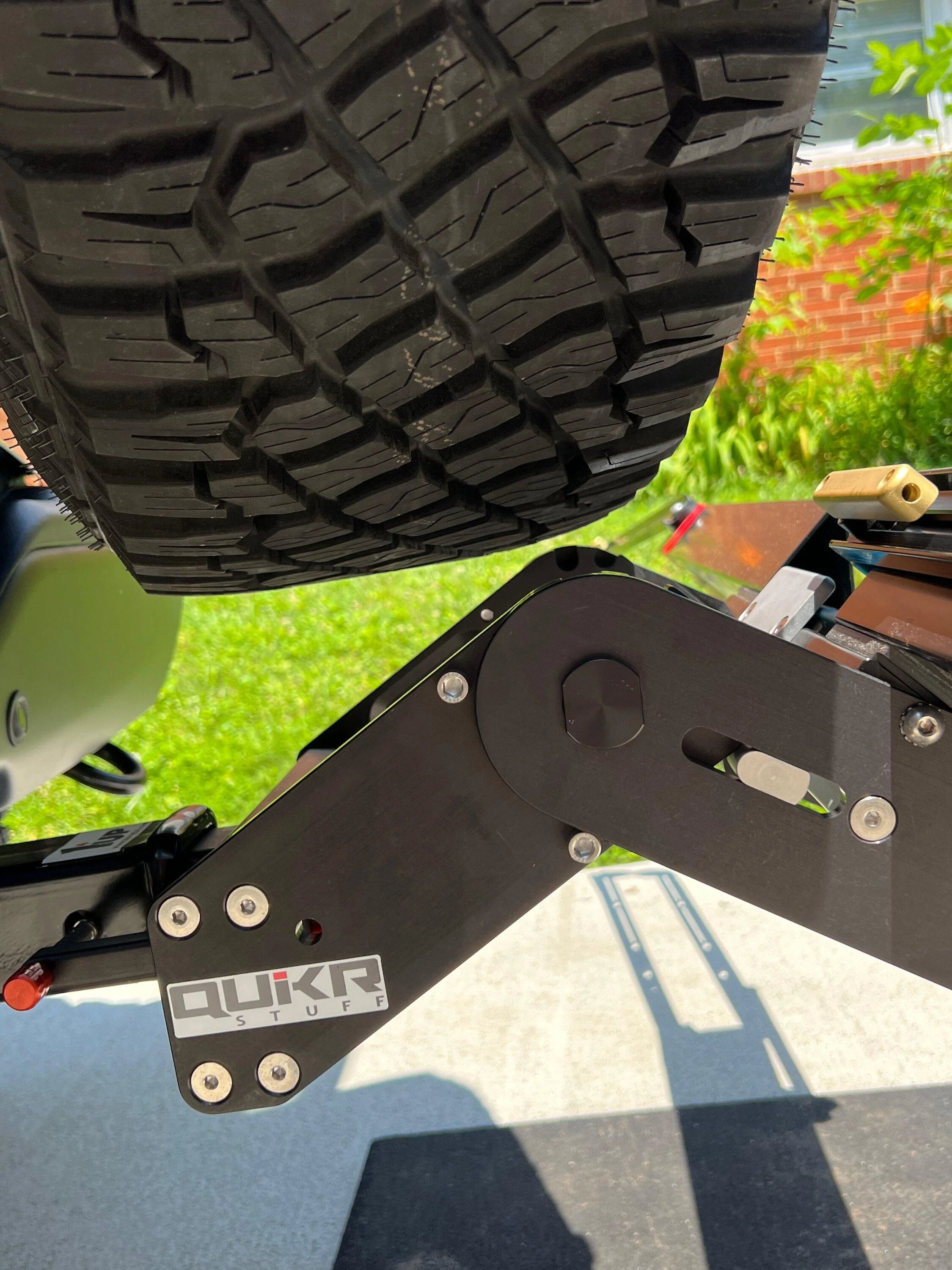

My setup is the Kurt hitch with a 1Up extender inserted all the way in (second hole). The fit is perfect. Quik Rack's hitch pin is designed in a way that allows you to fine-tune how much clearance you want from the spare tire when folded up. There is about 1/4 of an inch the way mine is setup.

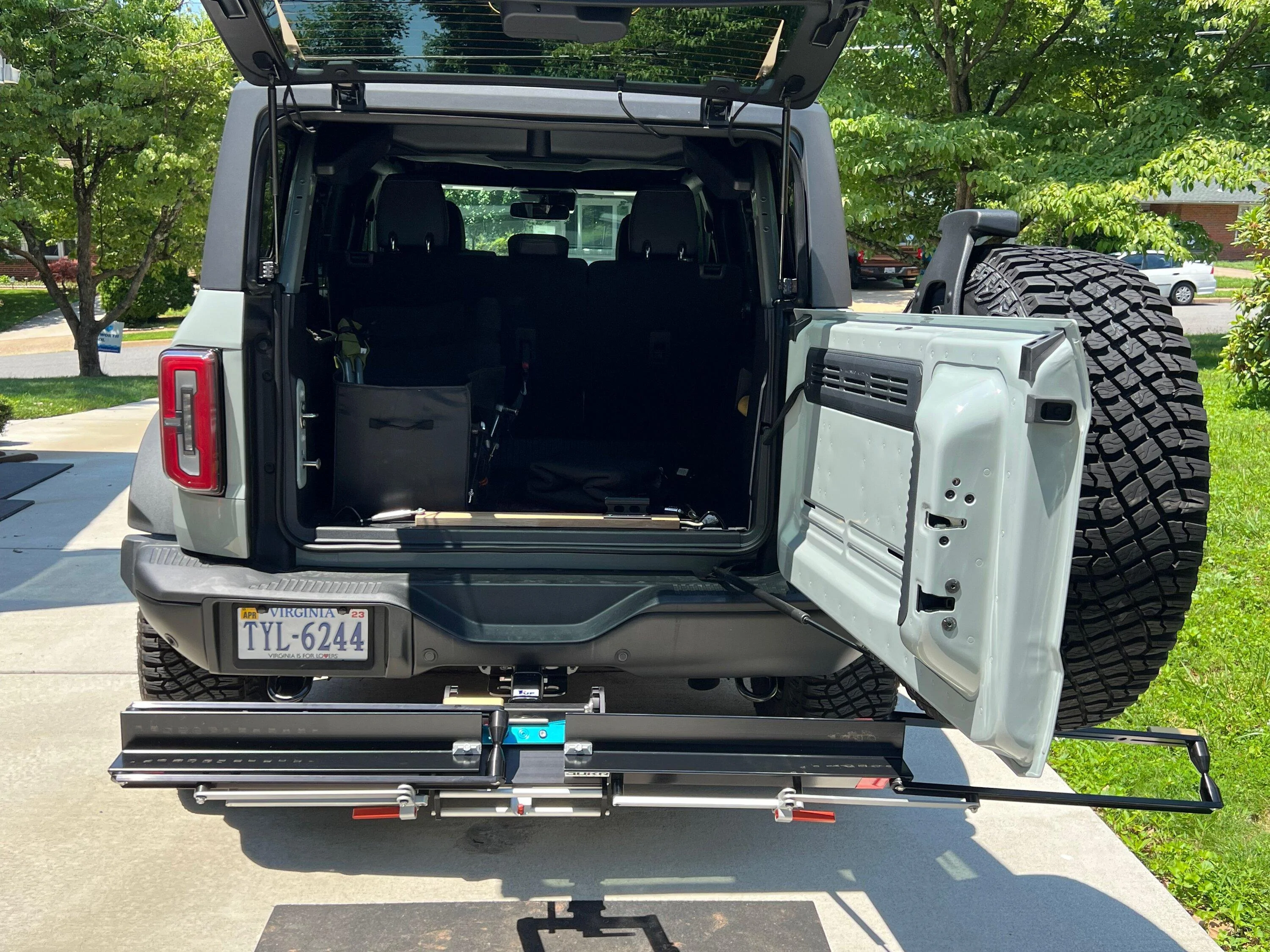

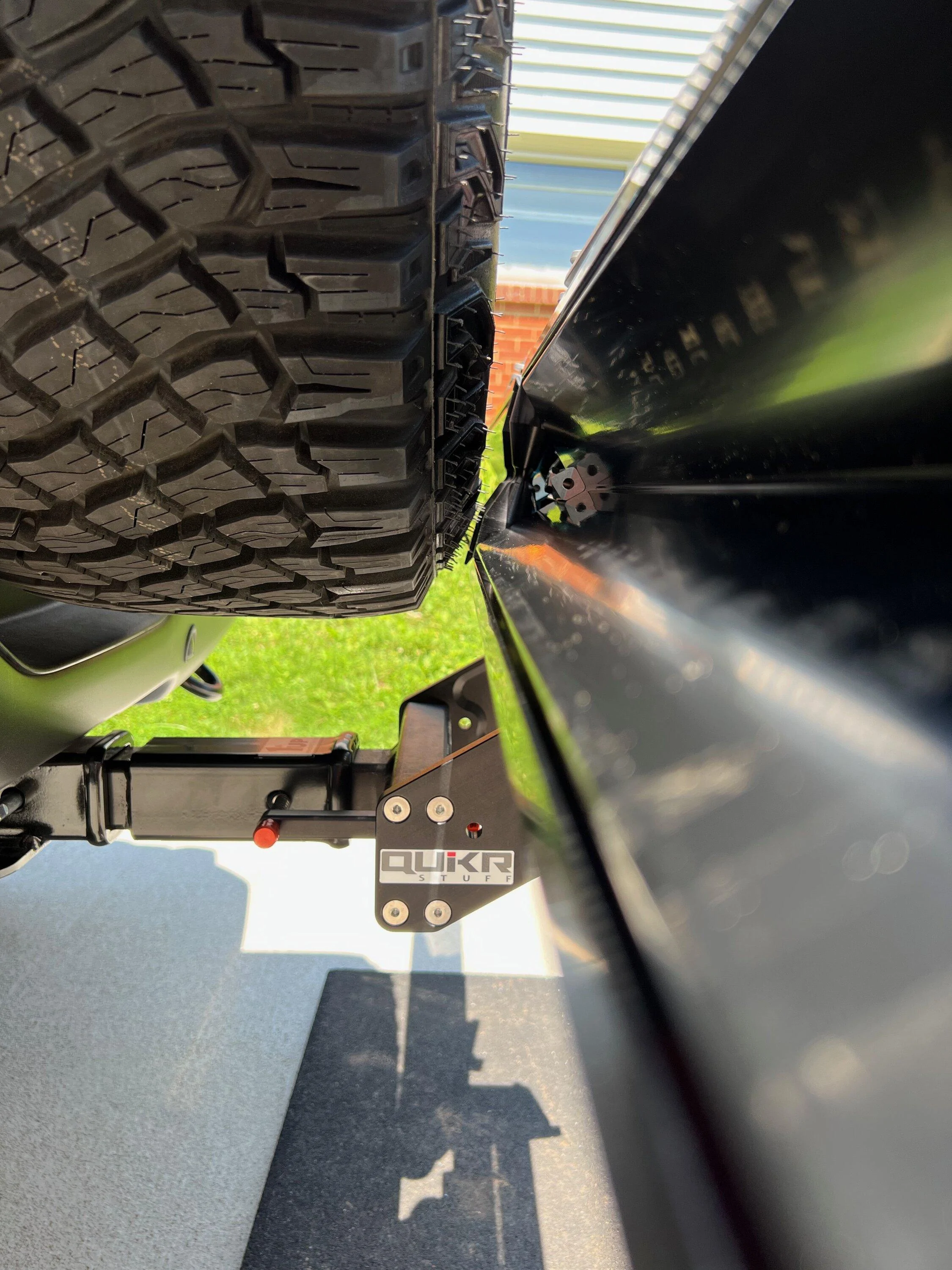

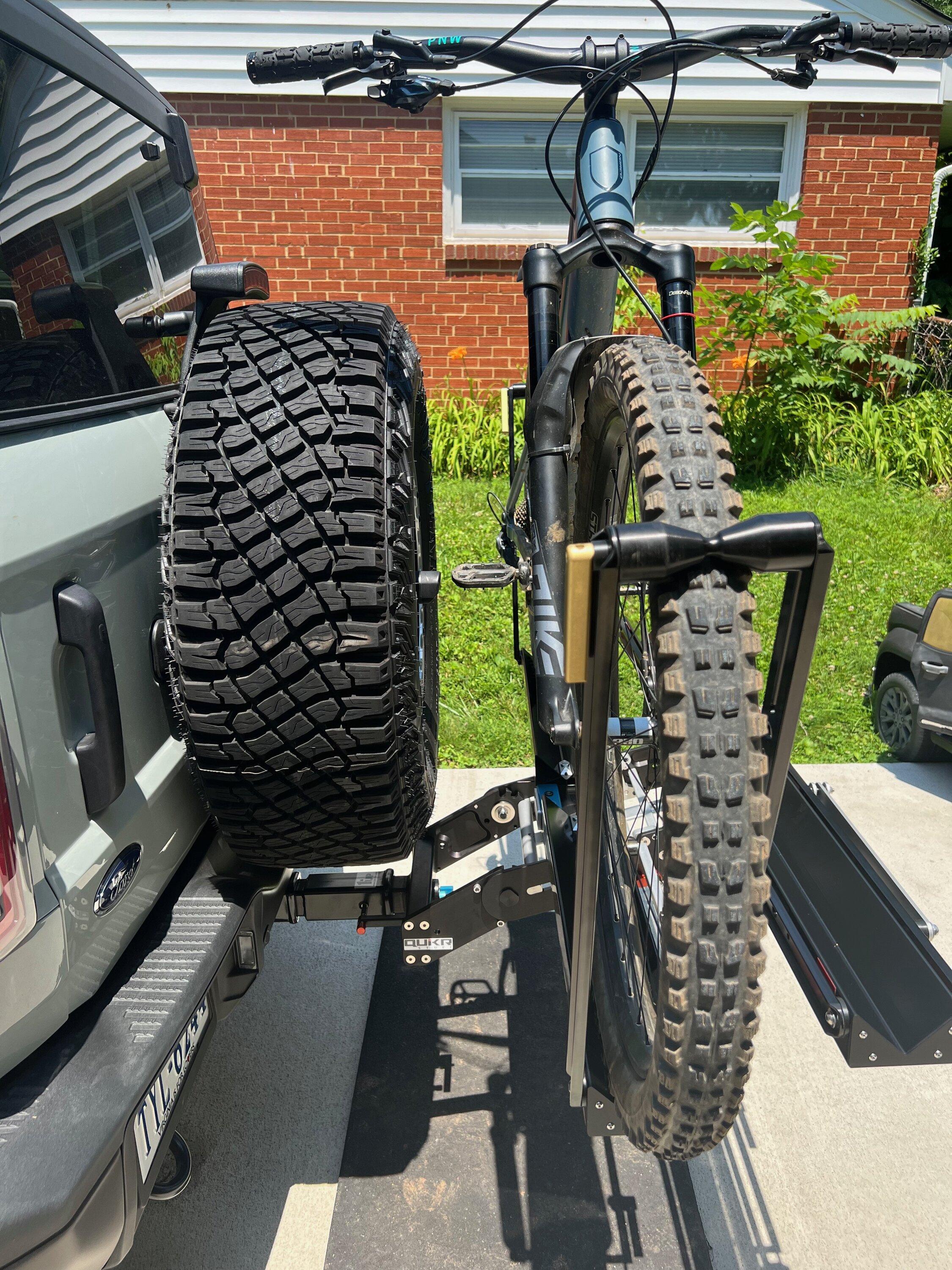

The only negative I have (other than the 6-month wait time) is — due to the tray and extension arms being a bit wider than the 1Up rack, the passenger side capture arm (thing that holds the tires) needs to be extended out for the spare tire to clear the rack when opening the tailgate. It's about an 1/8" too high. This is a pretty minor issue in my opinion and doesn't out weigh all the positives of the rack. However, this was not an issue when I had the 1Up rack installed with this same setup.

This last photo shows how the spare hits the rack without the capture arm extended

Nice! Looks very solid for sure... can you use that rack without the hitch extender or is the extender an absolute must?
I haven't tried. My guess is that I might be able to get the rack on without the extension but I wouldn't be able to get a bike on that first tray. I'd have to use the extension rack to put the bike on.

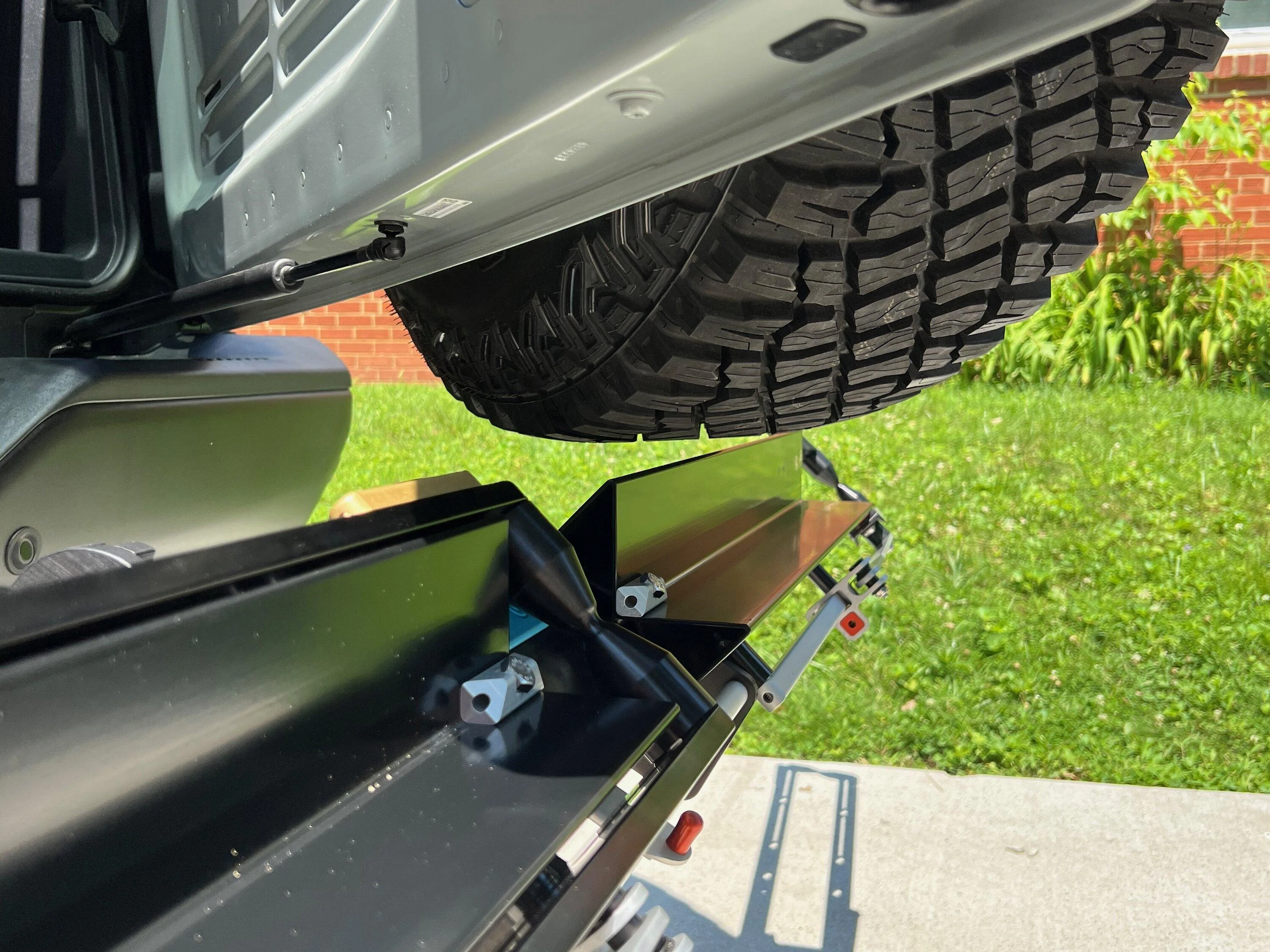

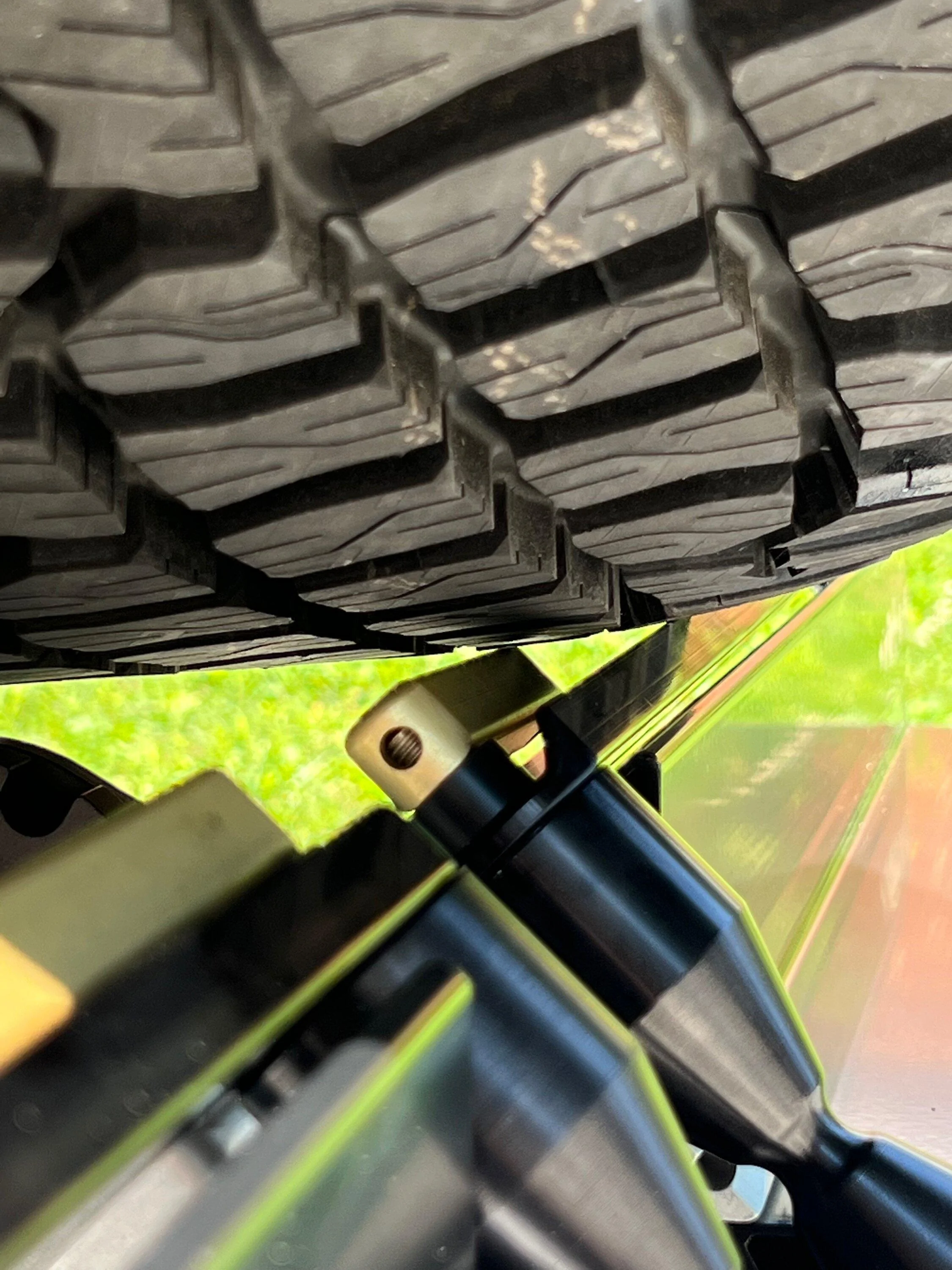

I can measure next time I have it installed. I don't see you having any issue with clearance (up or down) with the tailgate closed. You might have to back the rack out a little bit farther than I'm showing for when it's up but that won't be an issue with the way the rack is designed. However, that 37" will for sure hit the rack when you open the tailgate more than a couple feet — unless the spare is mounted higher on the Raptor. That's where you having that Kuat pivot will be handy. When open, there's only about .5"-.75" clearance on mine - see below.

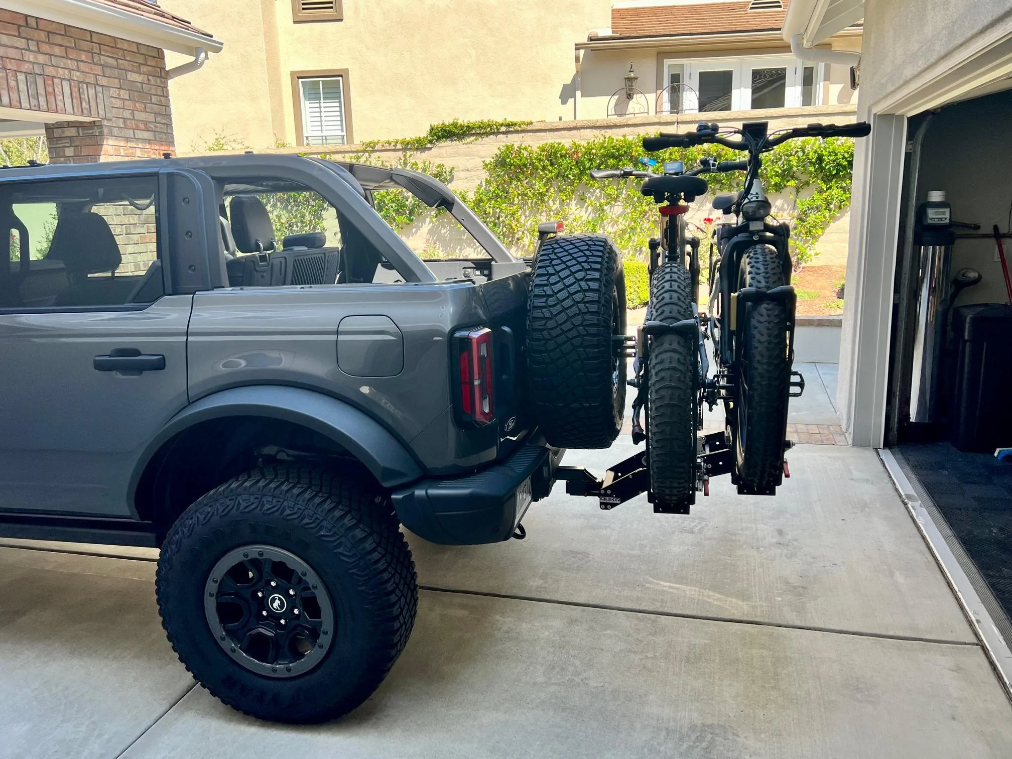

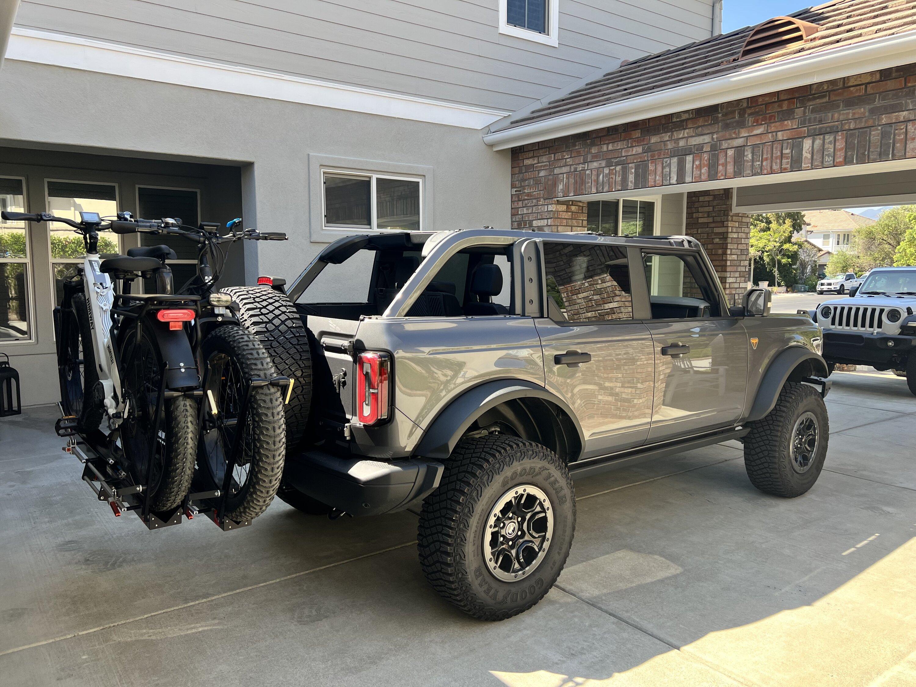

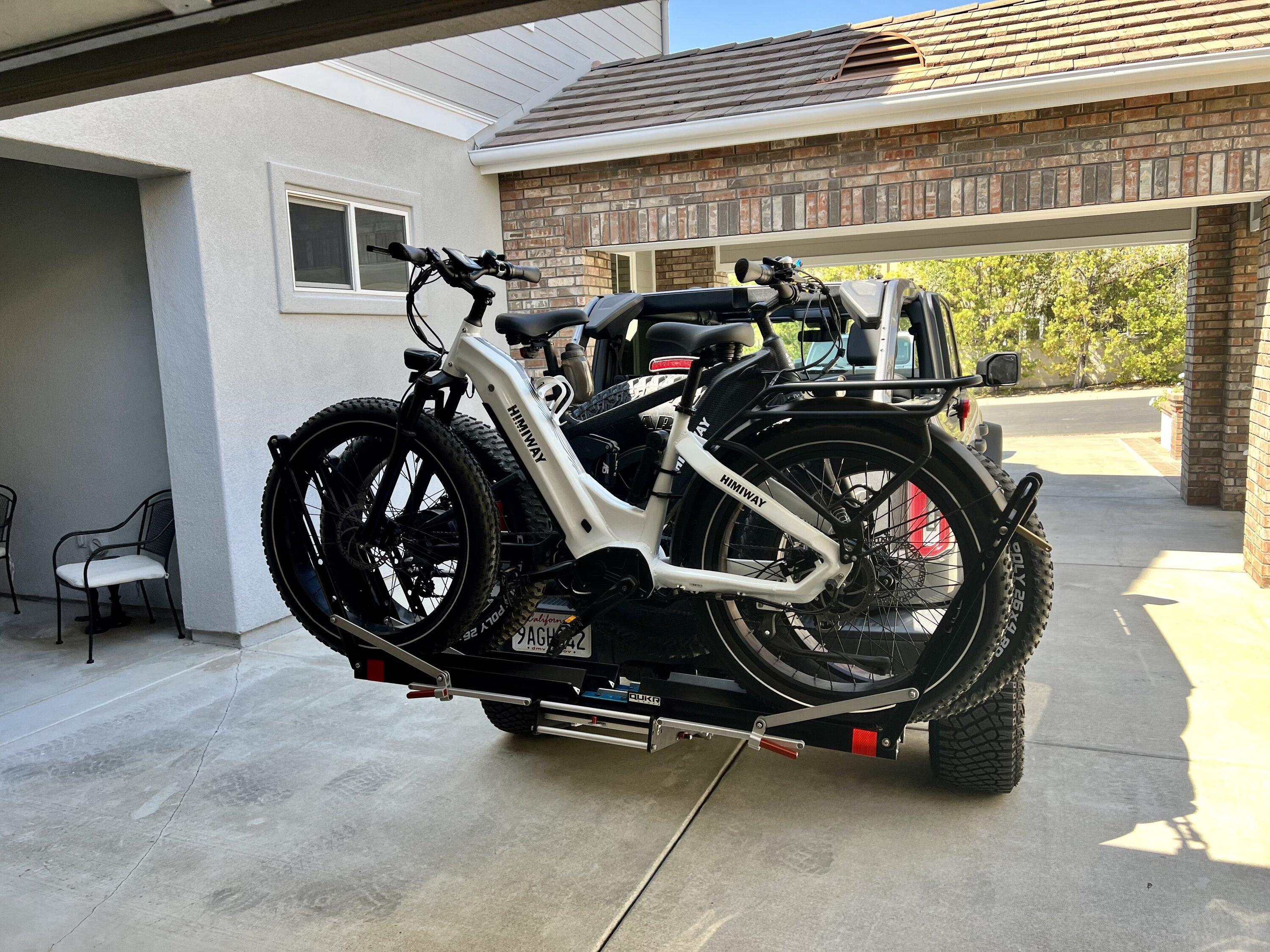

Well I installed the Bike rack using a 7" extension with a 2 1/2" drop hitch My badlands SAS has a 3" Fabetech lift so I needed to lower the rack to make it more user friendly This bike rack is amazing and the tool less features are a huge plus. Our E bikes are extremely heavy at around 65 lbs each the rack handles it no problem.
The only think I need to look at is the slop of the actual extension into the hitch receiver.. any suggestions?

Have you tried hitch anti rattle plates?
