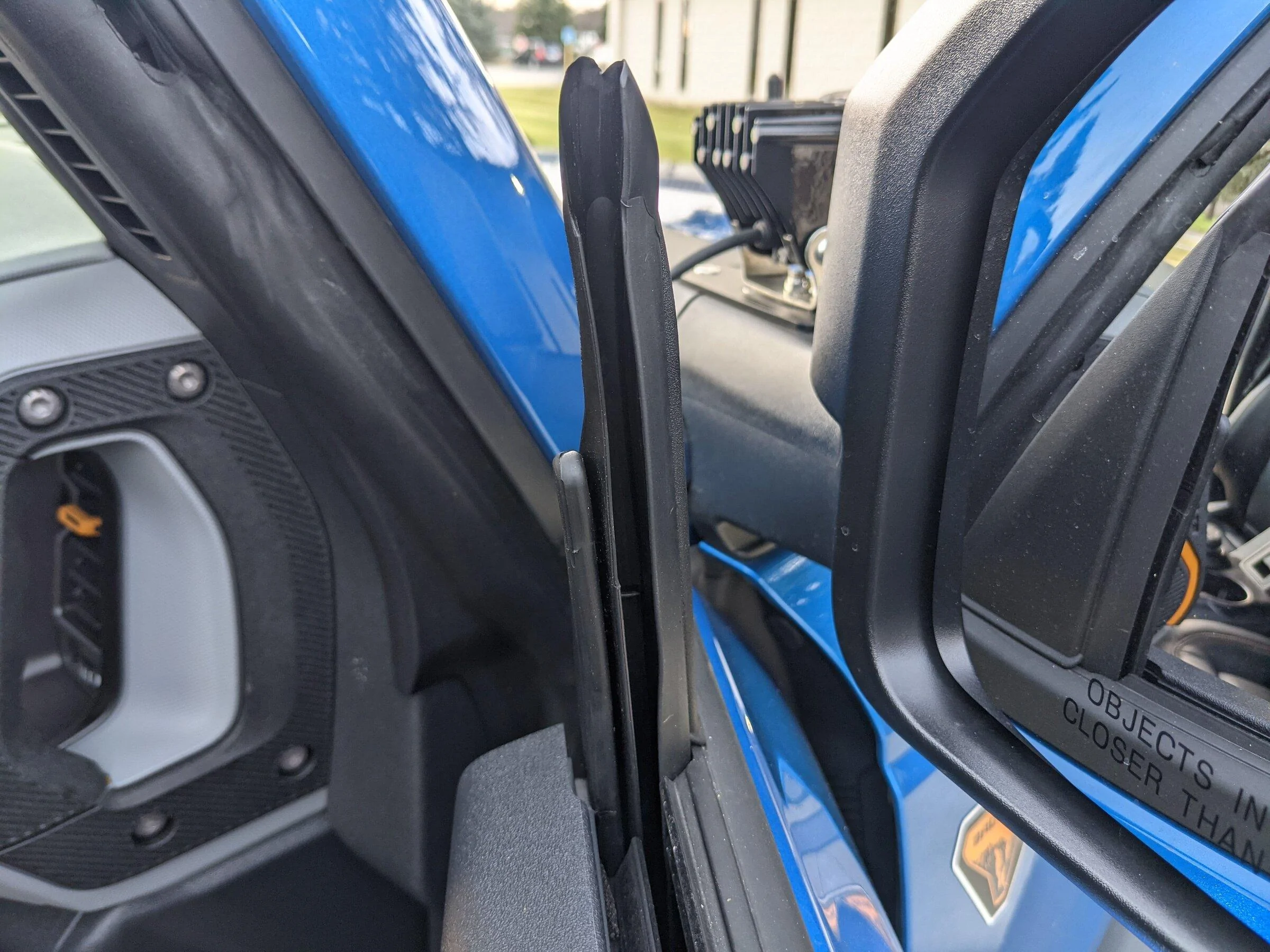

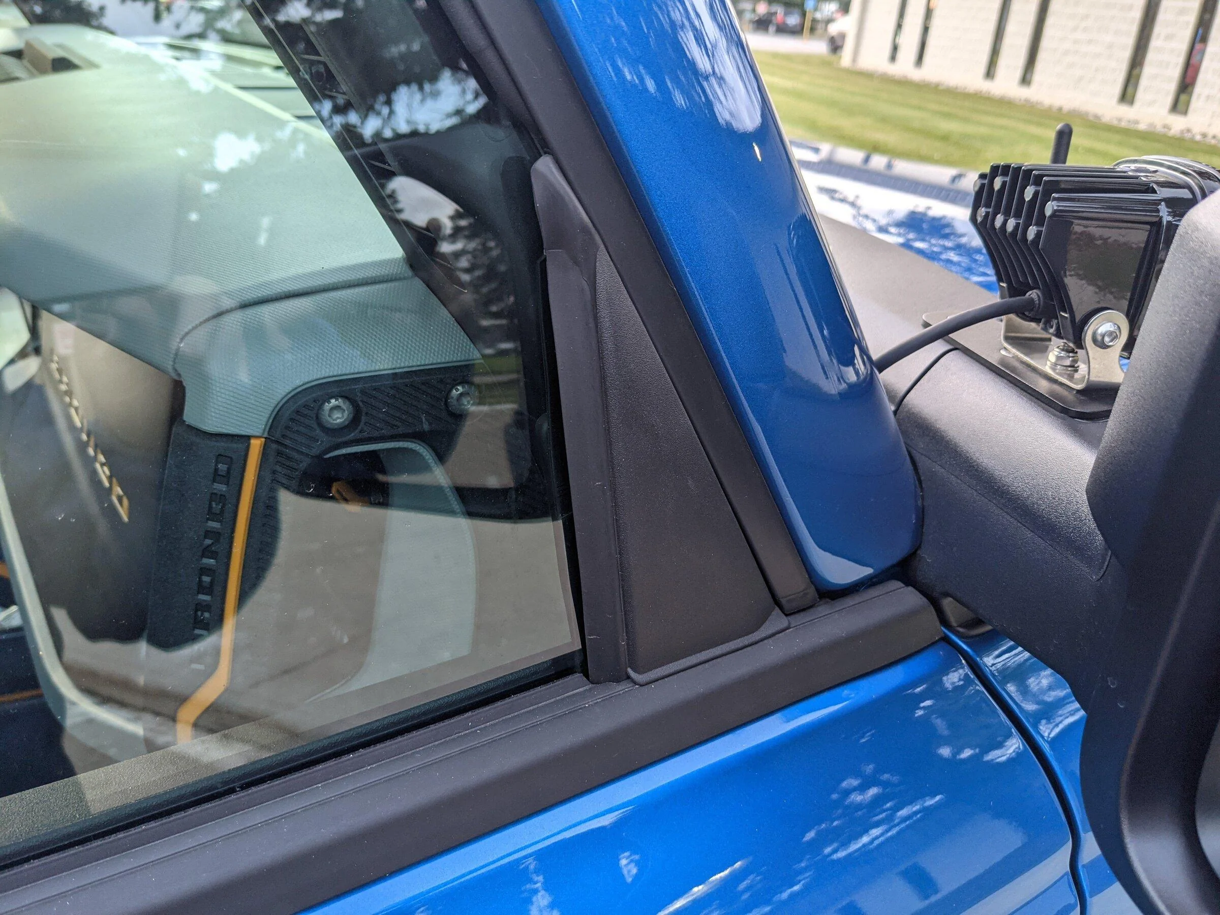

My windows rattle when hitting a bump or railroad tracks. I thought it was due to the triangular trim piece on my passenger side is not made correctly. It is tight on the widow toward the bottom, but it tappers out as it goes up, so there is a large gap between the trim and the window. The drivers side is flat to the window, so I know what it should look like...

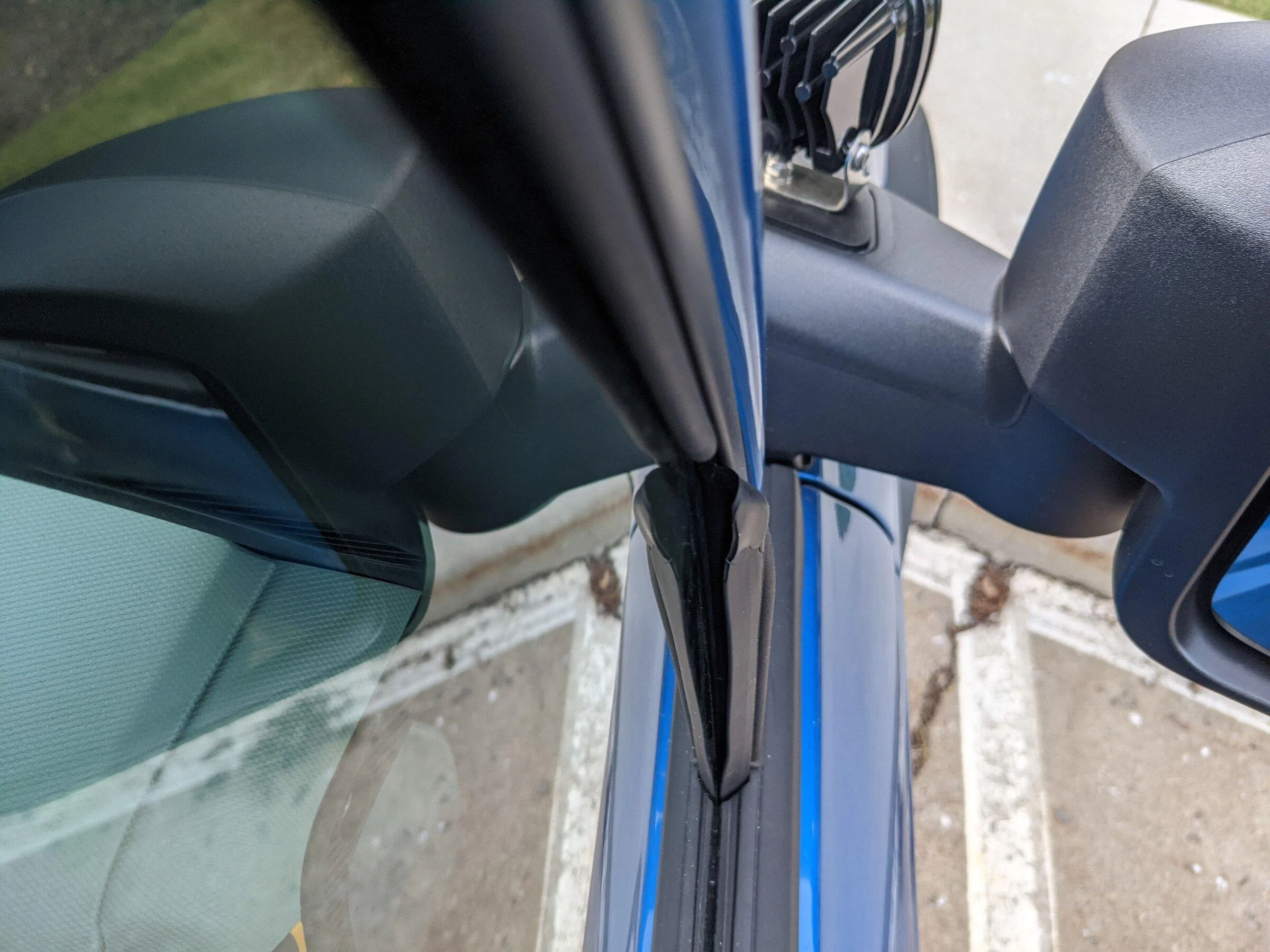

Mine rattle when down a few inches, both sides. My driver’s side triangle edge guard also sticks out more than the passenger side, but both sides rattle going over Michigan potholes.
My passenger front window trim is exactly the same. My dealer is supposedly waiting on parts to fix my front passenger side. This was back in February and I haven't heard back from them yet.

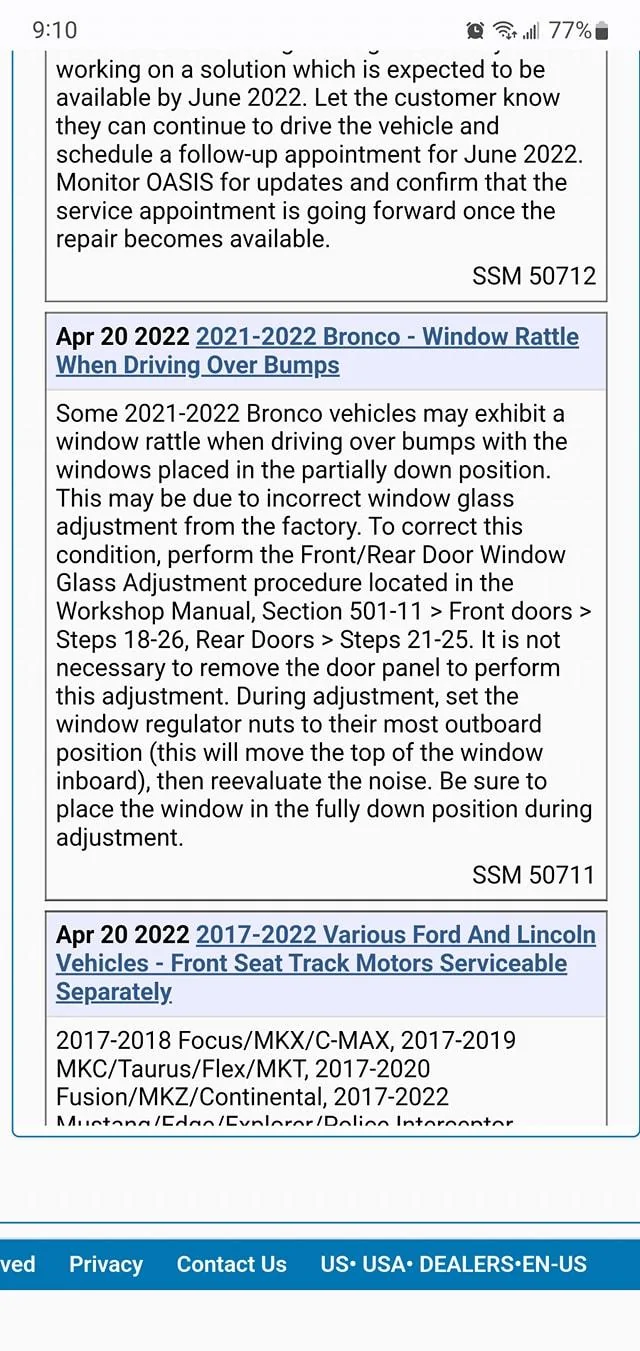

Here ya go.
Ya I’ve already been through that. Both the dealer and myself. It’s the same procedure as fixing the window getting caught on the weatherstripping when opening door, causing a horrible shake and rattle. Can make them better but they still suck. It’s a badly designed window system.
