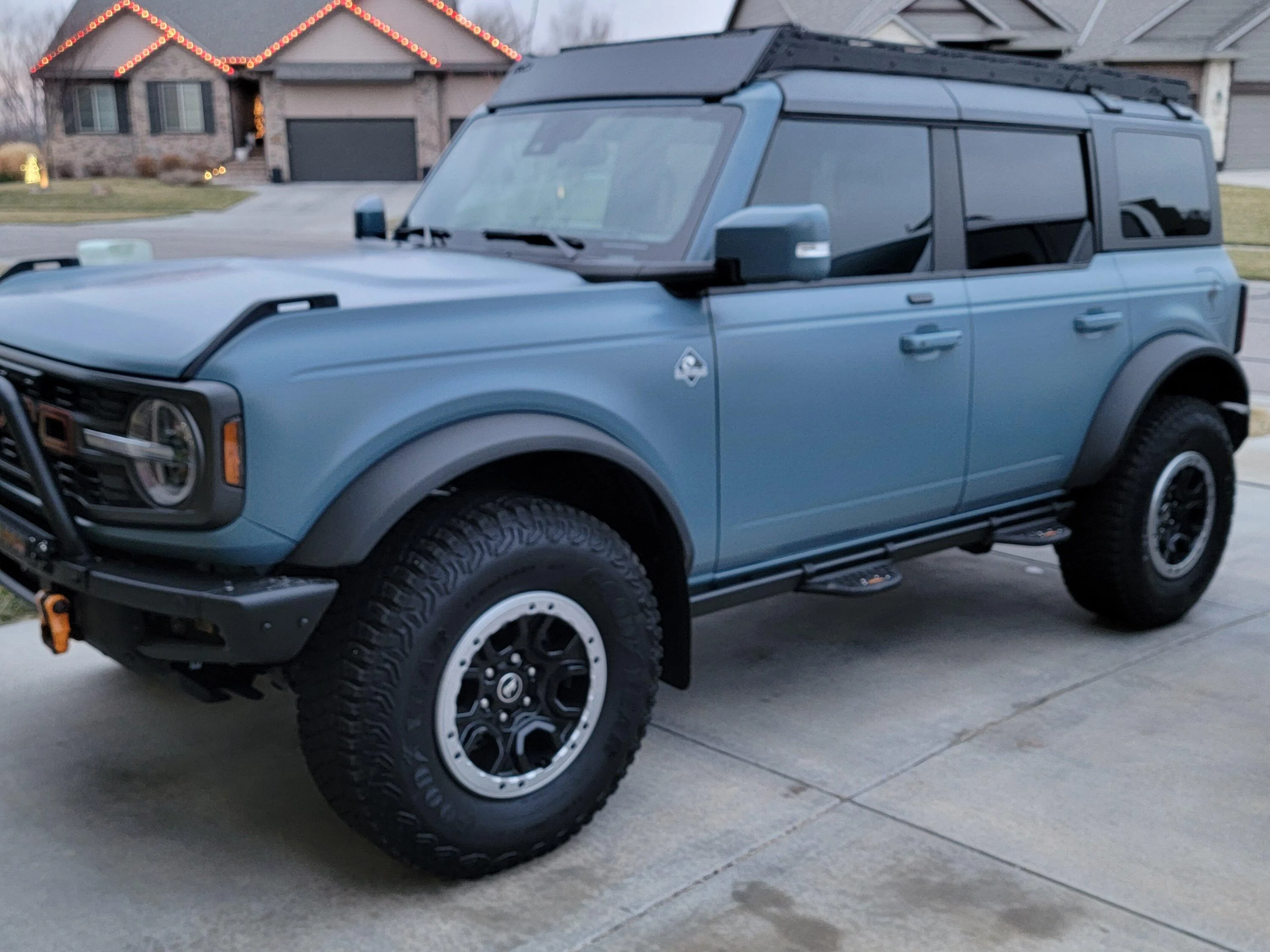

Looks amazing. Any increase in wind noise from the rack? Have you removed side filler pieces to access roof panels yet?

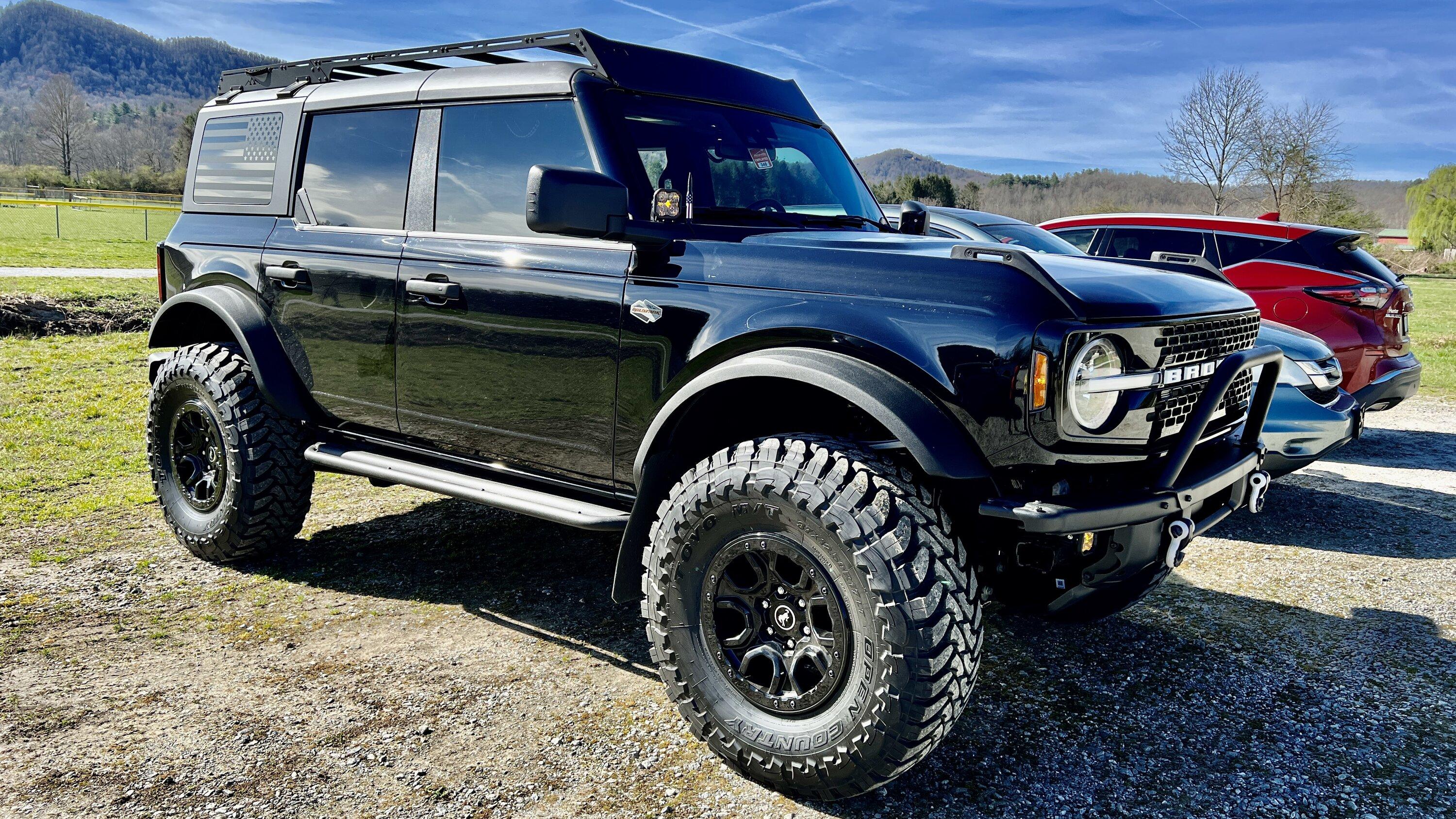

Old post but in case you never got any info - I’m running this on my 4 door Wildtrak And love it. A very very small amount of increased wind noise but it could also be because I don’t run the side panels at all just for convenience of taking the roof on and off when we feel like it. Getting the roof panels off the first time was a bit of a learning experience but once you get the proper technique down it’s easy. Just a tight fit.

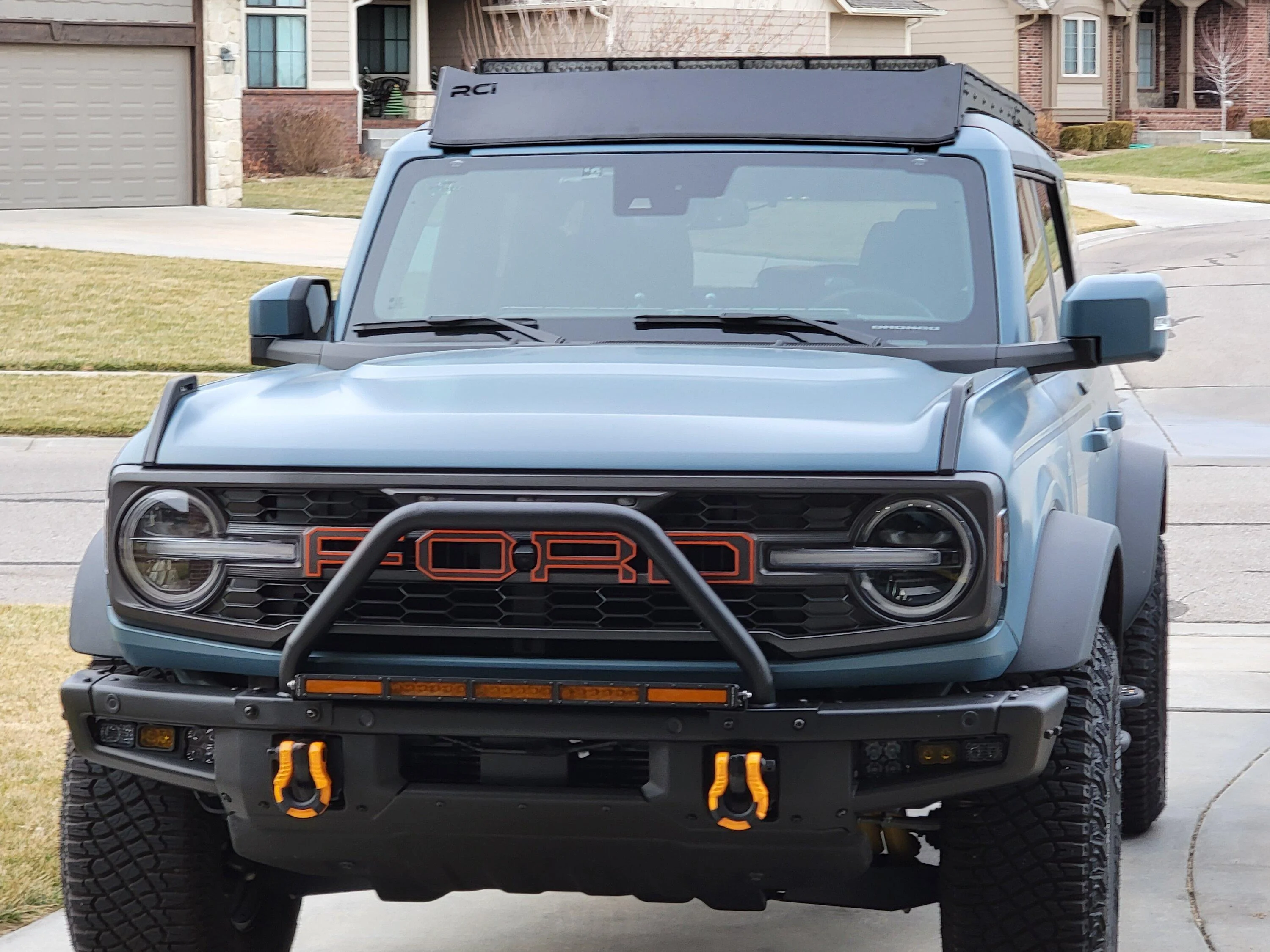

I have one on order. Should have it in a couple of weeks. I noticed you dropped down the fairing enough to cover the mounting locations and follow the window line perfectly. I was hoping to accomplish that myself. Any tips?
Have you removed the entire front section yet and ran just the rear cap section? It’s one of their selling points and I am wondering how easy it is to do on a semi-regular basis.

So interestingly enough the front mounts that came with mine appear to have been redesigned since I got mine and I just haven’t followed up to get the new set yet. I believe there were a few issues people were running into that they fixed. When I first installed the front mounts (as per the directions) the front fairing was around an inch above the windshield and looked fine but developed this horrendous wind-flutter any time I would exceed 57 mph and would last until I dropped to below 45 (like clockwork). I discovered that it was due to the front fairing not making enough contact with the front of the vehicle (there’s a rubber strip that lines the bottom of the fairing where it makes contact) so I modified the front mounts a bit in order to be able to slide them down far enough to firmly press the fairing against the rubber strip/vehicle. It fixed my issue and hasn’t been a problem since. It actually reminds me I’m going to reach out to RCI and see about getting some updated mounts.. thanks!
As for removing the front half and running only the rear - I’ve never personally done it but I don’t see why you couldn’t. The two rear mounts on each side should keep it nice and secure to the vehicle w/o the front part. Should just take a 10mm socket and about 5 mins.. the way the front half meets the rear half w/ the angled joint the front half comes off first above the rear.. hence why when you install it you have to do the rear part first. Maybe I’ll try it out some time when I get the new front mounts although we pretty routinely mount stuff up there that uses both sections.
Overall I’m very pleased with the functionality and appearance and would buy it again if given the chance. FAR superior to my friends’ junky Trailrax
