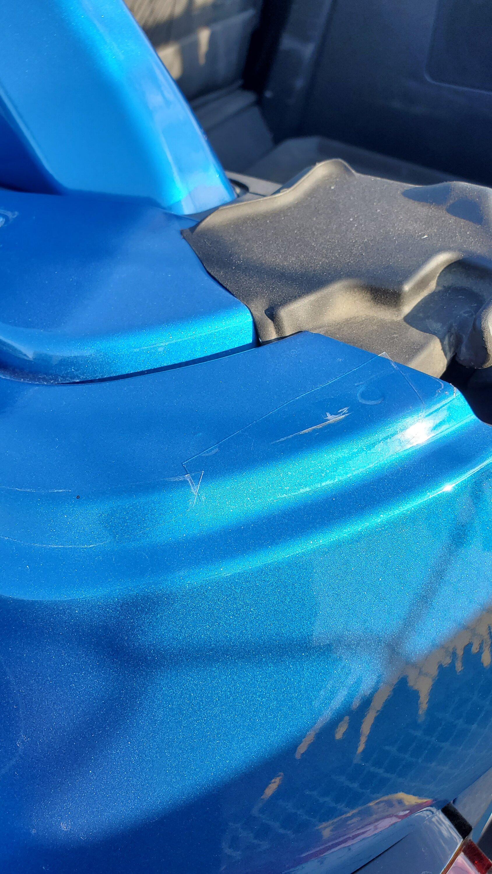

Total speculation: Look at the outer back corner where the mic top contacts the body, above the tail light, where the body curves. I don’t have my Bronco yet but if memory serves we saw some rubbing at this location. You may have to lift up the rear section to see if their are any whiteness marks.
good luck.

I do have a spot on the driver side, the factory paint protection didn't stick, so I replaced with a couple pieces I had of 3m stuff.
What gets me though is if I open the window and drive all the noise is gone. I'm going to try the other silicone listed and see what it does.
Currently running topless though.
