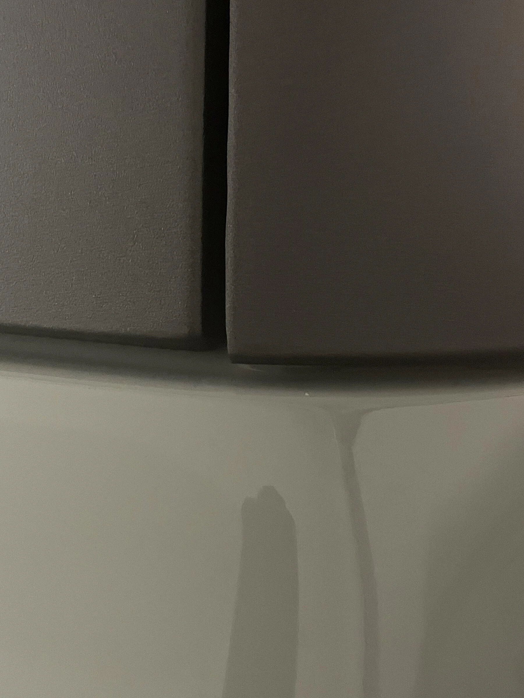

There is no way I can get the 2.5-5.5mm gap recommended by the TSB without damaging the fender. In my case, my issue isn't really the fender itself, its my damn MIC top. This is what my passenger corner looks like.
Ford Bronco Squeak coming from Cargo Area - Fixed ✅ 438272A2-98FC-48E9-B49A-3A9ACCB3AB9D

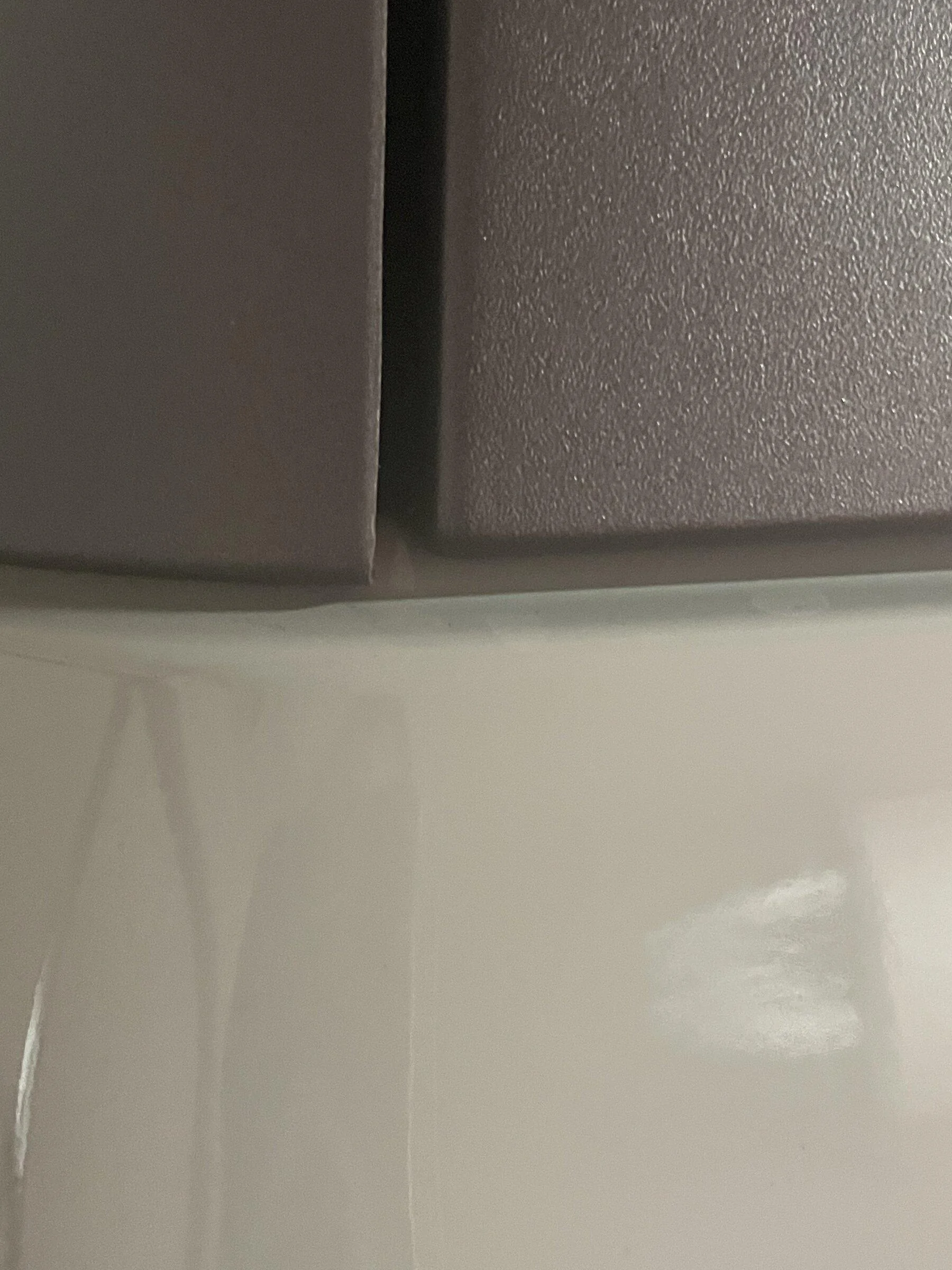

Driver side for comparison.
Ford Bronco Squeak coming from Cargo Area - Fixed ✅ B33FBB71-5250-420E-A670-B069754AFECD
You can see how the corner sits lower than the window panel on passenger side. This is one of the many issues with my MIC top I've noted since delivery, but didn't realize it was rubbing on the fender.
