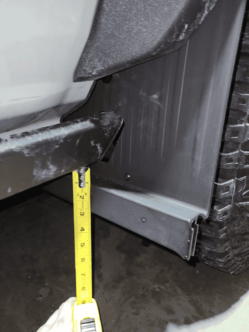

I received the mud flaps today and had a chance to install them.
Installation instructions are pretty well done and whoever was in charge of the choosing the hardware should get an award! Nylon washers to separate the lock washers and nuts to prevent galvanic corrosion between the (black oxide stainless?) lock washers and nuts is surprisingly well thought out. Also if the hardware is stainless it should be advertised, that's a huge plus I never found mentioned!
What is less clear to me is the design of the mud flaps, now that I have had the chance to see and feel them in person I question if they can handle rocky terrain. I am hoping to hear your prospective on how these were designed to accommodate off road driving.
Clearance
The mounting system is largely a plastic base (upper) with a removable heavy rubber flap(lower). The plastic upper hangs 3 inches(ish) below the rock slider (without the lower), if that catches (say heading down a rock ledge) the flap system does not have a safe failure mode (plastic push rivets that pop out).
Ford Bronco Removable mud flaps 1641273907816
In the pic blow you can see trail rash on the front of the rails, this is where the upper hangs below the rock rail 3 inches. Its not a high scrape area, but it only takes 1 hit.
Ford Bronco Removable mud flaps 1641272314223
If someone were to leave the lower portion on, I am curious if the rubber has enough pliability to deform over small obstacles. Its SO thick and heavy I would be concerned it may transfer stress to the plastic upper. It looks like a must to remove when off-roading.
If they sang, I would guess the plastic upper will crack before the 3 metal mounting points rip out of the sheet metal. In that instance would a user would have to purchase a whole new front pair? I don't see those listed individually. If this was the only con and I could replace that part for a reasonable cost (Thule does this the best IMO) its no big deal. If it snags and costs $350 for a new pair that's probably a deal breaker for most.
I appreciate your detailed and thoughtful feedback.
The fasteners are black oxide stainless steel (we ship fasteners from Canada to California to have this done). Looks like the instructions just say "SS". I'll try to get that info added to our website.
Clearance
I wonder if there is anything that can survive being sandwiched between the rock slider and a rock? There's a reason the rock slider is made out of steel. That said, it's certainly something to look into. A flexible material that isn't too floppy that can be folded in half and not break or derform.
You make a valid and important point. Even if you remove the rubber, you may still smash the nylon offset in certain off road driving situations. If you plan to do some serious off-roading, I would remove them entirely. As previously mentioned, you can remove the mud flap and bar, leaving the frame mounted brackets in place. See that post for some caveats.
We can supply individual replacement parts.
