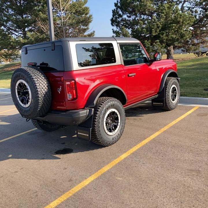

I don't normally work on product design (I'm primarily involved in IT), but because of my personal interest in the Bronco, and because I have some experience using CAD, I got involved with the design of some mud flaps and mounting brackets for the Bronco here at my work. The mud flap itself is a heavy duty two-piece design (each pair weighs about 8 lb). The lower portion can be removed from the upper portion by sliding it out of the upper portion. The optional plate (also removeable) on the bottom has a diestamp Bronco logod stainless steel plate.
The front and rear are both mounted to the frame. The flares are still removable. Due to the forward protrusion of the rock rail, for now we simply have a hole around the rock rail, and a solid version for those without rock rails. The front is not compatible with the running board / side step.
I know there are a lot of people who hate mud flaps, and others who like them. I've never been a huge fan of mud flaps myself, as I don't always like how they look. That said, they're quite popular up here in Western Canada, and serve a purpose. As a Bronco enthusiast myself, with hopes of getting a Bronco someday, I would like to make something that an actual Bronco owner would want. If you have any feedback I'd be curious to here what you think. Personally, I think I would prefer something simpler, cheaper, and lighter (ie. something like Rally Armor mud flaps), but that's the more minimalist side of me speaking.
Update:
These are now available exclusively from Ford. Other options without Bronco logo will be available in six months. I've also been told that they're not recommending these on the front of base model Bronco's with original tires, because they position the mud flap too close to the ground.
Photos:
Short rear rubber (note narrow front flare):

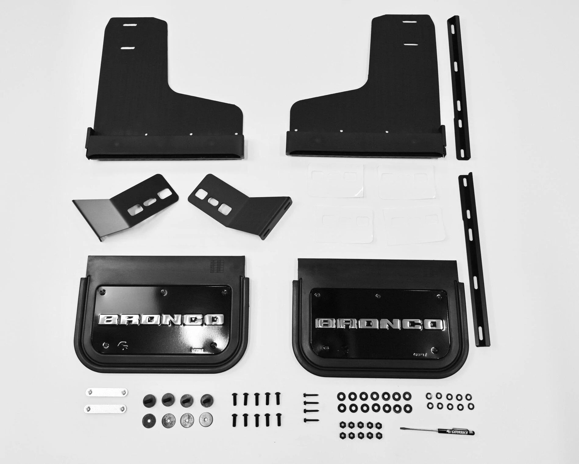

Here's an overview of the parts included in the kits:
Front:
Ford Bronco Removable mud flaps IMG_8363

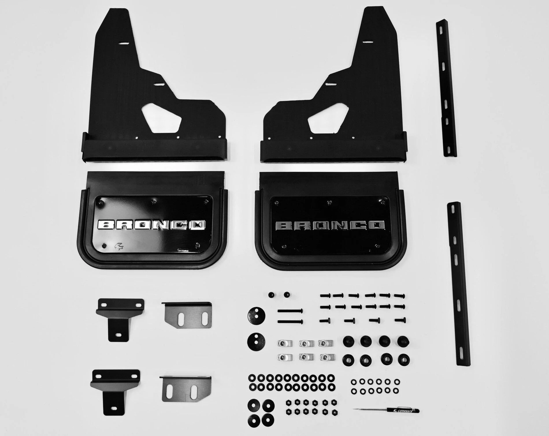

Rear:
Ford Bronco Removable mud flaps IMG_8362

I just watched an install video in an other mud flap thread, they put three spring nuts behind the liner a the front, they slide them right over the painted metal of the body. Do those springs nuts have some rubber or other material on the inside to protect the paint there? Otherwise I'd be afraid this will eventually cause the paint there to get rubbed off and rust to start, hidden behind the fender liner. Would be great if you could find out if this is a potential issue.
Thanks for all the feedback and info you provide here, much appreciated!

I received an update/correction on this. Apparently it's still in discussion whether they're going to include some vinyl protection for the spring nuts. Our product engineer who was involved in installing/testing the mud flaps on the Bronco, said that it's unlikely for the spring nuts to scratch the paint down to bare metal. He also mentioned that once tightened up, the spring nuts should not move. I still feel it would be a good addition.
Not as great as my initial response, but hopefully it's not an issue, or they decide to include some PPF just as a precaution.

Is it possible to get shorter mud flaps? The design looks well built but they look too long on the bronco.

These use the shortest "removeable" mud flap that we currently offer.
We will be looking into the possibility of using our non-removable Gatorback mud flaps with these brackets. If that works, then it would allow for shorter lengths, and 1/2" narrower width.

I'd be fine with non-removable, it just looks like even with the sasquatch package the bronco needs to be a few inches taller.
