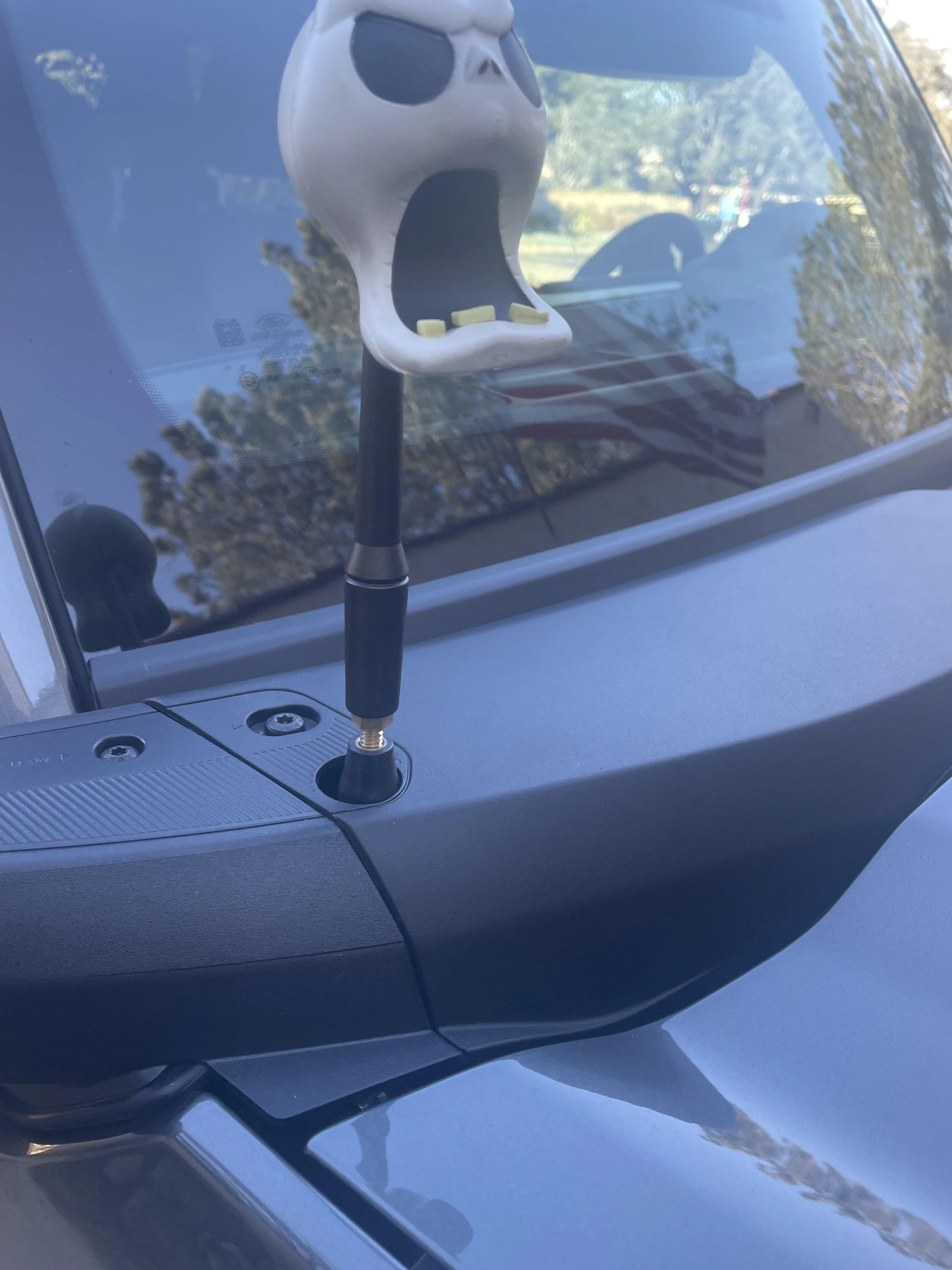

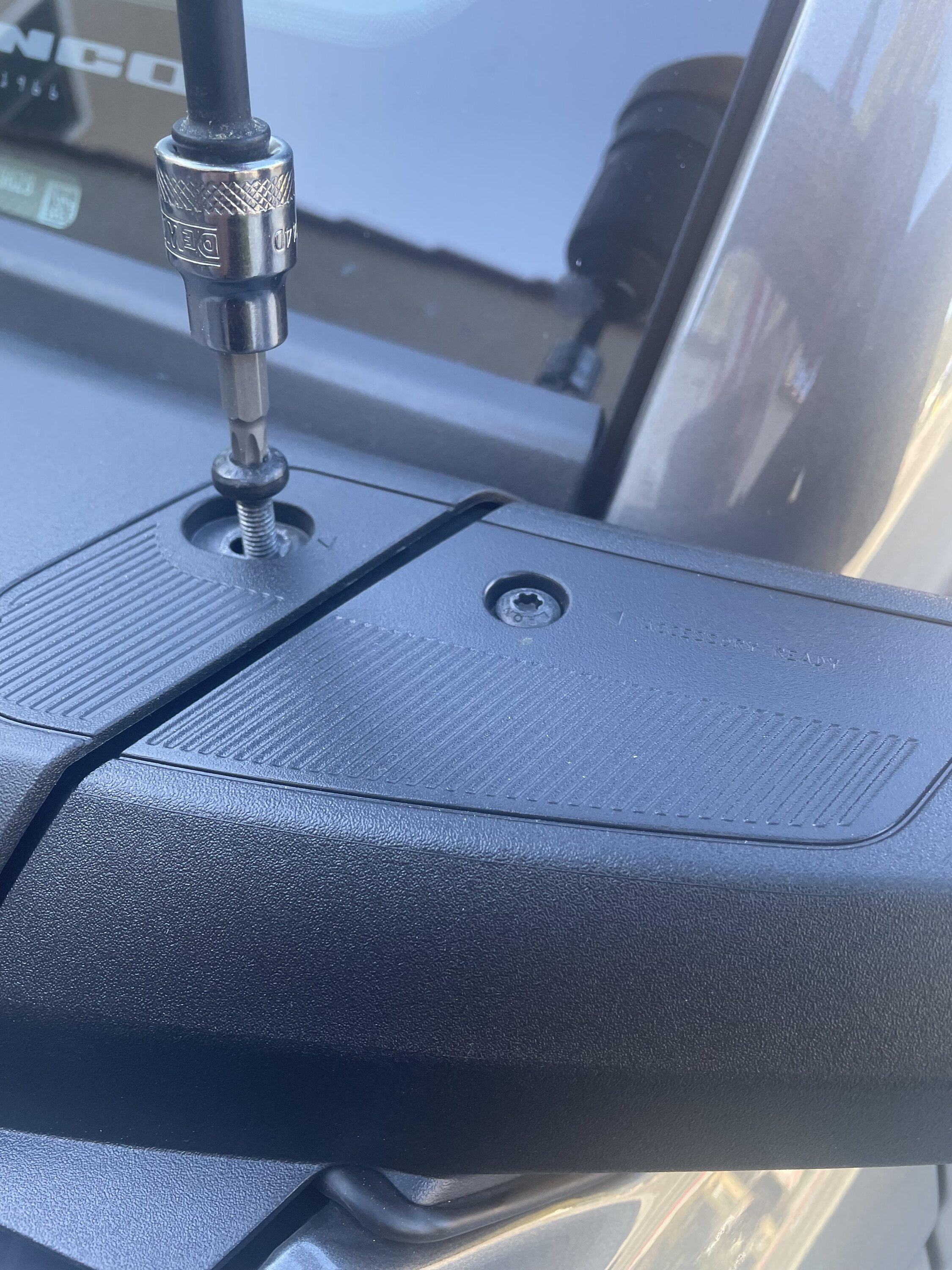

1) Remove the antenna and two screws on both sides.
Ford Bronco Removing cowl and windshield wiper arms IMG_1663
Ford Bronco Removing cowl and windshield wiper arms IMG_1662

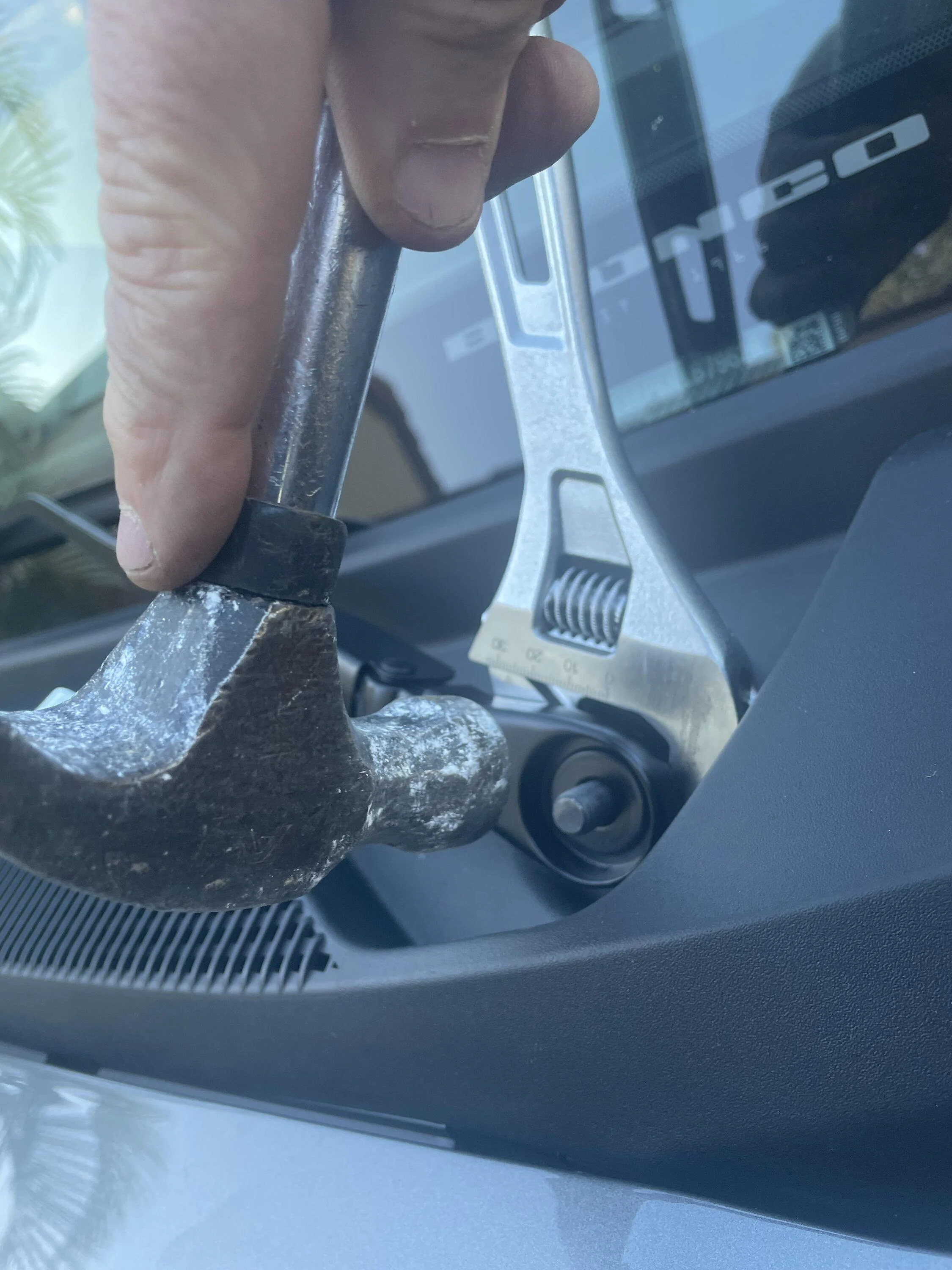

2) Remove the cover and nuts on the wiper arms. Then I used a crescent wrench and slipped it behind the arm, then tapped the bolt head. I tried a wheel puller but the cowling got in the way.
Ford Bronco Removing cowl and windshield wiper arms IMG_1664

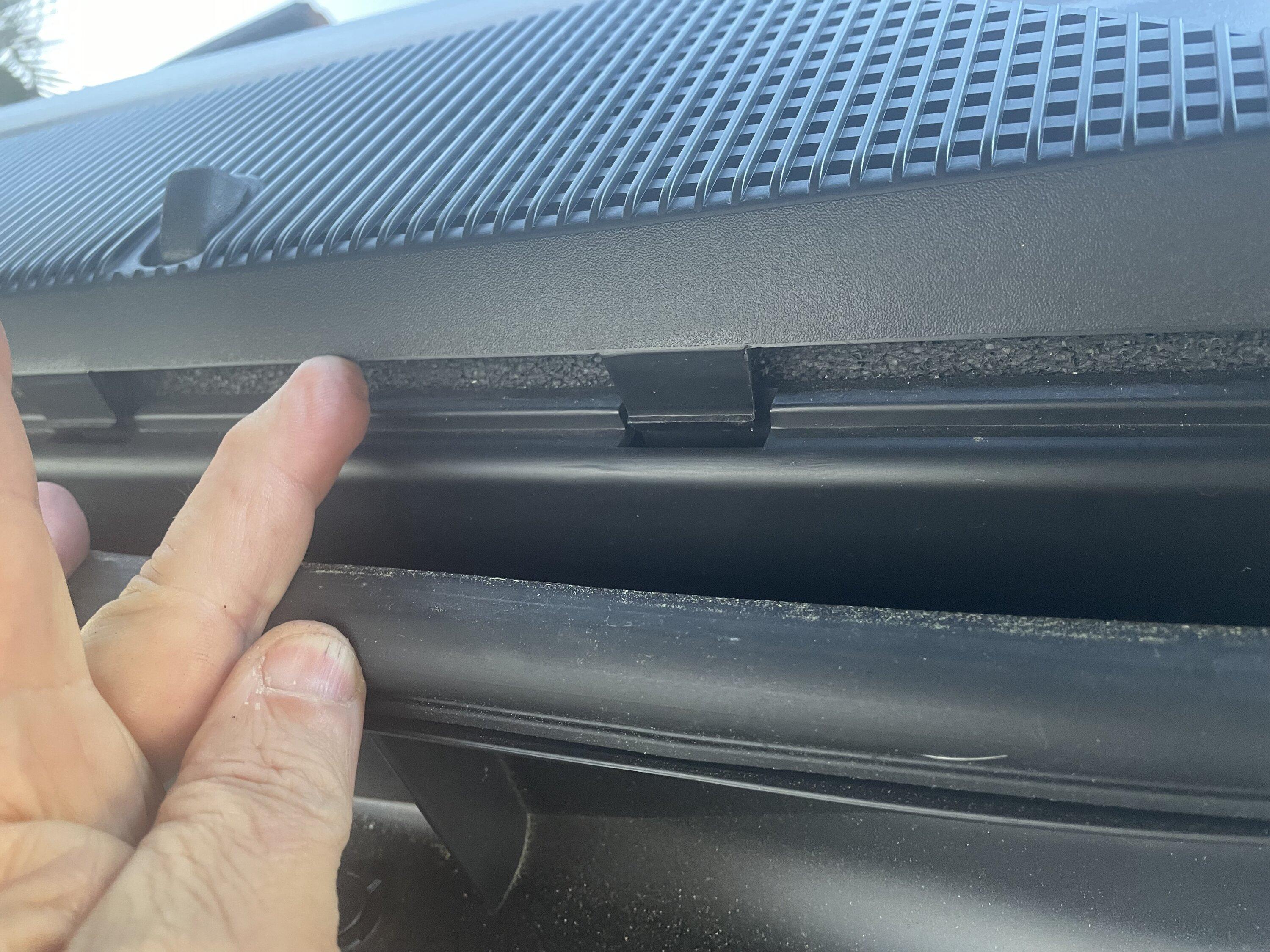

3)The front edge of the cowling snaps in and can easily be loosened with a flat tip screwdriver.
Ford Bronco Removing cowl and windshield wiper arms IMG_1661

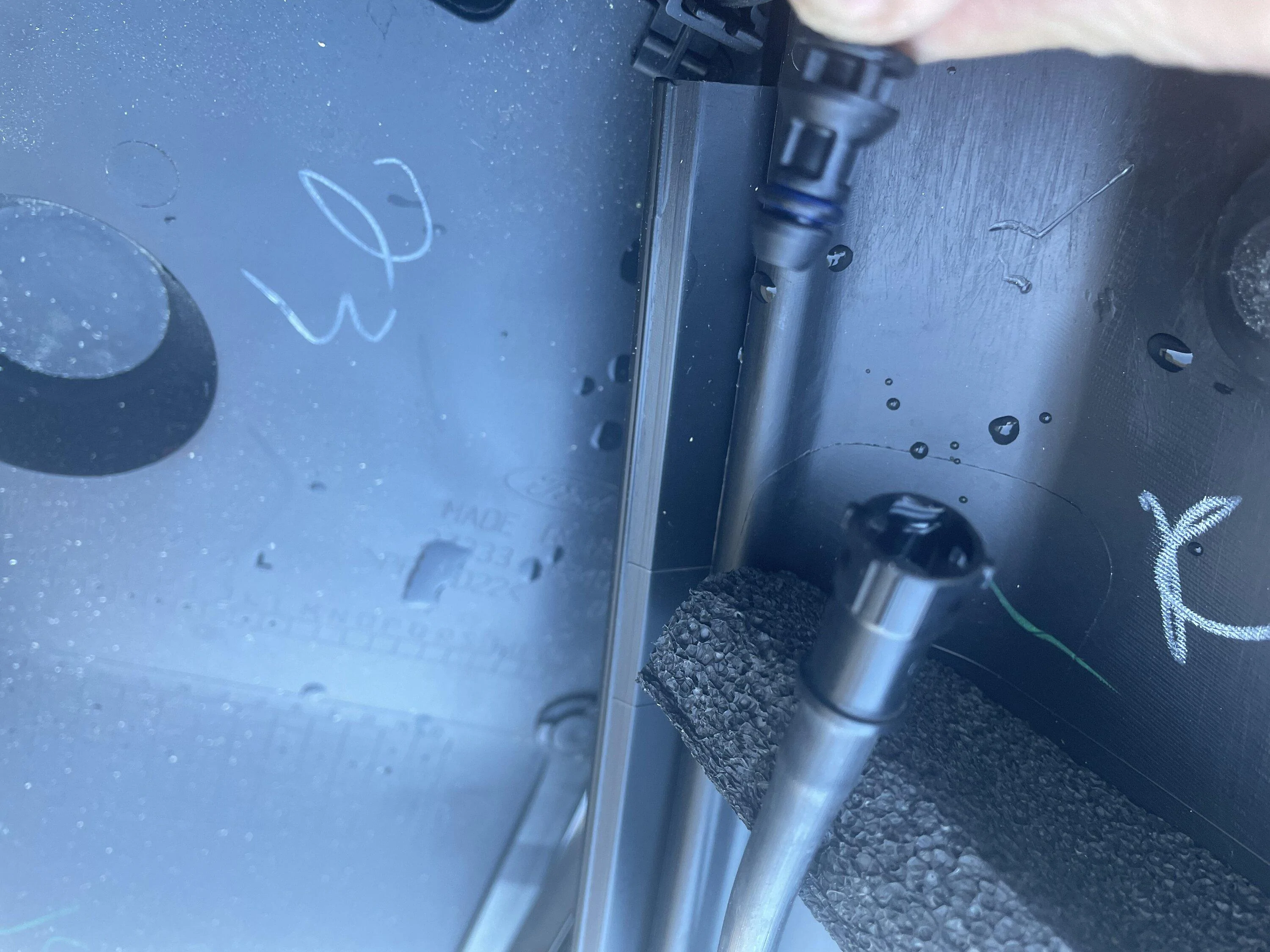

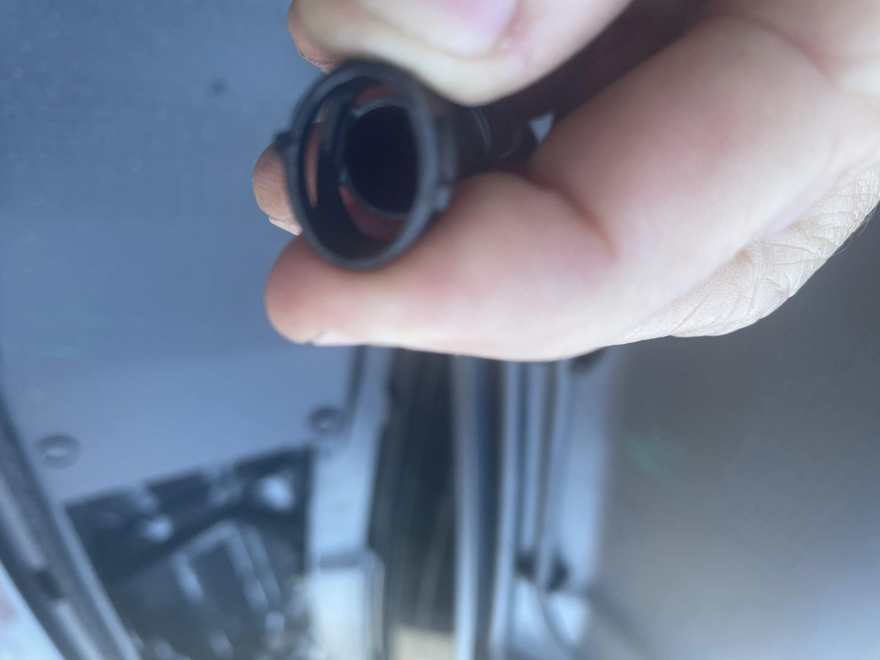

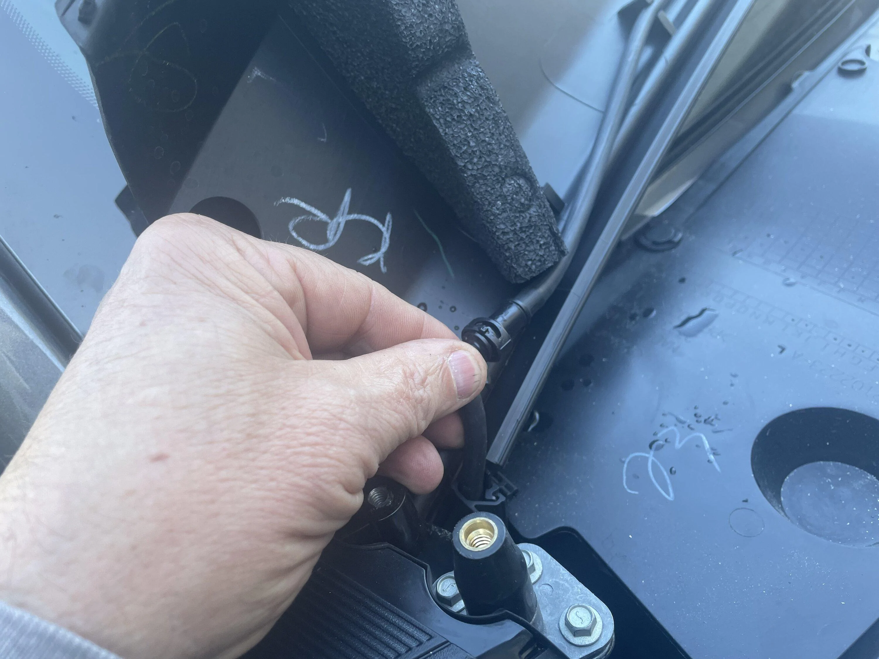

4) Ford put a central coupling for the washer system. Simply squeeze the connection and pull apart.
Ford Bronco Removing cowl and windshield wiper arms IMG_1660
Ford Bronco Removing cowl and windshield wiper arms IMG_1659
Ford Bronco Removing cowl and windshield wiper arms IMG_1658

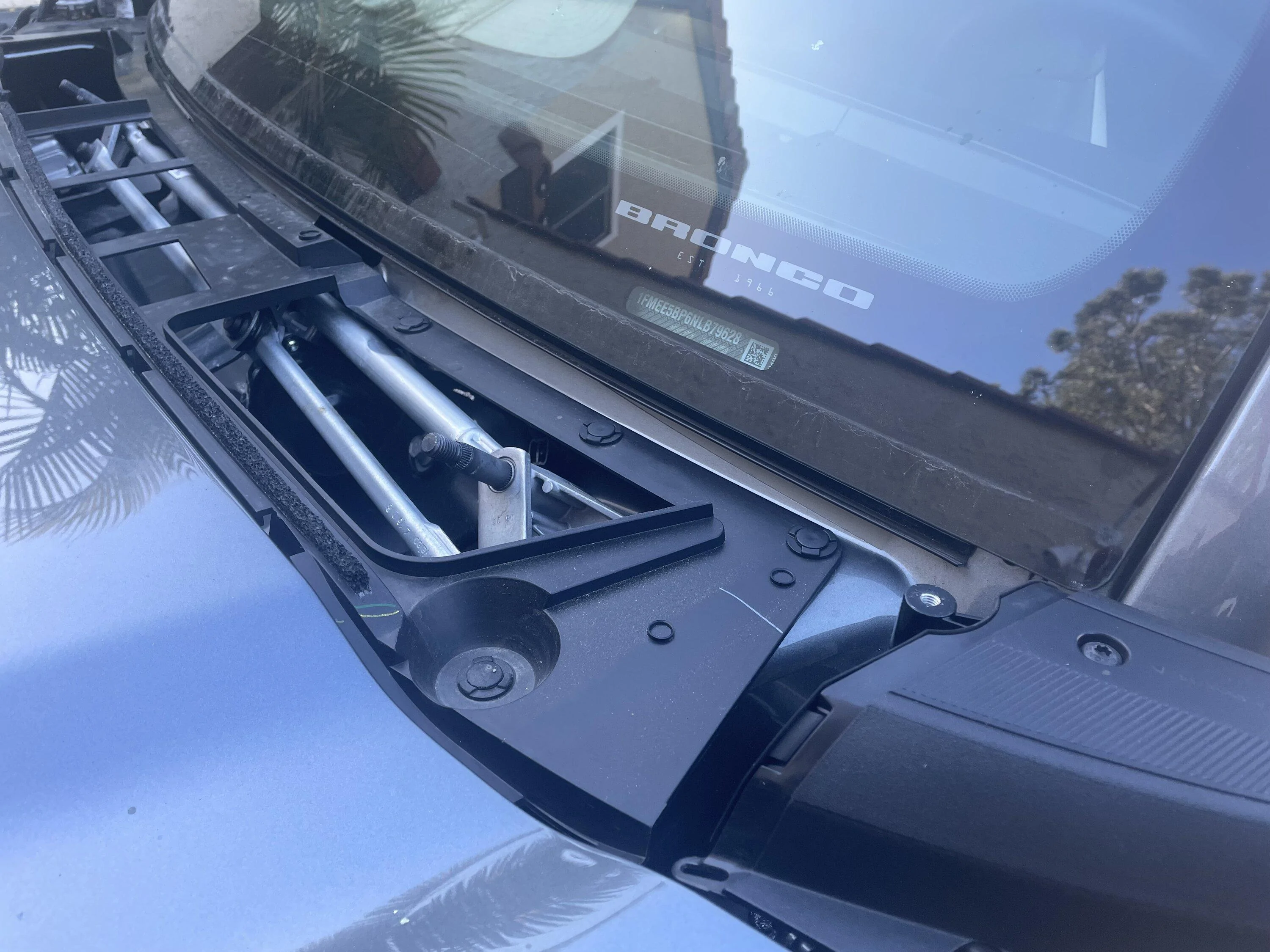

5) Lift the cowl out and your done.
Ford Bronco Removing cowl and windshield wiper arms IMG_1655

So it looks like you just have to sort of muscle it off the stud?
Bellime
Bellime
Keith
Nov 12, 2022
50
512
407
2022 Ford Bronco
Well, used the crescent wrench as a backing and tapped the stub back. Really no muscle required
