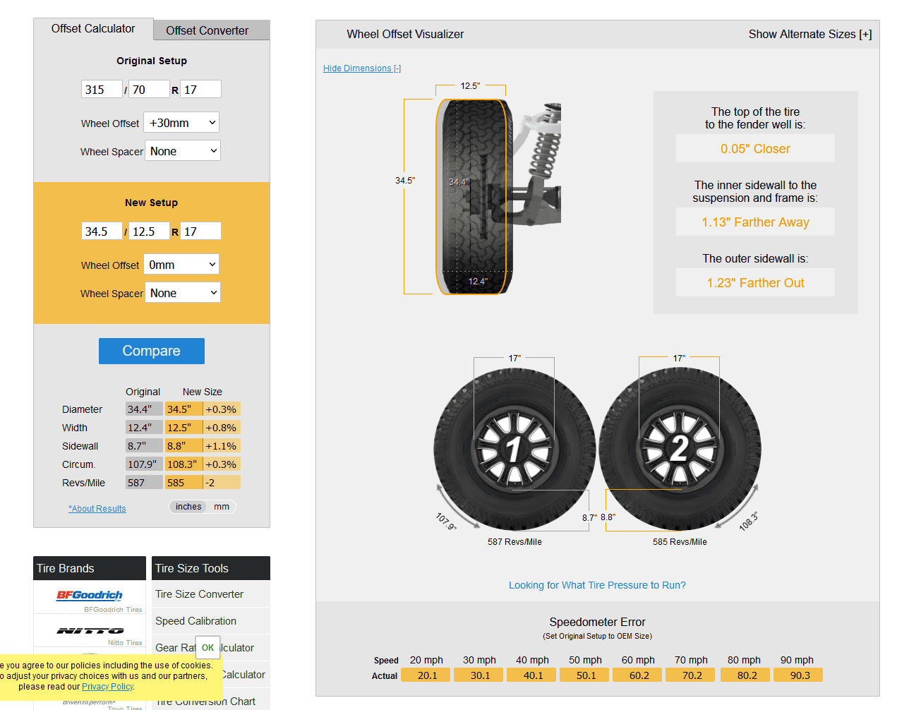

Here's a little more accurate(35 KOs are closer to 34.5 than 35) comparison with the 0 offset

At zero offset?
If you go wider overall tire a zero offset will give you more clearance on the inside bits...but a taller or wider tire with different offset than OEM will change handling characteristics.Tons of folks run even 37s with (IMHO) waaaay too much negative offset (think bro Jeeps) and will swear up and down that they have never had any issues (until they do). From a mechanic standpoint I'd recommend anyone that does not intend to change any suspension or steering components to compensate for a change in scrub to try to stick with as close to OEM as possible. I realize bigger tires look cooler and can provide more ground clearance, but when even one change is made it does make a difference overall. Even with a stock tire on a zero offset, that moves the OEM intended scrub almost 1.2 inches outward...which changes steering feel. Most people who go bigger or with more offset probably won't notice (or won't care or will vigorously defend their choice), but going bigger should be done so only if the owner is aware of the potential issues and if he or she is ok with the possible outcome. I can say that in the garage there are FAR more customers whose issues stem directly from lifting their cars and adding larger tires/offset than their are customers who leave things stock. Some of the best alignment machines can't even get some of the crazier builds close to ideal angles for streetabiiity. But the short answer to your question is you probably won't even notice a slightly larger tire in a zero offset unless you really try.

That is a super helpful calculator for an overall idea of where the new tire will live. The tougher calculation is scrub axis.

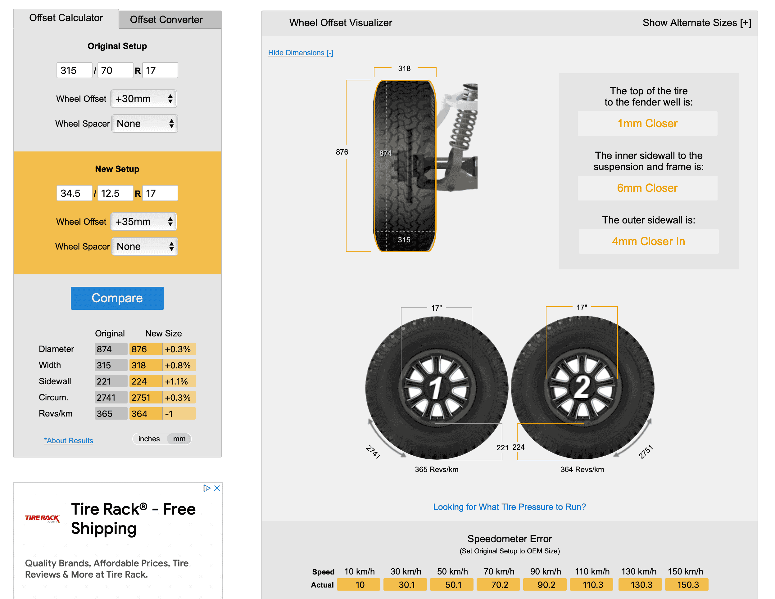

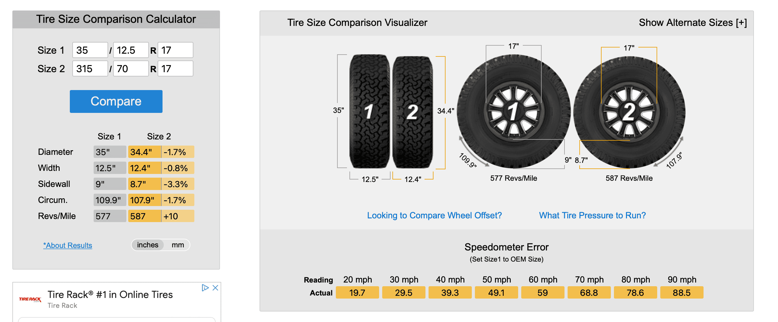

I think 35/12.5/17 with +35 is pretty much close to a stock SQ GY tire. No? Especially if KO2 is 34.5 and not 35?
The bigger question is where does whatever tire you go with live in relation to your steering components...specifically, where did it move the scrub radius to (IF you go with zero offset). Are you going with zero?
