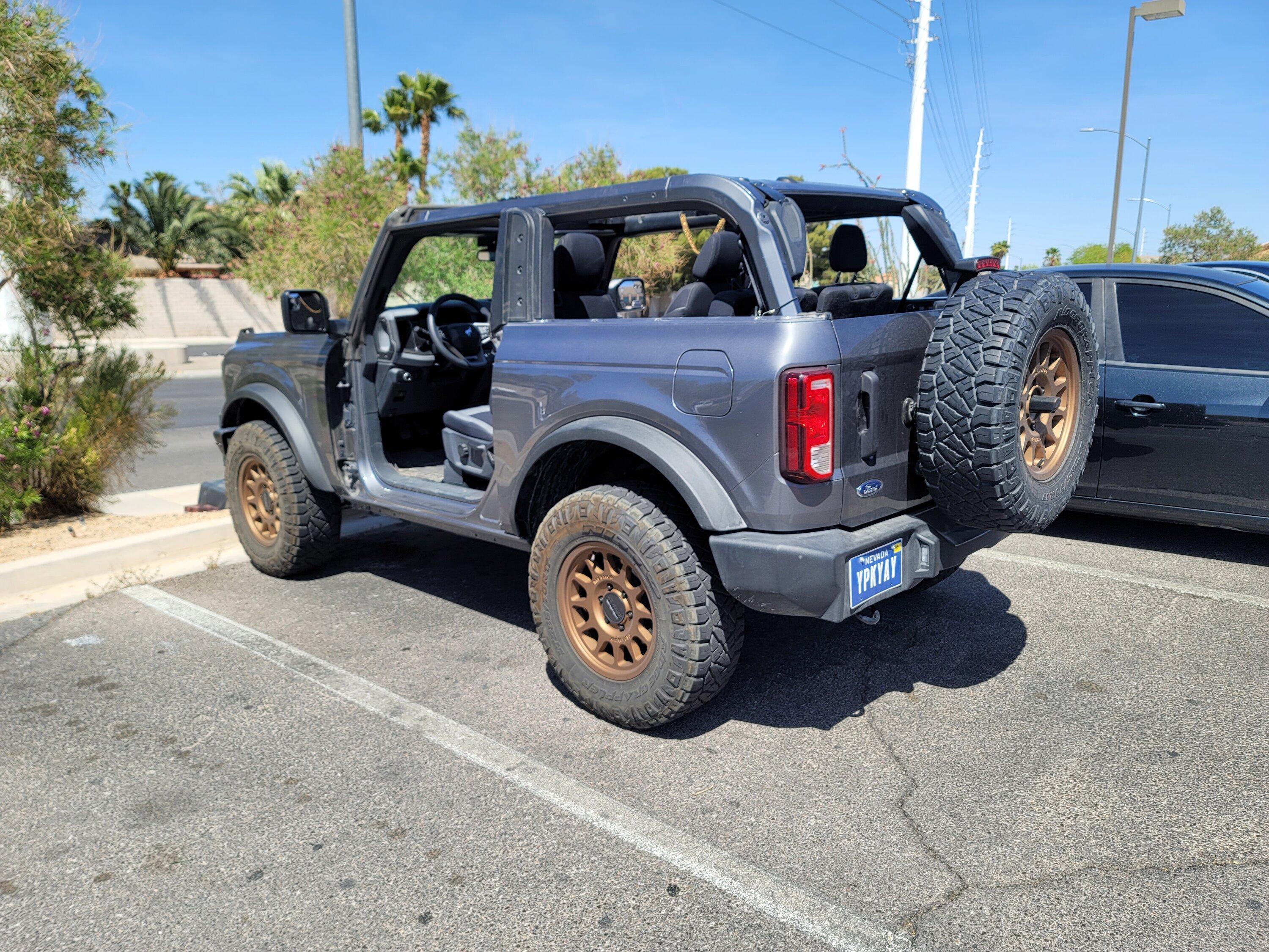

I am a noob in wheels, but I want to replace standard sasquatch wheels with Method 703. The site has two offsets: 0/4.75" and 35/6.2" What to choose?
The OEM squatches are +30 (not 0) for a reason(s).
Get the +35 and spare yourself the track (trail) width limitations and increased off-axis wheel bearing loading

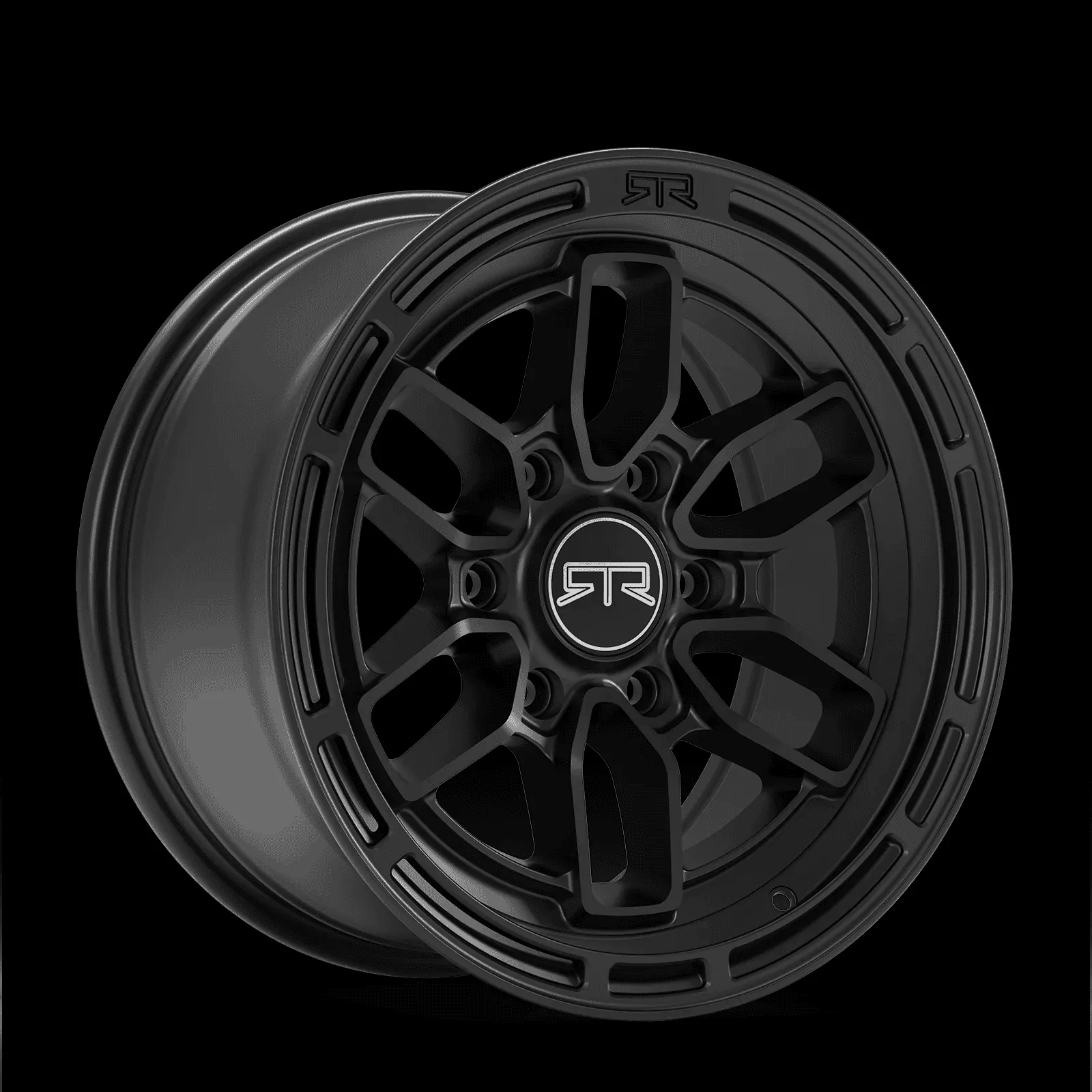

RTR jusr released a new wheel >> https://www.rtrvehicles.com/product...81574&pr_ref_pid=6839217193126&pr_seq=uniform
- EVO6
- 17x9
- 0 or 30MM offset
- hub-centric >> Other than the OEM wheel, this is the only wheel I know made for the Bronco that is hub-centric
Those are really nice...I went with the Methods because they have the "bead grip" technology on both the inners and outers...and the tire place shared that it is a challenge to mount or unmount tires with those rims because the bead grips work so well. I wish Method was hub centric, but even without the hub spacers I had made I had no balance issues.

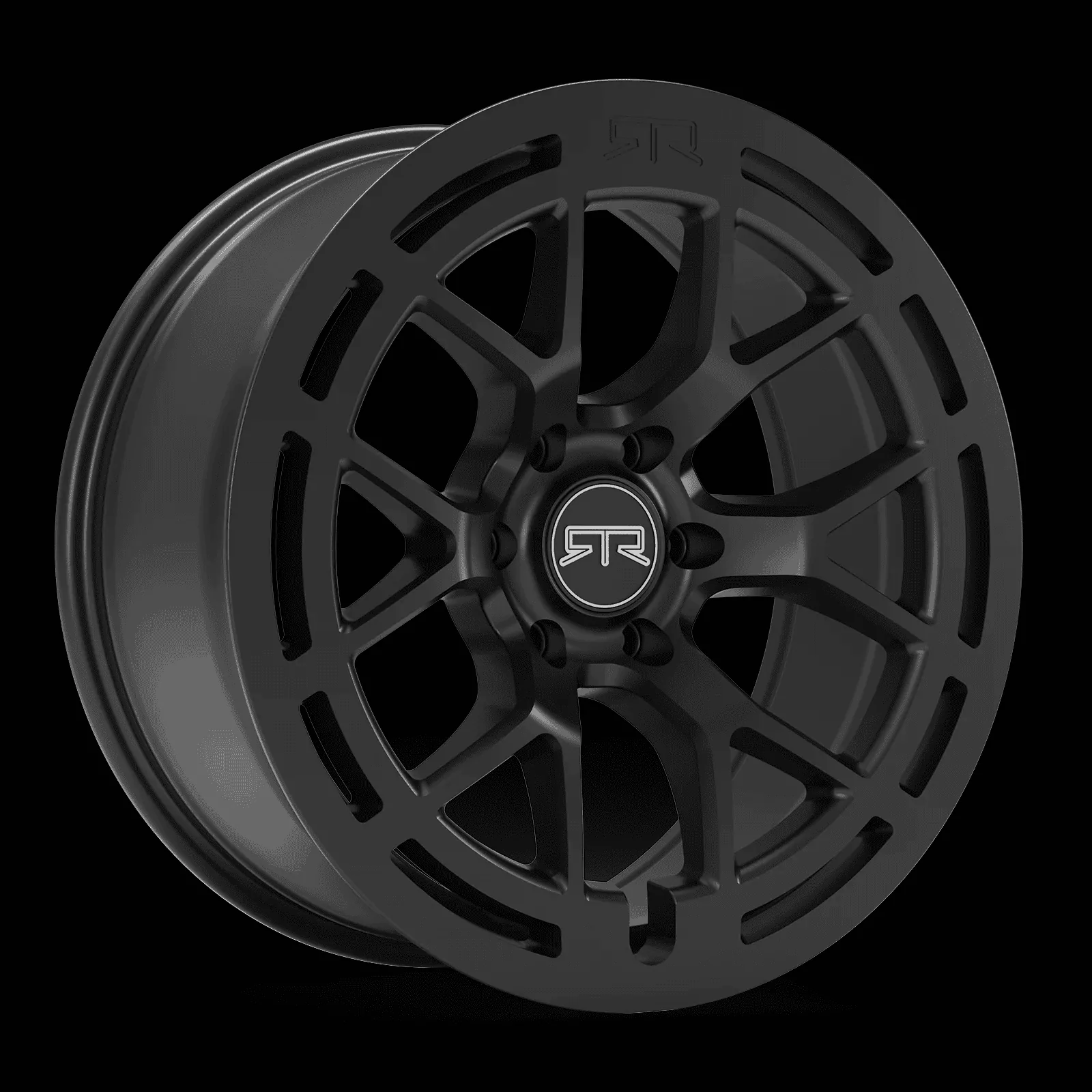

Most guys who offroad hard want a little poke .. this is the only reason why they recommend it.
Though a 9 inch wheel means you have .25" inches on either side (inner and outer). So I wonder if .25" inner (30mm offset) would hit the inner suspension?
below is their other wheel which comes in 25+ offset (hubcentric and 17x9).. which I think is perfect
Ford Bronco Replace Sasquatch with Method 703 Offset question. 1658772679089
I am lost. Why +0? Because 9 and 8.5?
  • We recommend +30 offset for Non-Sasquatch equipped Broncos and +0 for Sasquatch equipped Broncos
