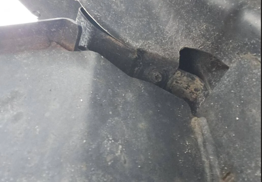

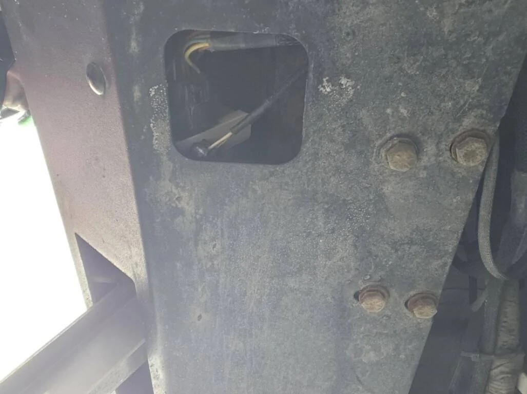

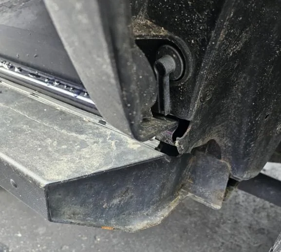

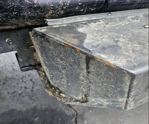

So I got mine on Feb 14th, 2022. I've been EXTREMELY happy with mine (I'm a big dude at almost 400lbs) and they worked almost flawlessly up until this week. This last week, the driver's side went down, stayed down and wouldn't come back up. I tried troubleshooting them by resetting them (pulling the fuse) but they would not go back up; passenger side works with no problems.
Coincidentally, I then had an issue that my battery was completely drained. I jump started the Bronco and I was back on the road. I already had an appointment for maintenance at the dealer and they said they would do me the favor and quickly check out the steps. They called back that the steps are completely rusted out. The corrosion is on the steps, wiring, and motor.
I called RSE and they would not help as the warranty is only for ONE YEAR. I have not really done anything crazy with my Bronco, sure I go offroad with it, but I have never taken it to the beach, nor have I bottomed out with it. So, the only solution that RSE gave me was to buy a whole new set of steps.
Just want to share that here in case it helps someone make a decision.
[UPDATE] - Just got called by someone at RSE that asked me to send them some pictures and they would re-evaluate whether they can do something. I will post up the pictures here as well and what their decision is. Fingers crossed.
[UPDATE 2] - Well I got my Bronco back from Ford and I sent pictures to RSE to show how rust is already appearing on the bolts as well as the frame of the steps. Not sure if I am dealing with a different person, but the first answer I got from them was " Did you see the above email? We had an order ready to go just waiting for payment. "
To which I reminded them that they were going to speak to someone in leadership about an out of warranty exception.
Their reply was: " We can offer you touch up paint to help with that but where these are 3 years old they are outside of our general warranty. "
I am including the pictures here for everyone. I have never taken my Bronco to the beach, nor salt water and the closest thing has been the salt/brine from NJ roads when they salt for winter.
