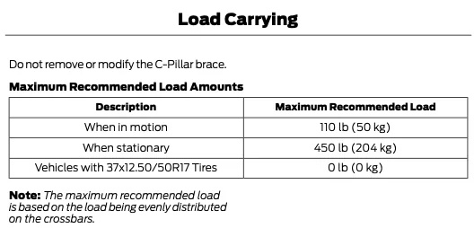

I have a ARB RTT I think it weighs 180lb can I use a OEM rack or do I need an aftermarket rack if so any suggestions? Thanks

Is the weight recommendations for the rack or the top itself ? Found a aftermarket rack that says it holds more but if the top is not want hold it it’s useless.
