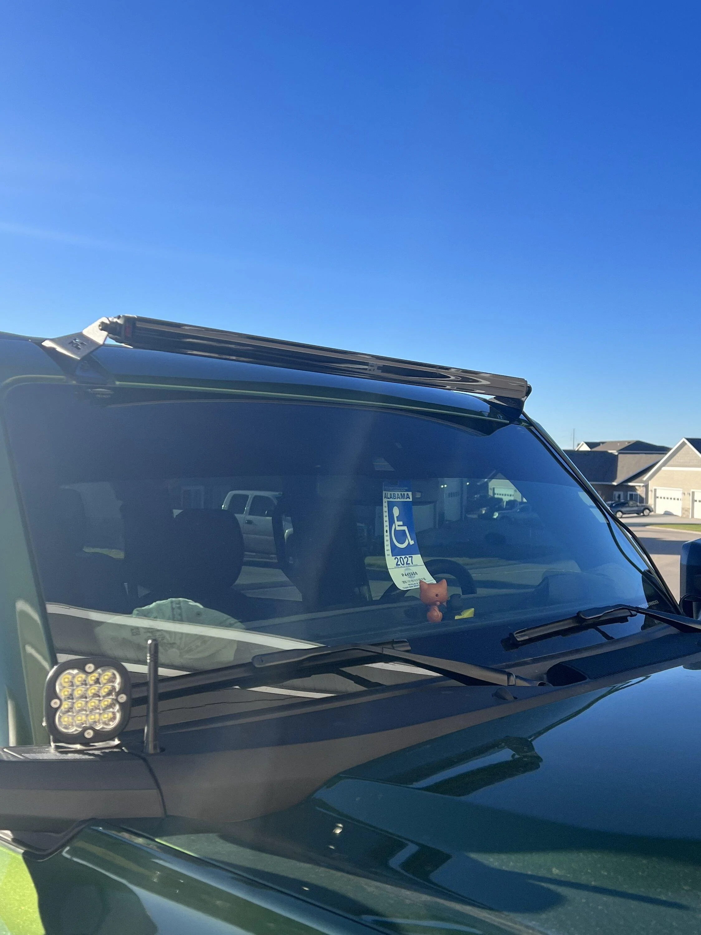

Maybe someone can help me. I have a Rough Country 40inch LED light bar I bought. I want it to run off of the aux 2 switch. The RC says it is 210watts is it safe to run it off of the Aux 2 switch which is a 15amp?
Ford Bronco Rough Country 40inch LED Bar???? IMG_7964
