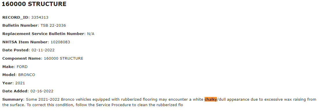

I have always thought the look of my rubberized floor could be better as it appeared chalky. I came across a TSB (TSB 22-2036) indicating it is from excessive wax raising to the surface, and to follow the service procedure for cleaning. Does anyone have access or can provide the details? Not sure I want to take it in for something that might be fairly simple.

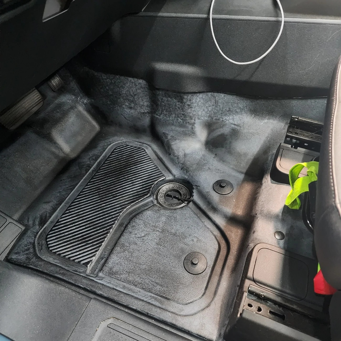

I just recently noticed this with my bronco once the weather went from cold to warm. Now it's pretty much white lol I hope to find a solution on how to get rid of white look

This is all it says
Ford Bronco Rubberized Flooring White/Chalky 1650163000772

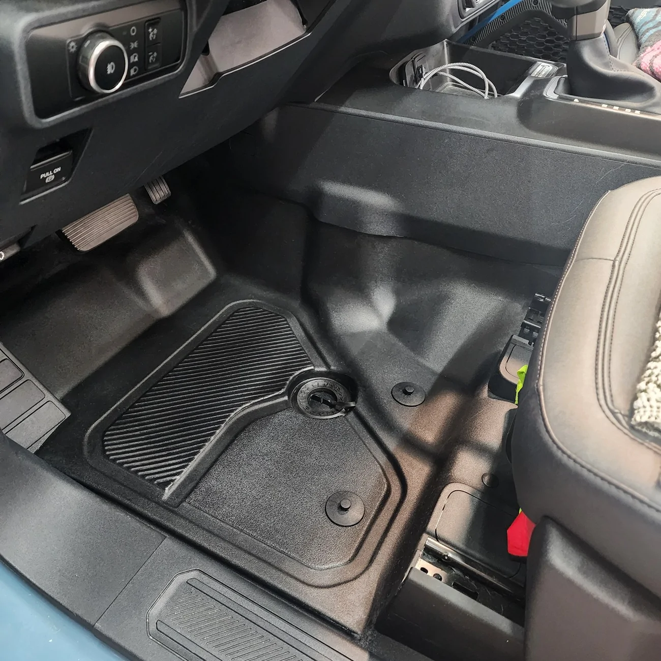

PTS was down for me over the weekend, but I had a good laugh this morning when I remembered to check this TSB again. How LA’s Totally Awesome Cleaner became the cleaner of choice, I have no clue. It does seem to have good user reviews though. 🤔
redone17
Mar 6, 2021
61
3,877
4,385
Cold Spring, NY
2021 Bronco, 2020 Ranger
It works really well on the fender flares as well!

Just grabbed the cleaner at Dollar General that the TSB calls for. Doing it myself.
