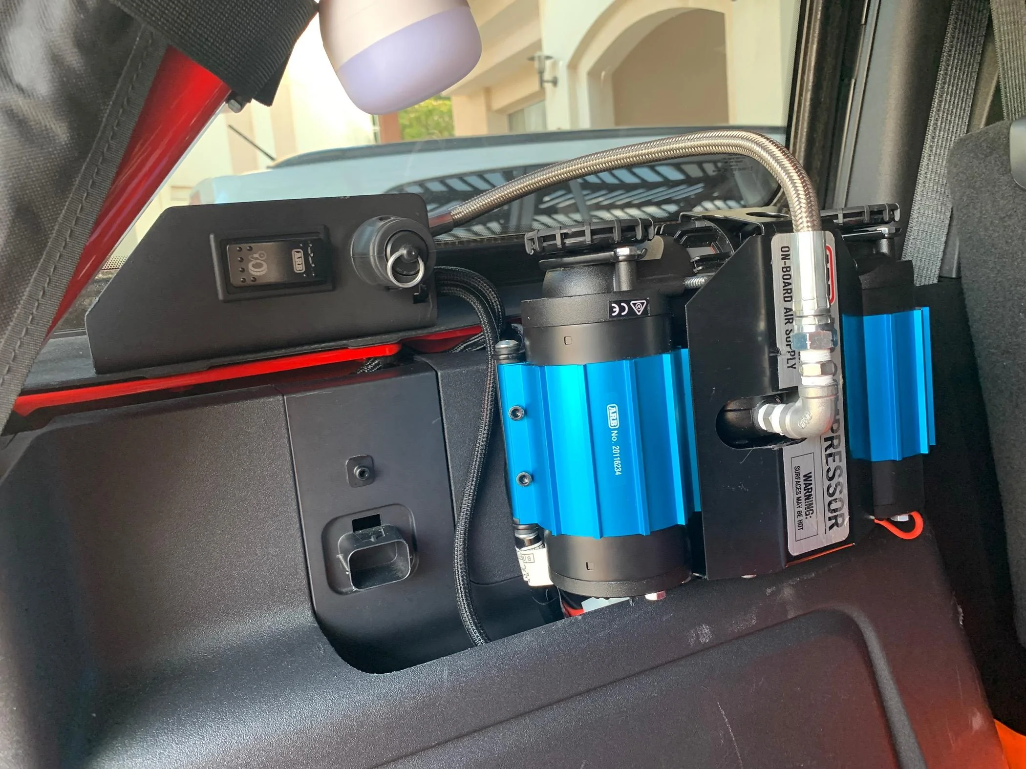

Do you carry a compressor to re-inflate that doesn't take 20 minutes a tire? Thanks for all the information!!!...Amos
I used to carry an ARB single cylinder compressor. Since I got the Bronco I upgraded to an ABR double cylinder and it halves the time it takes to re-inflate. To inflate from 15 to 39 psi I think it takes about 15 minutes in total.
Nice color Bronco BTW :cool:
My onboard compressor. Yes it’s loud in the cabin but no worries about dust if behind the spare tire or in the engine bay:
What plate did you use to mount that? and the switch section as well. Nice and clean!
American Adventure Labs mount. Custom switch plate by my local buddy’s fab shop.
