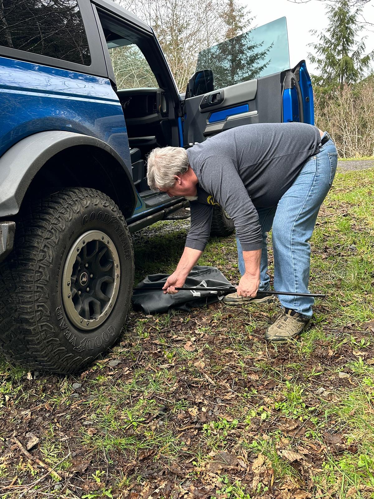

our guide at OR suggested on trails running 20-25, and I asked about sand and he recommended 15-20. That being said; last weekend we went out and on fire road gravel and lots of potholes I was lazy and decided not to air down. Started jumping on it, going 25-35 and paid the price. had a rock puncture my right rear. I will not make that mistake again.
Ford Bronco "Safe" tire pressure.... IMG_5790
