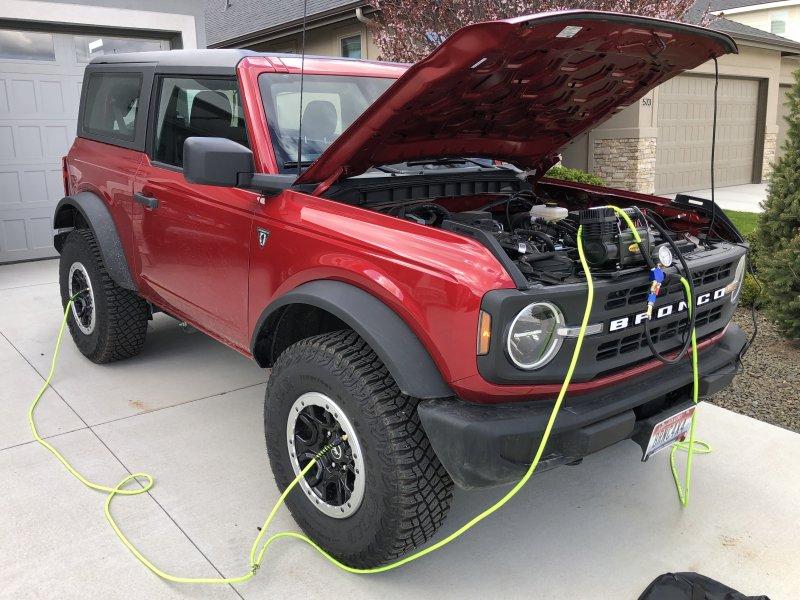

It's not going to make a big difference. I try to run 39 all year for highway use and drop to about 20 off road. I can air down in three minutes, but it's a good ten minutes to air back up with my SmittyBilt pump and 4-way valve contraption.
