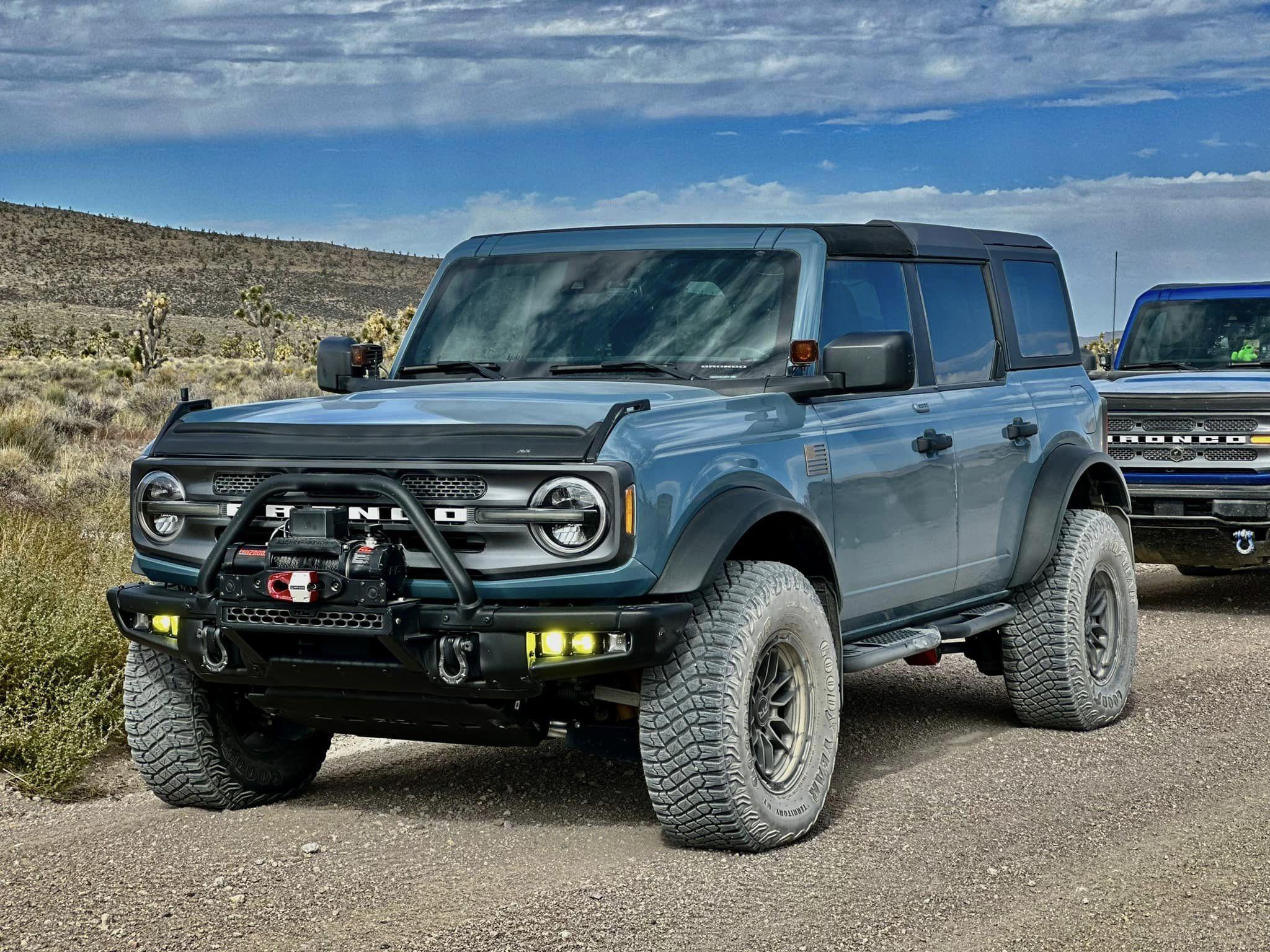

I was going to do a POLL but figured it really is only one question - and I wanted to see and read different answers to better understand.
I have a Bronco (2022) and 35in tires (stock ones) and Sasquatch Package. I typically run 12 psi All the time when off-roading.
Recently, I have gotten to really like going fast on trails - Its super nice and challenging. These are rocky trails, not with big boulders of course, but they also have patches of smooth fire-like road and a mix of small to medium sized rocks.....with lots of turns :) I would say my speed varies anywhere from 25mph to 40mph on the rocky, not-so-smooth stuff and sometimes up to 65mph on flatter sections. I'm not a Trophy-Truck (or a Raptor) so I try to stay within limits.
Having said that - is 12 psi safe? I just realized that since i'm not traveling in a straight line and there are tons of undulations and turns, shouldn't my psi be higher to safeguard the lateral loads on my sidewalls while turning? I'm thinking at the very least 15-18 psi.
Thoughts? I'd love to hear them.....and please, feel free to get super nerdy and technical!!!! :)

I run 18psi...
And off topic, what lift you have on your bronco, stance looks nice with the stock tires and RTR wheels!

I run 18psi...
Thanks man!!!! :) So WAS going to go the KING route.....expensive. I figured why not try out an Eibach Pro Spring Lift Kit? (Springs Only, no shocks). Worst case....I re-sell them if they suck. I cannot say enough good things about them. I should have a full review of them here somewhere....tired finding it but can't. So odd. But yes, the stance is GREAT and also the ride quality VERY MUCH improved - both on and off-road. It's a 2 inch lift. I did want a winch, so I researched the LIGHTEST combo possible for the Winch and Winch Mount - Rough Country won in both cases. Plus the "approach angle" is the best of any winch plate. The TOTAL weight came out to 84 lbs. So my front lost ONLY about 1/2 inch-ish. Kinda works out so when I accelerate it reverts to "level", rather than poking up the bumper ;)
