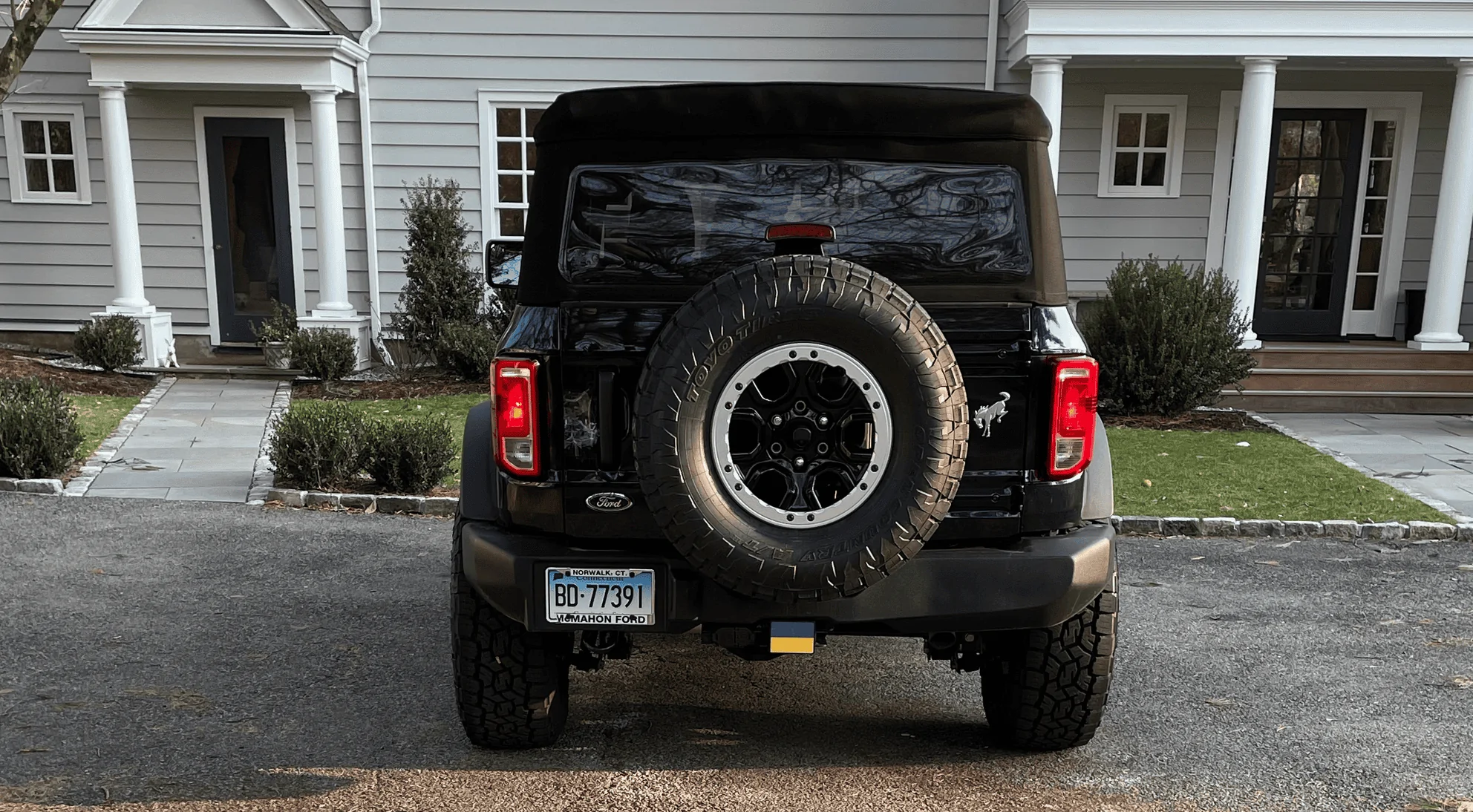

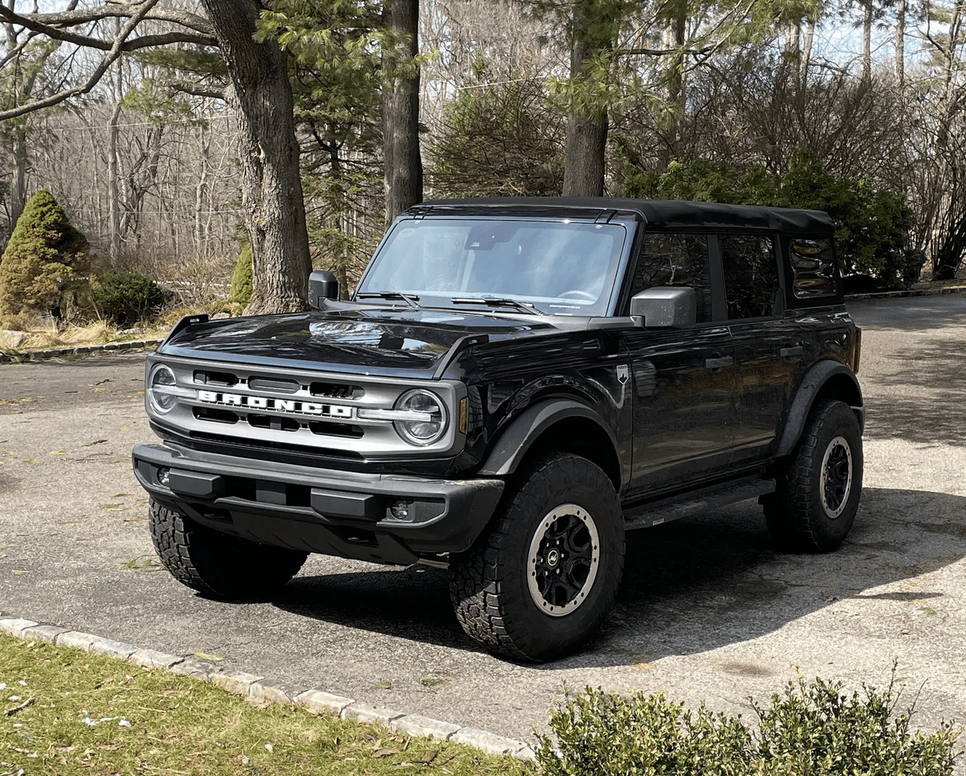

What if i dont want to remove the crash bar? how could i avoid that and still put 315/70/17 on them?
I put used Sasquatch rims and 35" Toyo A/T III's on my Big Bend along with a Zone 2" lift and a Rough Country tail light extender. There was some rubbing at full articulation, but my mechanic said Connecticut doesn't allow him to remove the crash bars. I found some 4 Wheel Parts tapered crash bars and we installed them. No rubbing.
