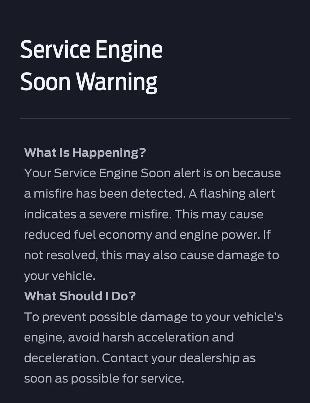

I last used the Bronco about 12 hours ago. No issues, warnings, idiot lights, etc. I just received this in the FordPass app:
Ford Bronco Severe engine misfire reported IMG_3433
Very odd, since everything was normal when using the vehicle last. Your thoughts?

On the outside chance... On the Ford app, twice some other vehicle has been set as my Bronco. For a while it was a Bronco Sport, which I've never owned, now it's a 2024 Outer Banks (I have a Badlands). Just sayin'...
First, hat tip to @Ducati1098 for checking my VIN and verifying no issue(s) recorded on the Bronco.
As noted in the above quote, I went back into FordPass, and after some digging found my '18 F150 Raptor still listed as mine - even though it was sold in '21 and haven't used FordPass until getting my Bronco in '23. Once the F150 was selected, I can see the misfire, and all other warnings, that are being mailed to me. Will be deleting the F150 (again). Thanks for the help/thoughts/guidance!
