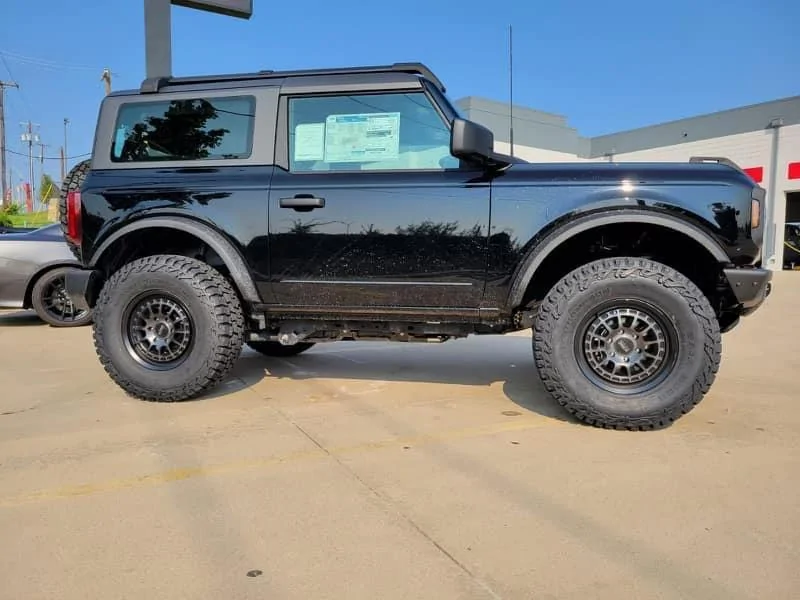

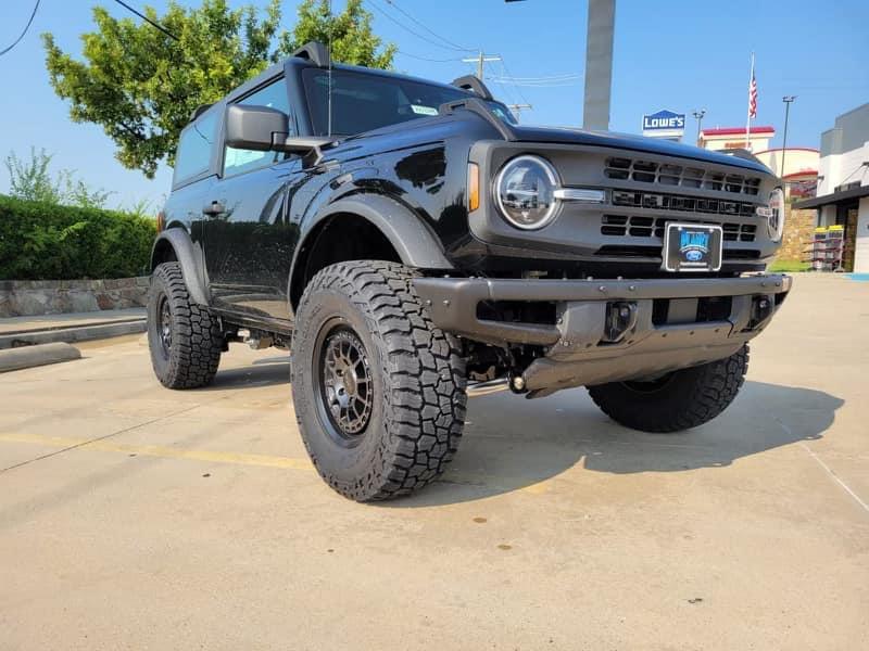

Ford Bronco Show us your installed wheel / tire upgrades here! (Pics) 44A6BCD7-B207-4936-B927-A1BD181E894D
Ford Bronco Show us your installed wheel / tire upgrades here! (Pics) 19371DBB-2CC6-4682-B9D0-F50F49C7A233
can somebody explain to me in how they base fit the 35’s? Is there rubbing? Can they off-road/how is articulation? Crash bar delete? I love the look and if I get some explanation I plan on doing this to my base.

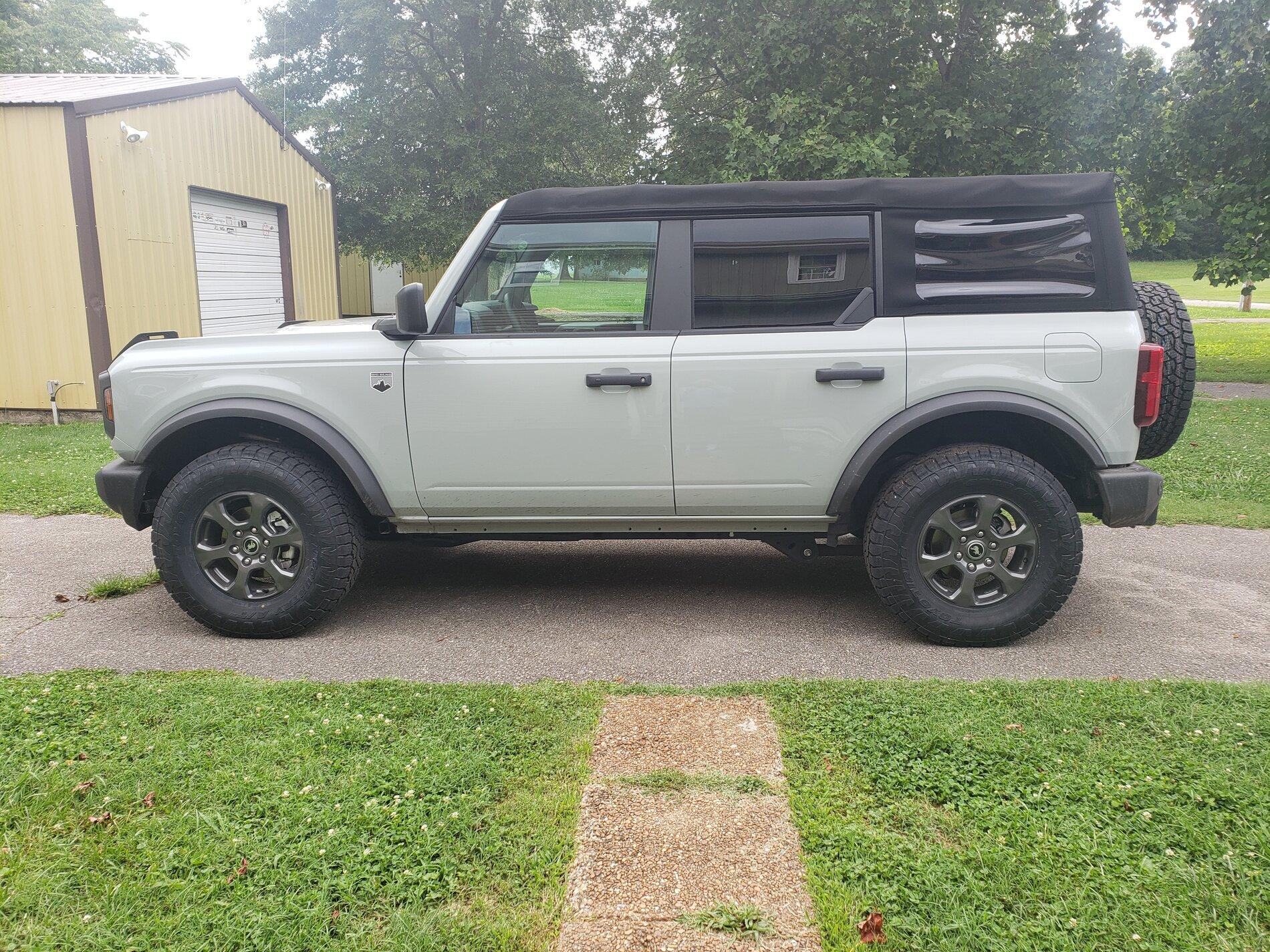

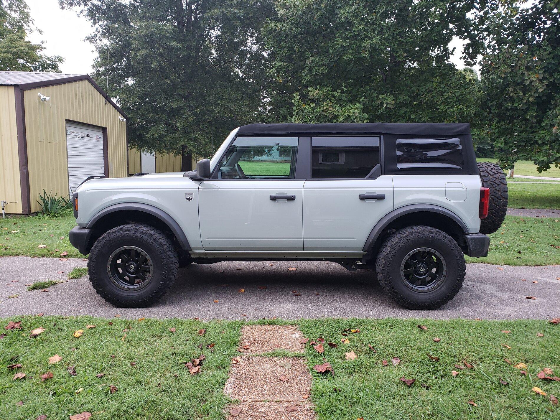

I actually had the opportunity to throw on some used 35's to test the ride and look. Excuse the beadlock scrapes...I'm getting the rings powdercoated next week.
With lift and tires, it went from 37 front/38 rear to I believe 41" all around if memory serves.
Before:
Ford Bronco Show us your installed wheel / tire upgrades here! (Pics) 20210713_154539
After:
Ford Bronco Show us your installed wheel / tire upgrades here! (Pics) 20210820_065950

What are they?

Goodyear Fierce MT's. 35/12.50/17s. Not necessarily what I would have chosen to buy new, but got a great deal on them from a friend. Figured I could run them until Spring and see what I wanted to do.
The wheels are older style Fuels. Not sure about the offset...maybe 0? No rubbing and good clearance all around. Going to try them offroad when I get a free Saturday.

Your rig looks great!
Looks like the Fuel Trophy which in the 6-139.7 bolt pattern comes in 17x8.5 with either -6mm offset or +6mm offset. My guess is you have the +6 but if you ever want to confirm, the offset would be stamped on the backside of the wheel next to the letters "ET".

Hey thanks! I will assume you know what you're talking about lol. I looked on the inside, but didn't know where to look. I may remove the spare and see.
+6 makes me feel a bit better about things. Some had discouraged 0 offset. But as a practicing cheapskate, it's hard to pass on great deals that fall in your lap.
