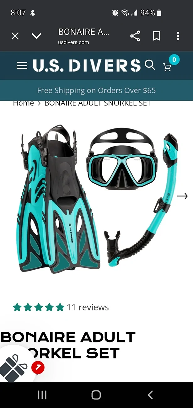

I think this might be a better solution for you.

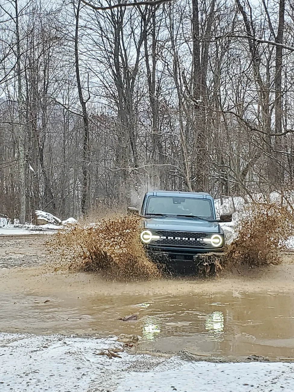

Sorry not sold. If you like the look do it. I wheel in dusty muddy environments. We get both! Often at the same time. Check your filter regularly and if you need the air intake higher they make larger tires for a reason.in the mean time, you can get color matched snorkels.

A filter before a filter of course helps. I guess I am just basing it off of my 38 years of off roading and seeing some of these real worlds in SE TN. Mostly they catch trees around here. most of what I have seen use a non-factory filter. I have seen no empirical data from any manufacture in a scientifically controlled test to prove any of what you are suggesting. That being said, if it uses a better bigger filter, there is your benefit, not the roof tube. I have seen Unimog's in Dakar with these, but I have seen no baja racers running them. As for water, I guess overspray from high-speed water might be helped as the stock box faces forward on the opening. If, however, you are fording deeper water, you have some important electronics and a lot of vent tubes getting swamped way before you hit the stock box opening. For me on the bronco application it is a gimmick and a money waste. However, as I stated before, if you like it do it. I just would need some actual data, not the sales pitch.
